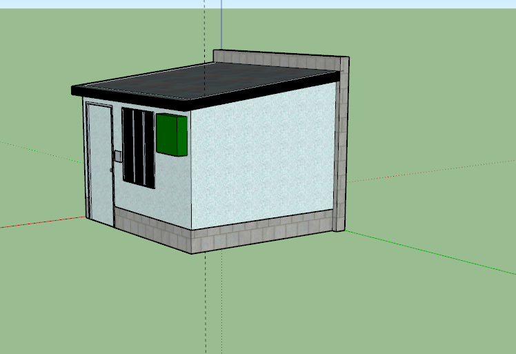

Hi I am needing to build an 8ft high concrete block wall where a pent shed will be built from using a wooden frame and foam panels for light weight while the concrete wall is to stop damages encase of accidents while the light weight section will give. I am wanting to use standard concrete blocks. My footings are 1m deep as its clay soil to pure clay then hardened clay by 450mm wide with 12" concrete footing. The wall needs to go around 8ft tall but I know that will not work with a single skin. So I am wondering is it best to place the concrete blocks on their side so they are lay flat and will this stand fine at a single skin to 8ft tall? Or would it be best to do two skins side by side with block, no cavity, and tie these in periodically with wall ties or another idea is to do to blocks standard way up so 200mm thick then lay one flat on top then another flat then two standard until up to 8ft tall and would this hold fine? or would simply doing columns at either end on one side of the wall with the rest single skin hold fine? Building is 10x8.5ft in size. The interior will have a small wall coming away from the end to around 3 foot in and walled off again to the sides to create two small rooms which will store compressed gas and again will be a single skin wall with wood frame and plastered then tiled with an open roof to the wooden roof section.
The shed will connect by the wooden frame to this and the bottom will have 3 coarse of block , before the wood starts, to lift it away from the ground with these tying into the shielding wall at the rear. The roof will slope away from the rear wall down to the front.

Two skins or one block flat will be the same for strength. Whether a single skin will do will need someone to calculate. A single skin with piers will certainly be OK for a shed wall.

In terms of stability at 8ft tall would laying blocks flat be safer than upright or dual upright blocks then two flats then upright and so on? or just upright with a column either end and one in middle on backend of wall?
Garages are built of single block skin. You would design additional wall support via roof bracing.
Attached image of shed design, My main worry is because this has no side walls in block like say a garage does it will be weaker even with wood framing attached due to its weight in stability. Going off the design the first 3 courses above dpc will be block then the rest is wood frame with light weight padded paneling. The block wall at the rear is 8ft tall and in that image single skinned only.

Any four-sided structure with a roof is inherently strong due to the shared bracing and support, and it does not matter is made of timber or wood.
What you are trying to do and being fixated on is trying to design something that deals with a potential blast in a known and controlled way and to do that it must be designed by someone who is qualified to do that. If you don't know how the pressure from a blast radiates then you don't know how an ad-hoc shed is going to perform.
Just by looking at it, it would seem to me that any blast may wall blow the window, roof corners of the timber panels and whether that then topples the wall, who knows. And all this may well occur in micro-seconds all at once.
If this is a business location, in any incident the issue would be what have you done to provide a a safe storage shed and what risk assessment have you done. And "suitable" design may well be paramount, and suitability would need to be determined by an expert. And if you are doing this as a job, then you must be qualified to do it, otherwise it's basic negligence.

The gas being stored is not lpg but a by product gas from a production and is more vapor in effect but when confined turns more gaseous. So the vapor is not explosive but when compressed it can act that way but rarely. Our old building used a 8ft tall dual skinned brick wall with coarse interlocking between each other every so often. The rest was shed and board. We only need the direction of a blast to go mainly in one direction outside of this is also a steel caged wall at a defined separation distance. We have all the safety assessments for the building and defined distances and heights and the block wall is classed as adequate enough for the small amount stored and building size given the expansion ratio before it even catches the walls. Like I say its more precautionary and wont burn up like say lpg does, methane or other forms of gas. More main worry was the stability of a block wall staying upright in general as building regulations seem to state not to do a single skin above 6ft I believe if unsupported and the brick far outweighs the wood beams. Its that time frame where it is stud up before the wood sections are built. This is why I was thinking dual skin or lay belly flat.

That we have already and they give the guidelines and safety measures to put in place and we need the concrete block or concrete poured wall but preferably block as it would work out better. So the design we have gone with suits these requirements that we have to follow including separation distances. My only concern like I say is the height of a concrete block wall would it be stable enough in just normal use standing going off of the ideas in my original post. Obviously with say a garage the side walls are tied into the long walls so its a cube and that gives the strength. In my case we dont have this. There will be a short gap to wall being erected before wooden frames are put in place. As for thickness anything from 100mm to 400mm is fine for us to use as its a precaution measure rather than say a full on shield like in military or pyro applications and the block wall will be quicker to erect than a dual skinned brick wall for us.
