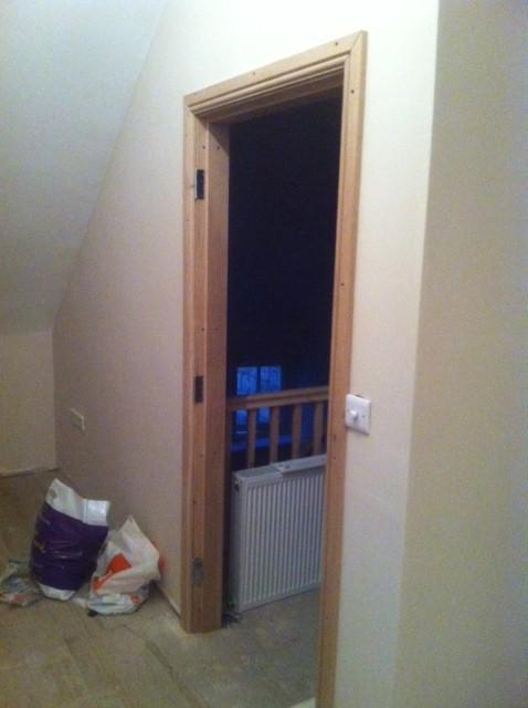

Now I've got my shank issue sorted can any of you guys give me some hints please? I'm looking to rebate a length of oak to make a door casing. The door's 35mm thick so I've worked out I need to put a 35mm wide, 15mm deep rebate in the wood for the casing. I've had a practise run & while not too bad I had real issues working out how to cut the rebate in the ends of the horizontal part of the casing (where the sides of the casing will slot in). Is it bad practise to rebate across the grain or would you use a saw?
One more thing.....when using the router on the wood, I've got the wood clamped down but that means I have to stop half way along the wood, move the clamps, then do the other half. Whenever I do that though I seem to get marks on the wood where the bit has taken a mm or 2 too much out. Is there any way of starting/stopping half way & keeping a clean cut or is that just practice?

how much will that leave to fix the screws in, after youv'e rebated and sunk the hinges in ? whats wrong with an applied stop?
Personally I wouldn't bother. Getting consistent quality on such a large rebate (for a small router) is a real hassle. I'd go for HWWs suggeston of planted stops which are much easier and faster to install than rebates, not to mention being more forgiving if the need arisews to rehang old/existing doors where it may be necessary to bend the casing around a (warped) door to get a good fit. That can't be done anywhere near as easily with a rebated casing
Thanks for the advice fellas, had a bash at the rebate (started before I saw the last couple of posts). Turned out pretty well but like you said, very time consuming - will definitely go with your advice and try a stopper on the next frame (9 more to do as and when I can afford the timber!). I'll try and attach a photo to show you how I got on.....
