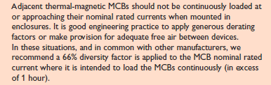

True - but, mind you, there are other sort-of-related things that the manufacturers do currently 'stipulate' which I strongly suspect most people ignore (even if they are aware of them). For example (as we have discussed in the past, Wylex say of their MCBs ..
Kind Regards, John
Bet they only put the adjacent MCB notice in after their “MCBs frying tonight” episode!
I think that statement, or a similar one, has actually been in their technical documentation for decades. The extract I posted came from a 2007 document, which is the oldest I can currently find.
Kind Regards, John
