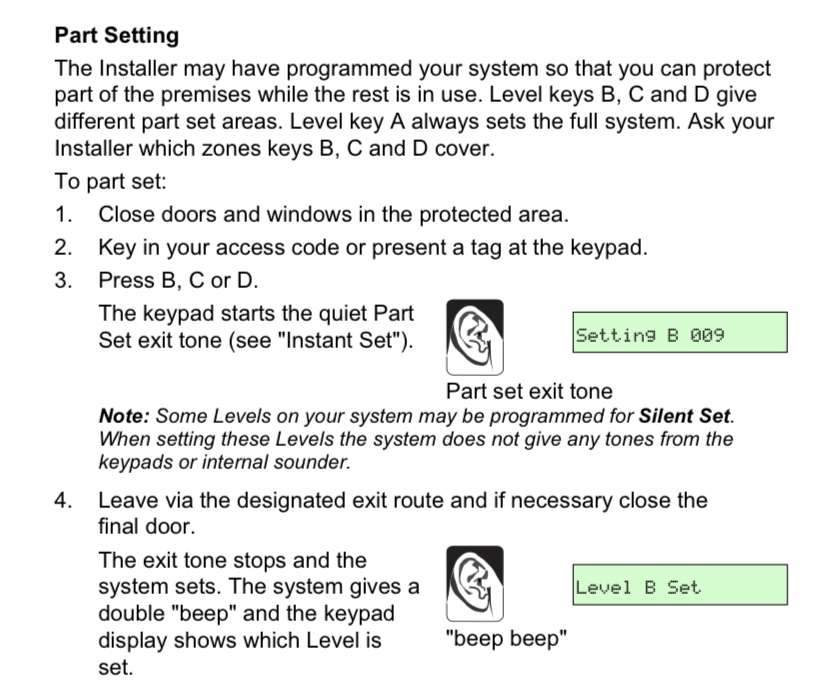

I have a 9651 alarm control panel. The zones are programmed as follows:
1 external DC FE abcd1
2 lounge NA and
3 hall NA a
4 dining NA abcd
5 study NA abcd
6 kitchen NA a
7 garage NA abcd
8 landing NA a
I want to know how to do a part set at night so that landing, hall, kitchen are not activated. I put in code or present tag and then what? Help appreciated, I'm missing something really easy!
Eg ....program landing A-CD
When you set at night eg B ....code and B ....it won’t activate B landing as it’s not in B setting
