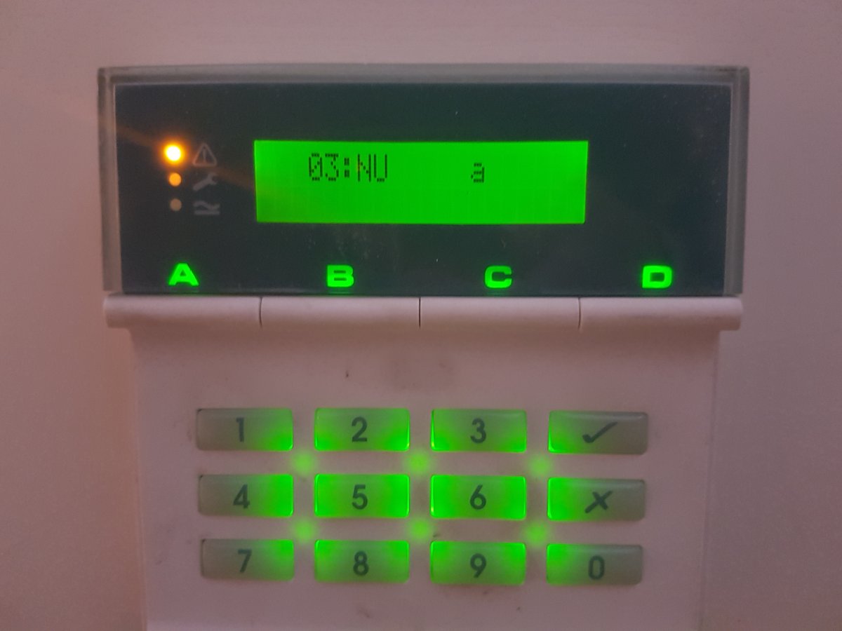

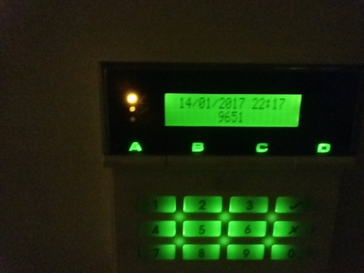

Hi, looking for some expert advice please as tearing my hair out... My Scantronic 9651 alarm will not arm because of an error on one of my PIR zones (the alarm went off last week).
The panel shows the yellow triangle light. When I enter the user code and try to arm, I get the red spanner as well as the error code, which says Burg Z03 Alarm Inactive - so issue has cleared, right? I press tick and get sent back to the time/ date.

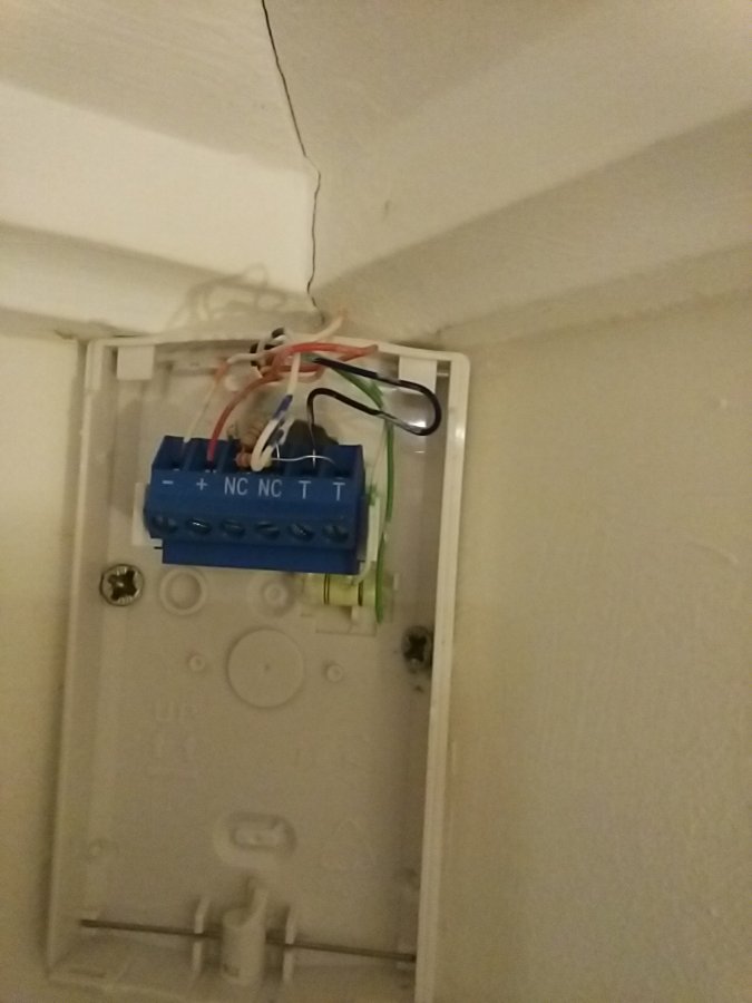

I have tried installer reset (installer code and 99 tick tick) and no difference. Normally if the alarm activated before, this would clear the yellow triangle. I have checked zone circuit resistance (installer 199), I have opened the PIR sensor (Bosch) and all seems ok and consistent with all other PIRs in my house. Walk test (installer 97) is fine for all sensors.
I've pasted some images below. Anyone have any ideas? Could it be battery-related? I haven't changed that for c.5 years now. Never received any battery low messages though.

I have checked sensor wiring is consistent with other sensors, no wires touching etc. The sensor functions properly on walk testing. I have not checked alarm box wiring as difficult to get to.

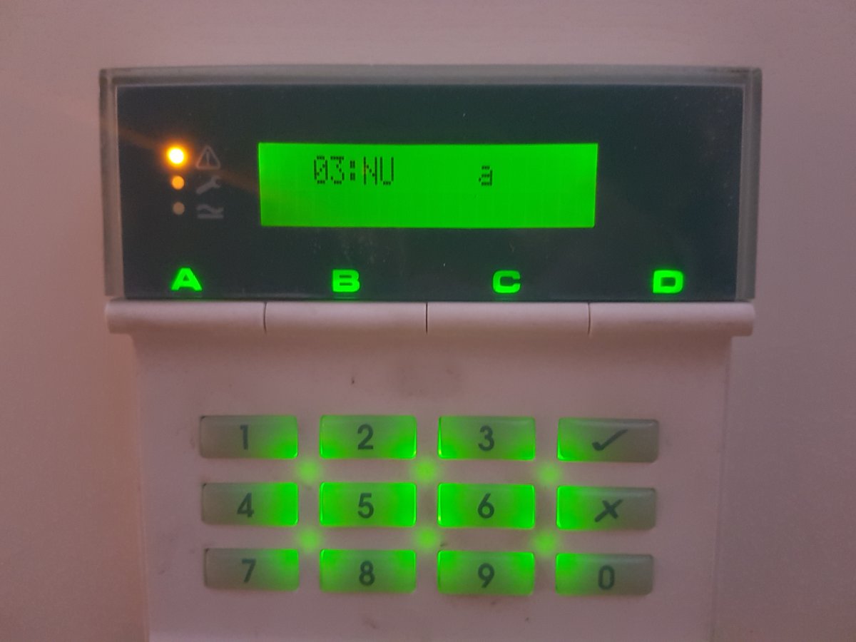

Tried that, so that zone (3) is set as NU. That won't clear the error either. I've also tried omitting the zone as a user (user code,3) and doesn't work either.

What does it say in display ?
Says 1 problem per image below, then after tick, shows the problem (the third image in my first photo, with red spanner illuminated), then after another tick reverts to the idle screen so date and time (the second image in my first post, with just yellow triangle).
When you press tick and it says problem zone 3 then that is the fault ?
You have made that zone not used in programming so that should clear fault
You could down power panel by mains and battery and then turn power bavk on
That will re boot panel but still keep your programming,panel could have had a wobble?.

Thank you, the trusty 'pull the plug out' routine indeed did the trick. When all was back online and tamper lid replaced (including the alarm being armed, neighbours will have enjoyed that), when I entered the user code the same z03 warning came up, this time with a flashing yellow triangle, pressing tick then showed the tamper lid warning (inactive). Pressing tick then removed the yellow triangle and alarm could be armed. All room settings seem to have been saved except date and time and tone preferences etc. Thanks again.
