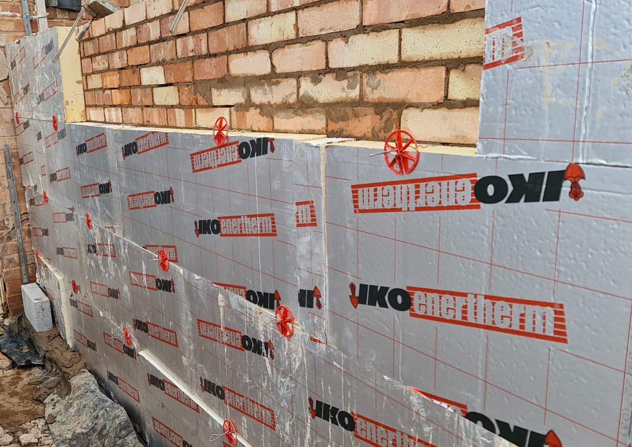

First time post although unfortunately, not a happy one. We are doing a rear one-storey extension.
We've had continuous bad luck with builders who all just seem to be in it for the money. The first builder we had sort of absconded halfway through, got another builder in who rightly pointed out issues that builder #1 made - and quoted a high amount, to me anyway, to rectify - I just wanted all done with so accepted. So they tore down the inner leafs (blockwork) of both sides and the outer leaf of one (external wal)
In all fairness builder #2 was efficient and sent us pictures and kept us updated, but regardless they still rushed in order to get the money in my eyes. The main issue that building regs pointed out is that because we've used Celotex 100m, but builder #2 installed it incorrectly - The insulation has been 'clipped' against the external brickwork wall, rather than the internal blockwork. So this has to be rectified. Note, our cavity is essentially 130mm (long story), 100mm insulation, 30mm air gap (which should've been between insulation & external wall)
I will get onto them in the morning, but the way things have turned out I'm sure they will ignore and wash their hands of it.
Does anyone have an idea of a remedy or is it the inevitable tear down and hope for 3rd time lucky.
Please see progress image sent by builder #2 attached:

Yeah it definitely should have been against the inner leaf, and I don't see how it is going to be fixed other than rebuilding the outer leaf again.

Some insulation you can full fill but normal pir is not one of them. It's supposed to be kept dry. The air gap wouldn't make a big difference, the foil face might be negated only.
There needs to be an air cavity
I also thought this, but maybe because we are using PIR for it to be effective there has to be an air gap?!
no, the air gap behind external skin is nexessary as part of the damp detailing.
what you have is normal PIR, not designed for “full fill” applications.
When using PIR cavity insulation the internal skin has to be built first, your muppet builder didn’t do that - I bet he did it for a reason: no blocks on site or whatever.
There's really no excuse, particularly for the side where both the blockwork and brickwork were taken down - I would have given the benefit of doubt for the side where only the blockwork was taken down.

Something is a bit odd here? How thick is that insulation? it looks (from the photo) quite a bit thicker than normal for a standard partial fill cavity and not only have they fixed the insulation in the wrong place but the residual cavity is way too small. It's like they have built a 100mm cavity and tried to fill it with a - 80, 90mm insulation? Very odd.
It's hard to believe a bricklayer wouldn't know that partial fill insulation should be fixed to the inner leaf - it is a fundamental and something they would come across almost daily. I wonder if they thought this was full fill and just got the material wrong? That would explain the thickness and the size of the cavity.
What specification or drawing was this builder working from?

Building regs came in and said that the cavity air gap just about passes, the minimum is 20/25mm we have 30mm.
I wonder, would it be possible to removed the inner leaf of both sides, and build back up? Remove block, put insulation against block, use clip?
Note: The original builders built the insulation correctly. I genuinely think the new builders hadn't used Celotex in cavity wall before, as it's a new regulation - people typically use rockwool
