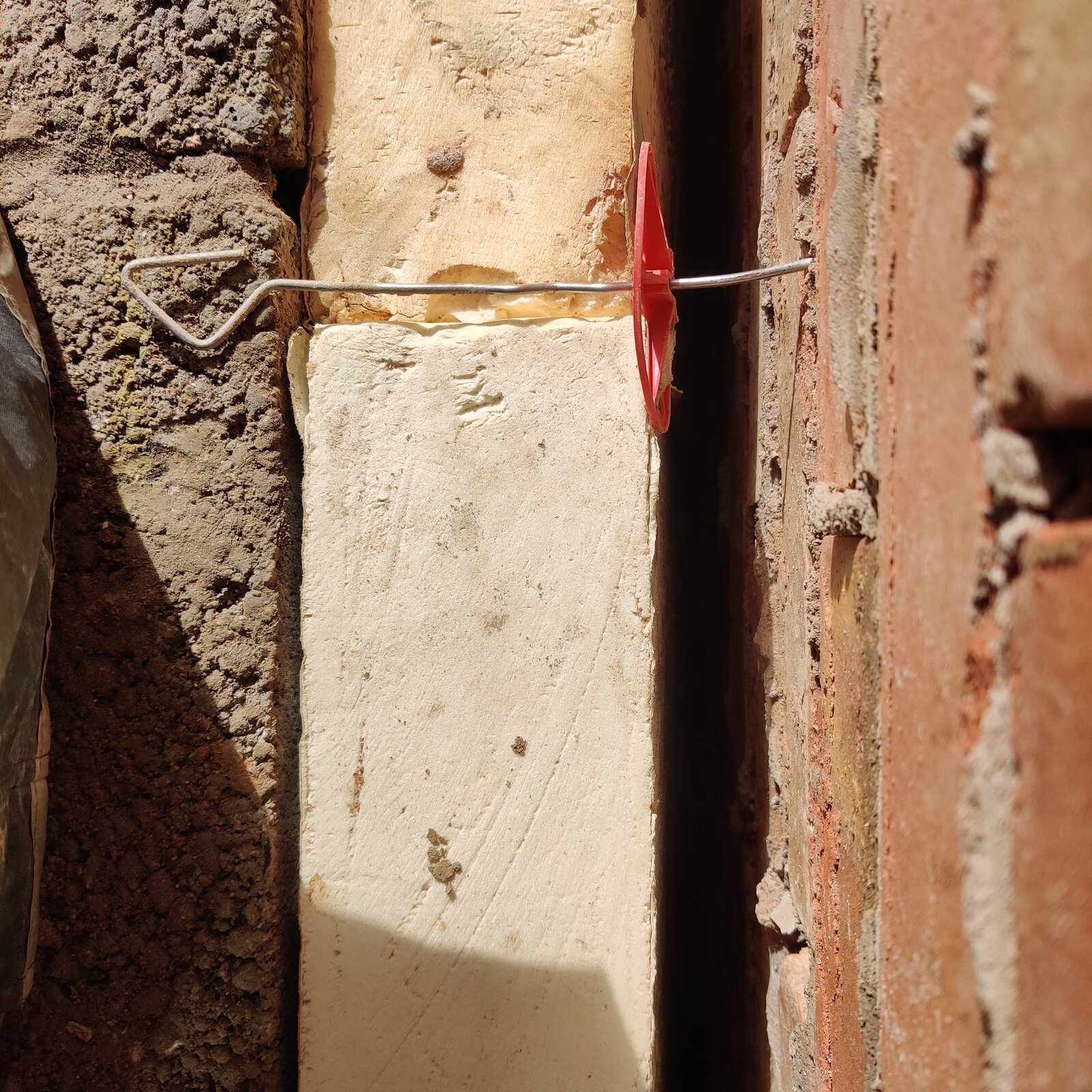

Its standard spec' I'm getting from architects since June last year i.e. 90mm insulation in a 100mm cavity.
What we’re they spec’ing before that? Are you talking rigid?
I'm the OP, we spec'd 100mm cavity with rockwool insulation. Until the building reg guy told us it had changed from 15 June 2022
Is your picture the state of play now?
That's looking to me as if the inner wall has not been made?
If so can the insulation be removed from the outer wall and added to the inner clipping as it is built?
It's fully built now, but I'm thinking if we can remove the blockwork and rebuild as you suggest, I can't see it being an issue.
Just ensure the insulation is pressed to inner blockwork and clip it back.
Not using the same insulation though. You will need full-fill insulation, which is a different product. Bear in mind also that some brands may require ungraded blocks to reach the minimum u-value with a 100mm cavity. Check what your inspector will accept and if he will want a u-value calculation?
That's what I'm not quite getting, why can't it be rebuilt with the same insulation? The building regs inspector stated that so long as we meet the minimum 25mm air gap, it is fine.
If the following steps are taken indeed it should work right?!:
1) Remove Blockwork
2) Remove Celotex insulation 100mm
3) Remove Insulation retaining clips from wall ties
4) Install Blockwork individually
5) With every-certain number of blockwork installed - add insulation against the blockwork.
6) Apply Insulation retaining clips to wall ties
7) Repeat steps 4-6
The cavity should be 50mm, although regulations allow less over limited areas to allow for obstacles - such as passing columns etc.
If your inspector will allow 25mm then fine but I strongly advise you to get it in writing - in an email. Inspectors come and go and if another, with a different idea, comes along you will be stuffed. Again.
Yes. Prior it was full fill 100mm Dritherm (fibreglass).
Guess it’s this stuff or equivalent?
Is that the thing to use now and carry on with 100mm cavity? I bet that takes some getting used to if you’ve been doing mainly dritherm32 etc for decades!
I spec eco cavity quite a lot because builders tell me it's one of the easier to get hold of and also one of the cheapest. Problem is, it's only 90mm and you need to be careful what blocks you use with it. Standard shield blocks don't quite meet 0.18 so you need turbo or solar blocks.
Other brands are 95mm so not a problem.

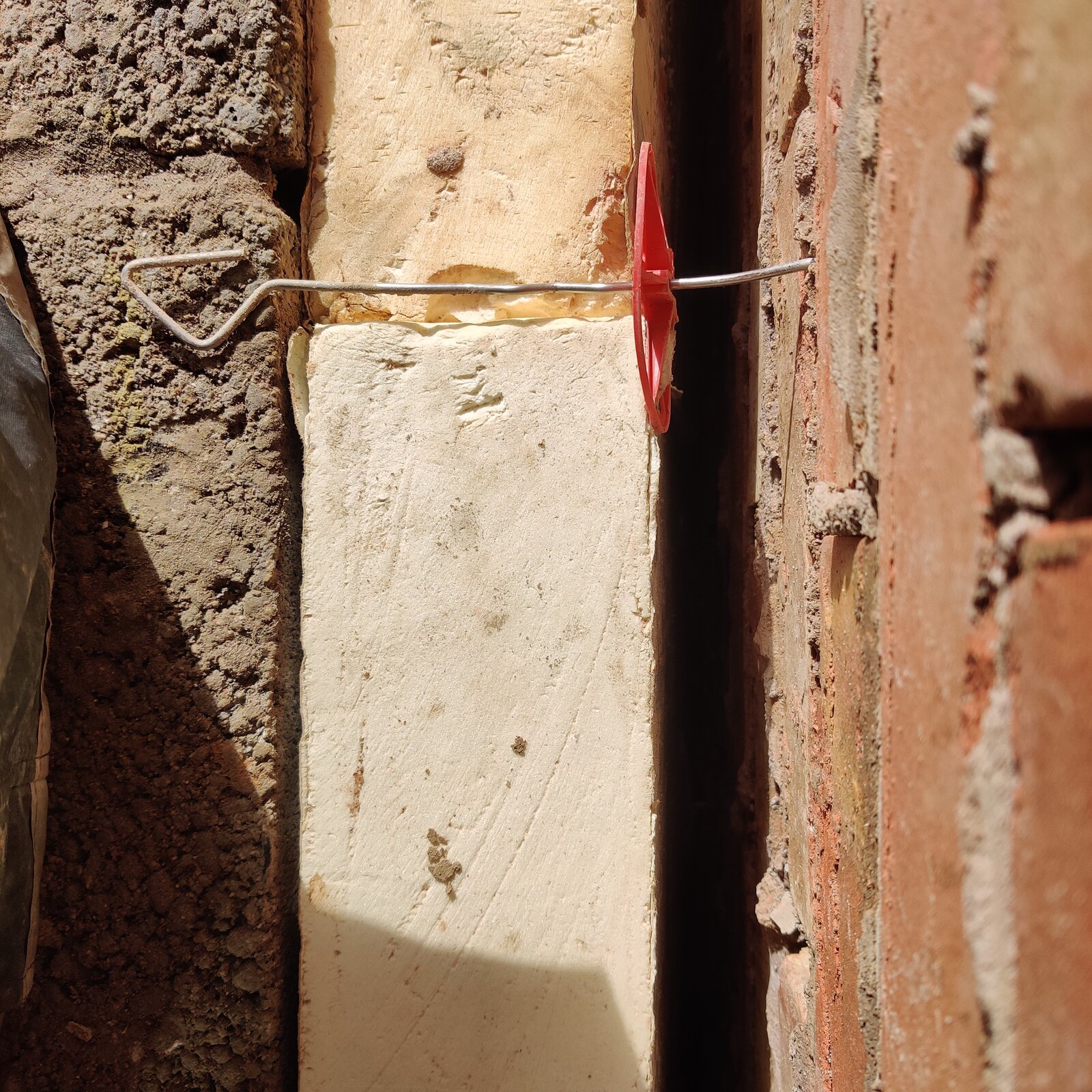

Thought I should provide an update on this for anyone in the future, we eventually went with taking down the blockwork and trying to tie back to blockwork.
Building regs stipulated that we call them out once we have reached just below shoulder height on the rebuild. On inspection the inspector said it was fine, and we are okay to proceed. See image below.
Thank goodness.
