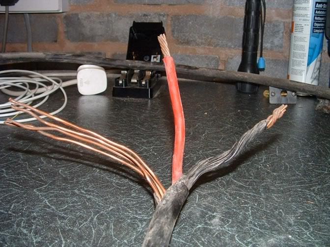

You can clearly see this is a TN-S system, but looks very much like a TN-C-S with the covers on. A trained eye can distinguish bewteen a 16mm split concentric and a 16mm straight concentric, but a 25mm straight concentric looks very very similar to a 16mm split concentric.
To me it look like half the outer strands are into the neutral block and the other half of the same layer are into the earth block.
If that is the case then it is the same as having the N E link fitted.

You clearly have no idea what a SPLIT CONCENTRIC cable looks like then ;)
This is why I posted this, as FAR TOO MANY PEOPLE assume a single cable to a head is PME - In atleast 50% of the cases in my area they ARE TN-S!!!
Notice that the N to E link IS NOT INSTALLED.
Take a look into split concentric in other posts, look for my pics of it being stripped back, my link below:
CLICKY
This is why I posted this, as FAR TOO MANY PEOPLE assume a single cable to a head is PME - In at least 50% of the cases in my area they ARE TN-S!!!
OK I admit to being ignorant. :oops: But based on what I have seen on at least one occasion where there was NO separation between the strands of the outers.

There are two types.
Tho one you describe is a straight concentric cable it has a live surrounded by just the combined uninsulated earth/neutral strands
The type in the photos above is a split concentric cable. It has a live surrounded by insulated neutral conductors, and uninsulated earth conductors.
This is straight con cable
