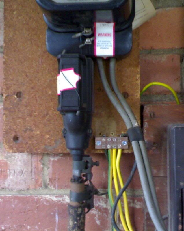

Not easy to see, but in top of picyure you can just see twin black and twisted earth.

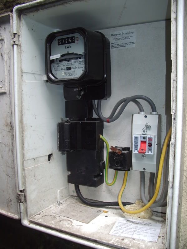

You currently have a TN-S supply (like this). The earth is connected to the sheath of the supply cable.
A PME (or TN-C-S) looks like this. The earth is connected into the supply head.
(Images pinched from Lectrician)
Although sometimes you find a pvc cable entering the cut-out & an earth leaving the cut-out and it can be TN-S because the link between N & E bars is missing.
You cannot say with certainty that just because the earth is connected to the cut-out that the supply is PME.
You can also find underground TT supplies too, but that's another story...
A few tests soon confirms either way, but generally it is one or t'other. Oh and the PME sticker!
This piccy shows the PME a bit clearer.
All that space and they stick the meter an inch from the cutout. Nice pic. Not seen an open cutout before. Is there no restraint on those concentrics?
No restraints on the cables, but they run straight into the cavity so the chance of them getting yoinked from the head is pretty slim.
Who else can get away with cables in a cavity?
I will post my TN-S supply later - I have SPLIT CON feeding my head.
Havn't seen the inside of a cutout! Where you been :D
PME sticker not g'teed!
I have seen many PME supplies without a sticker & 100's of TT supplies (in Staffs) with PME stickers all over them...some joke!
