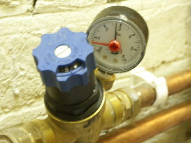

Pressure guage showing be 2.9
Well, there must be a blockage in your pipework between the cylinder and the underperforming bathrooms.
With 50l/m and 2.9bar static your system should run like a train.

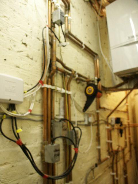

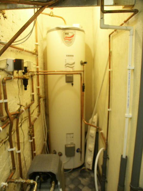

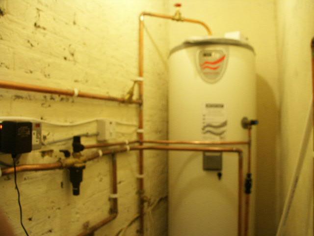

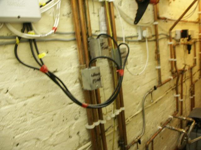

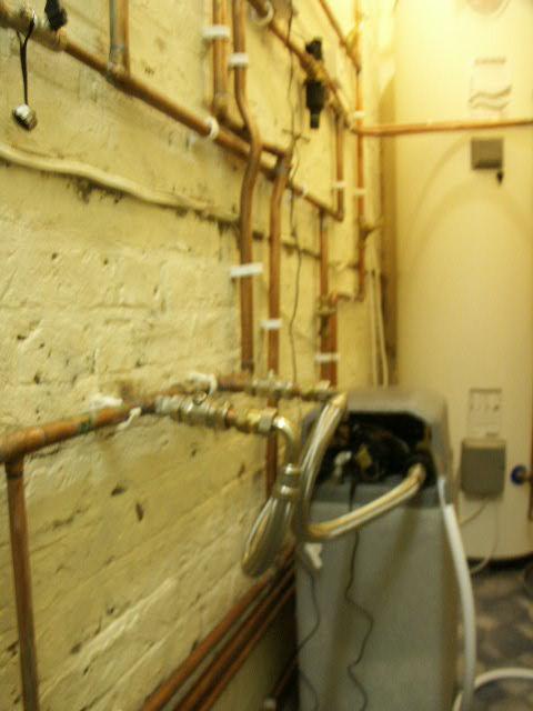

Heres some pics which I took last night. Not gret of pics.
I have 4 zones in total, Hot water, Ground, 1st and Loft
Magnaclean for the boiler
300L Megaflow
No isolating valves except for full bore which is connected to the water softner.
stop cocks for pipe work going to 1st floor and loft bathrooms
Also stock cock for ground floor bathroom
Gatevalves for the Megaflow
Its been doing my head in, in trying to sort the pressure out, is there some sort of tool out there which can chase the pipes to see what the water flow/ pressure is, as this will determine if there is a blockage somewhere or not.
As mentioned 2 people have suggested either installing an Accumaltor or adding a pump to the hot and cold feed where the water is being pushed up.
Im not sure if this is the right method considering Ive spent alot of money on the current system and fairly dissapointed with the results
Well, looking at the pictures it's not an installation I'd be proud of, assuming it was all done at the same time.
But the facts and measurements show that you have a blockage or restriction somewhere on the hot and cold - or your pressure reading is incorrect.
Pumps are out, because it is unvented and you will suck water through the main, and an accumulator is totally unnecessary with that flow rate.
I think it needs someone to look at this who has a flow cup and a pressure gauge and can work out where the problems lie.
Have you turned off the mains water to house, turned a hot tap to release pressure in cylinder and then checked that the pressure gauge goes to zero?
Tony
No, it was done in different stages by 2 different people and has been going on since October last year. Due to the renovation works it had to be done in stages and as usual the first plumber screwed me over hence had to get the 2nd one in.
Ive switched off the mains and turned the hot water tap on, yes the pressure gauge does go done and then eventually the hot water pressure goes done as well.
