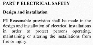

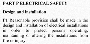

No, not notifiable in England.
Notification is nothing to do with Part P which applies to all work in dwellings but merely states:
There are only three notifiable works in England which are:
(a) the installation of a new circuit;
(b) the replacement of a consumer unit; or
(c) any addition or alteration to existing circuits in a special location.”;
Special location being the zones of a bathroom etc.
