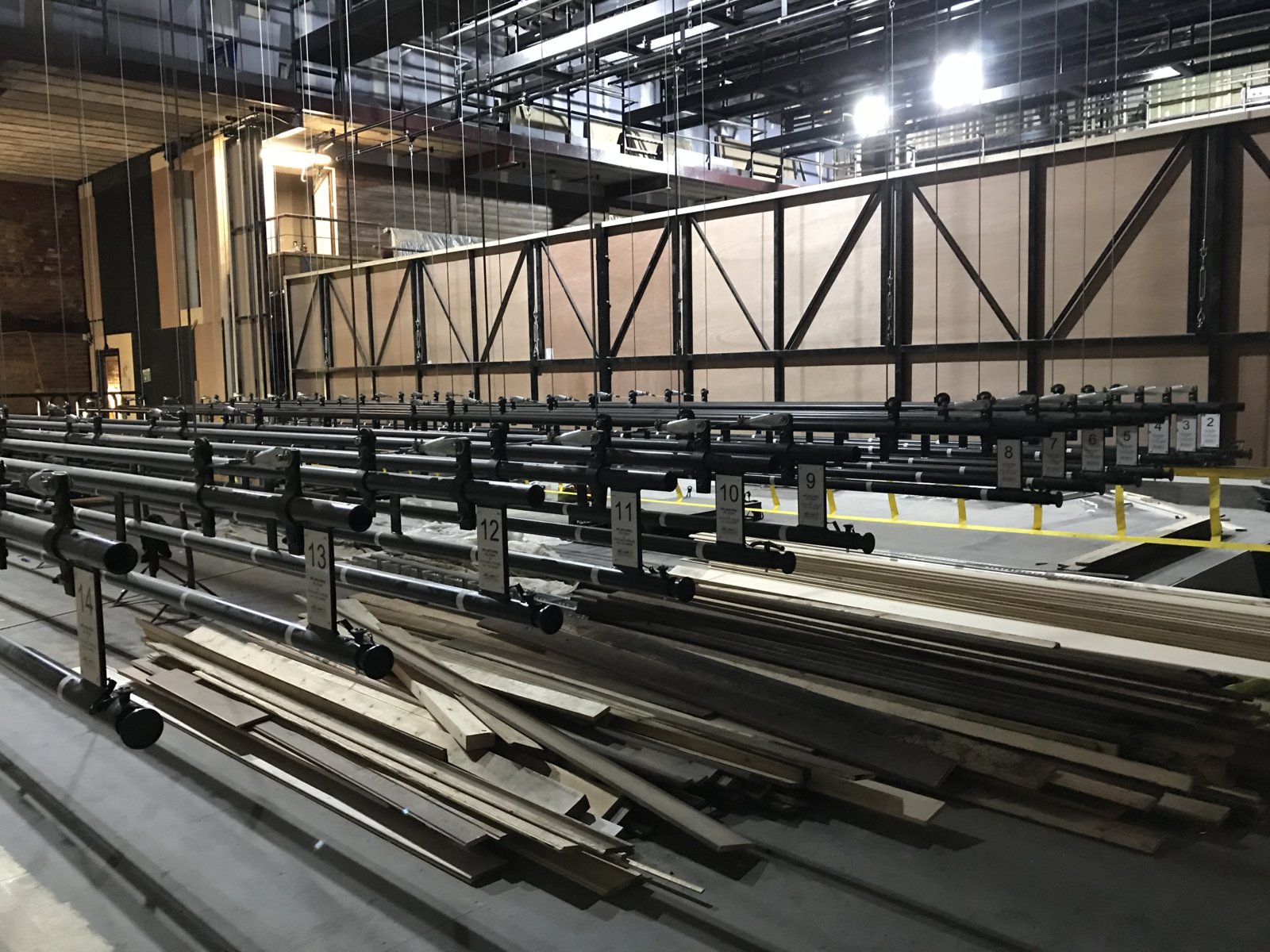

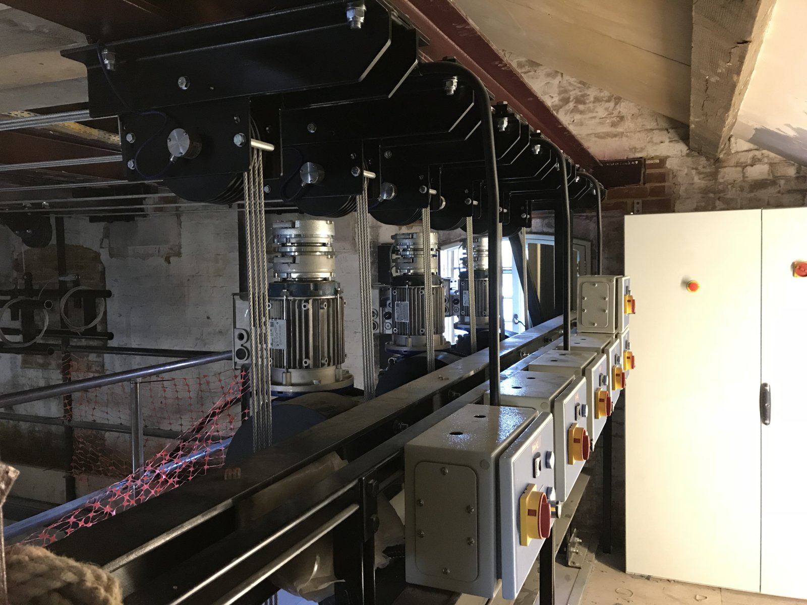

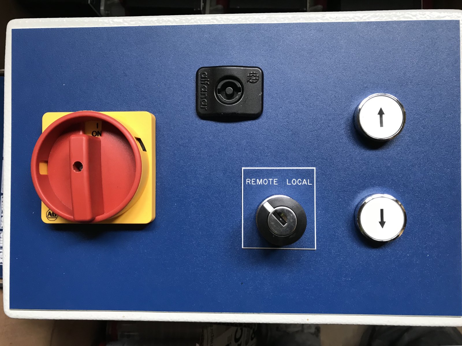

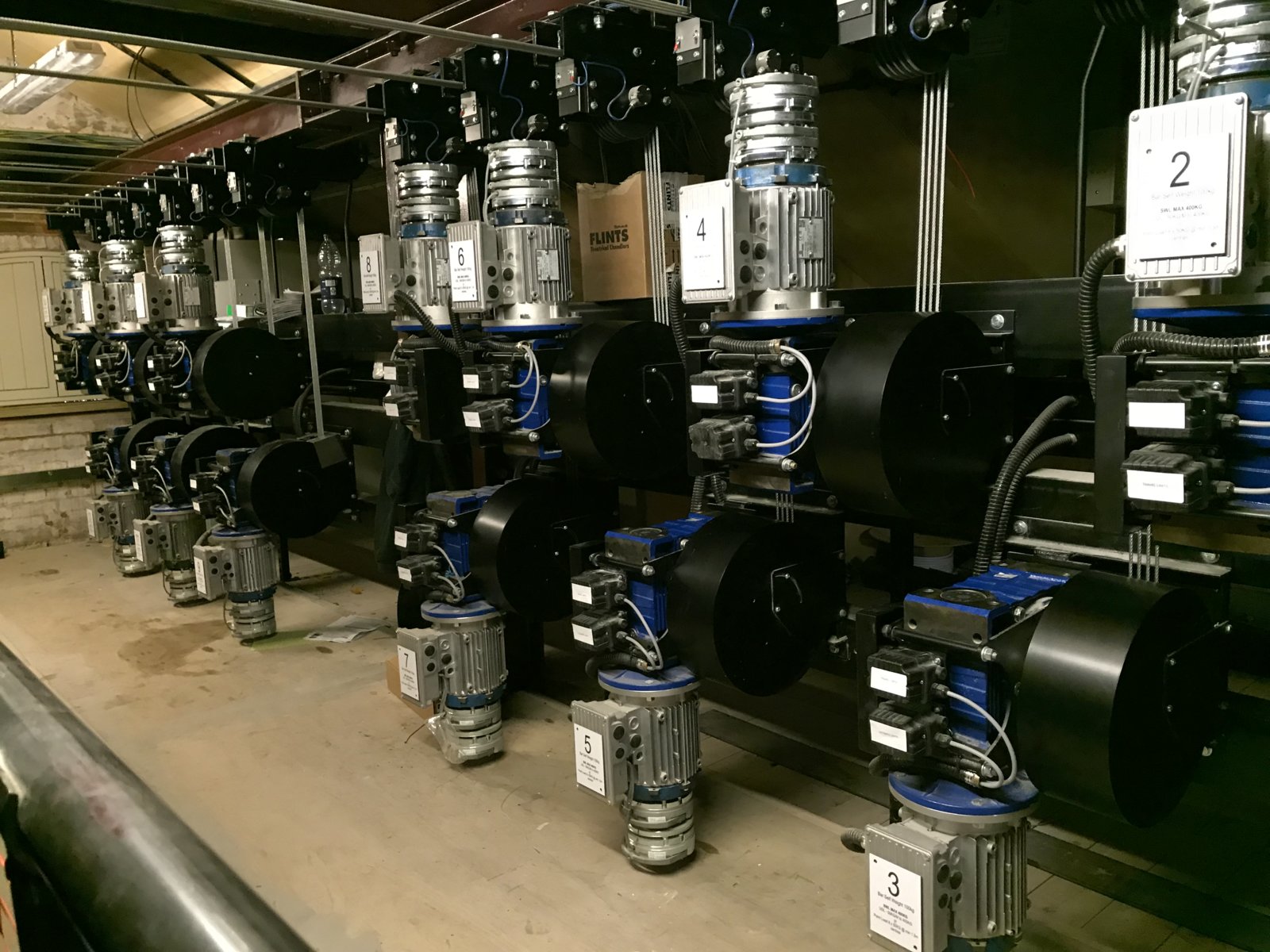

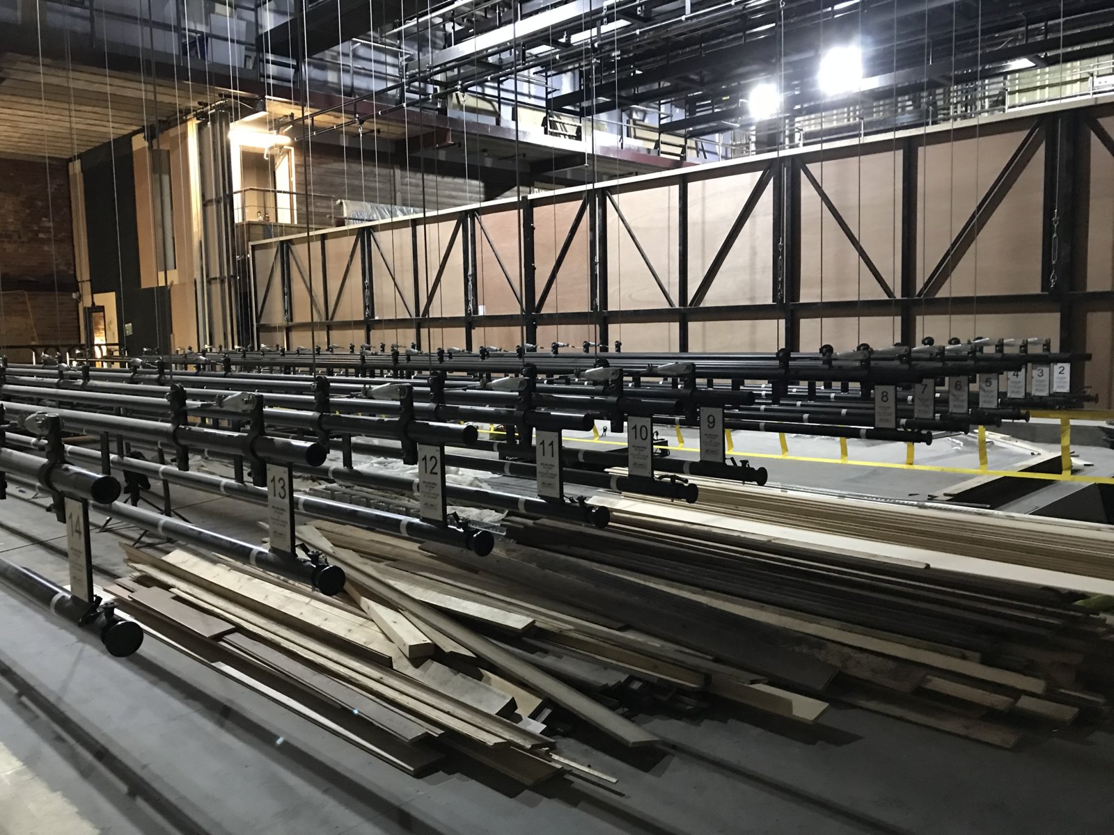

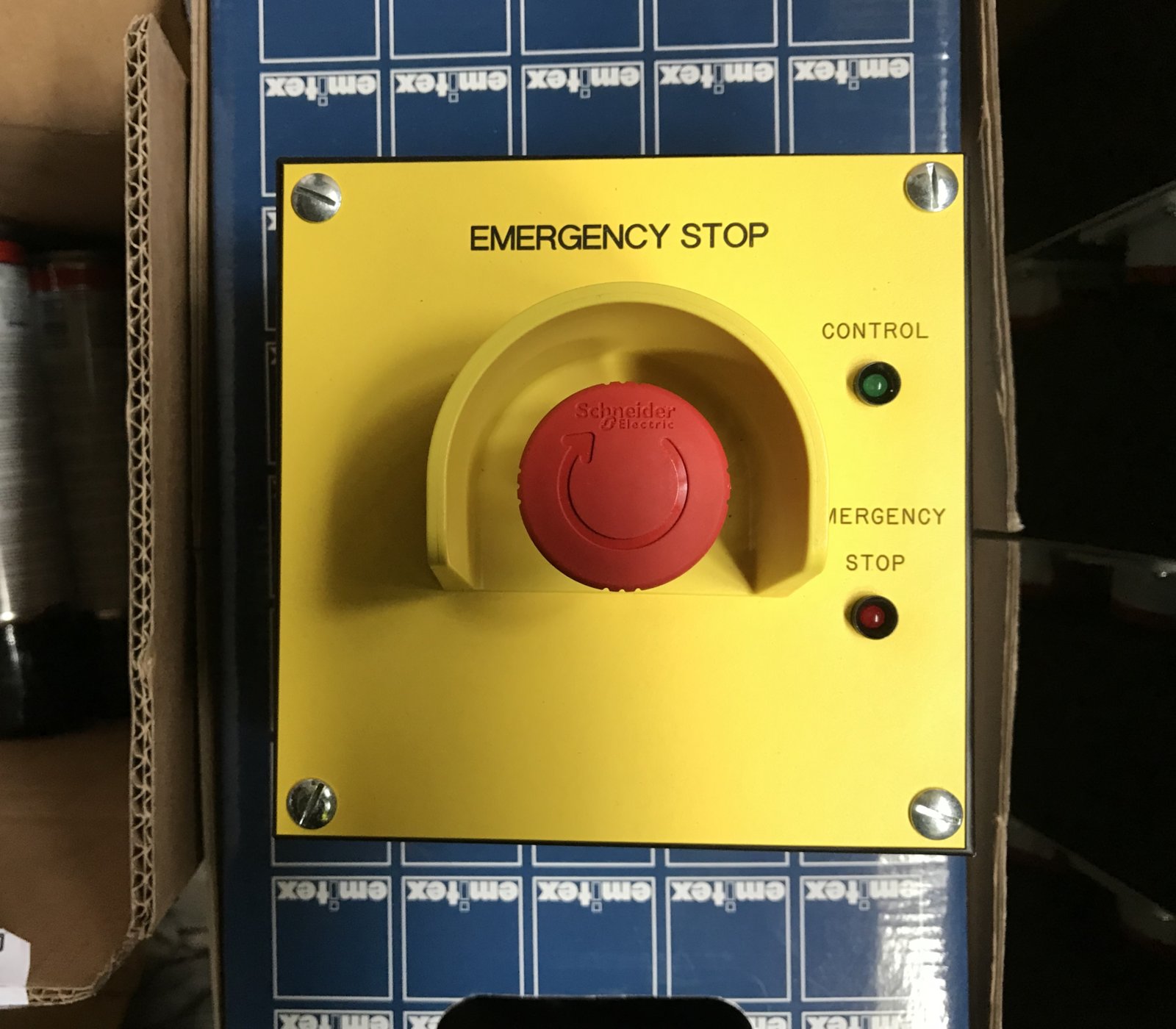

I’m sat at home bored so I thought I’d share with you a few photos of a job I recently completed.

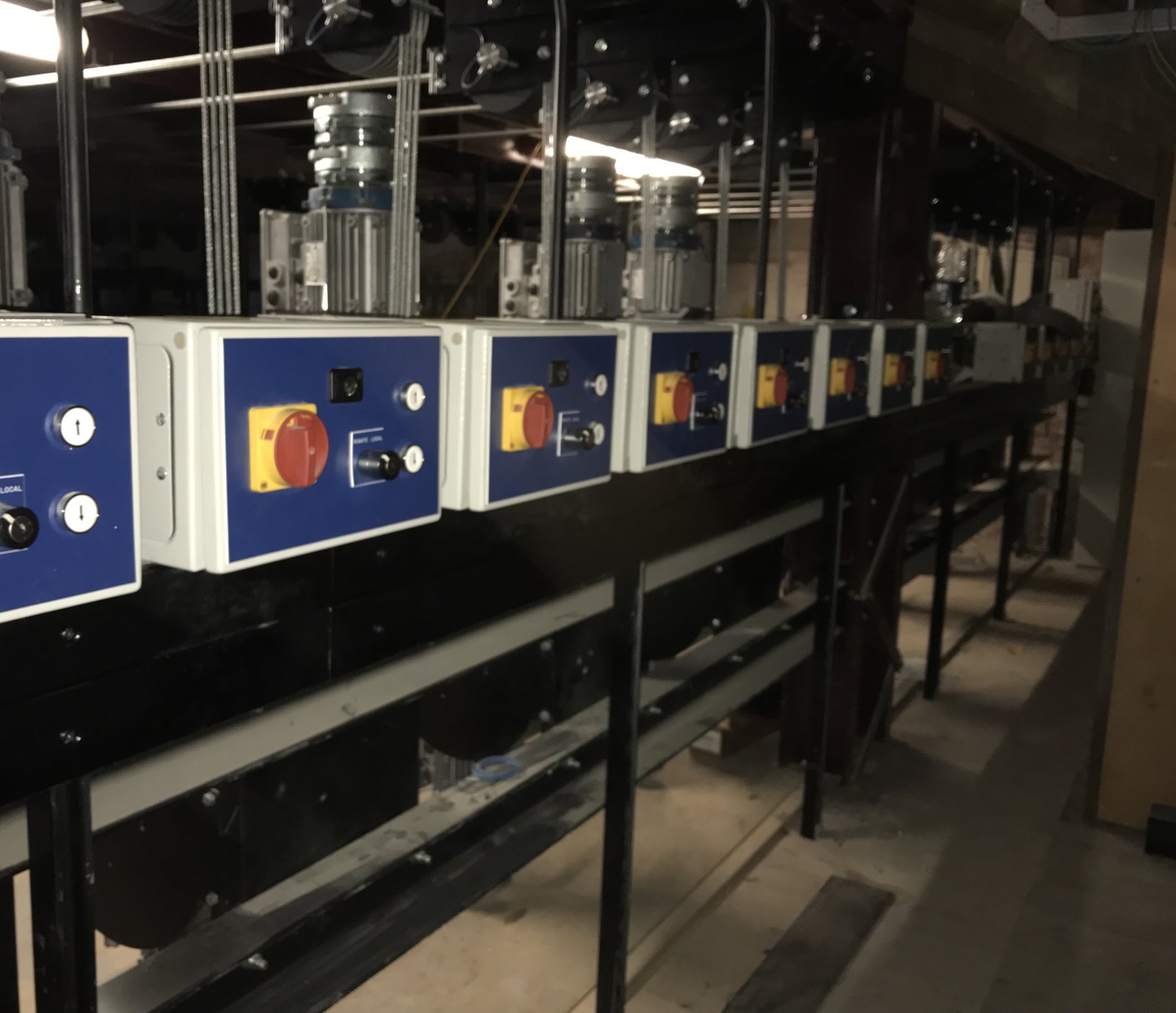

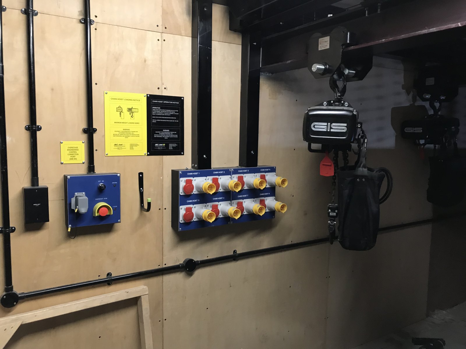

The project was a small theatre and comprises of 14no. Inverter driven pilewind bars over the stage area for hanging theatre lights, drapes and scenery etc from. Each bar is rated to half a ton.

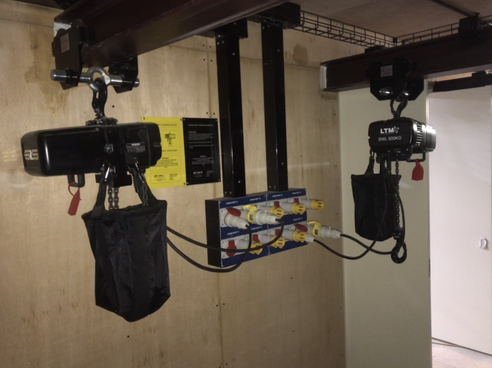

There is also 16 outlets for chain hoists which are rated to lift one ton each.

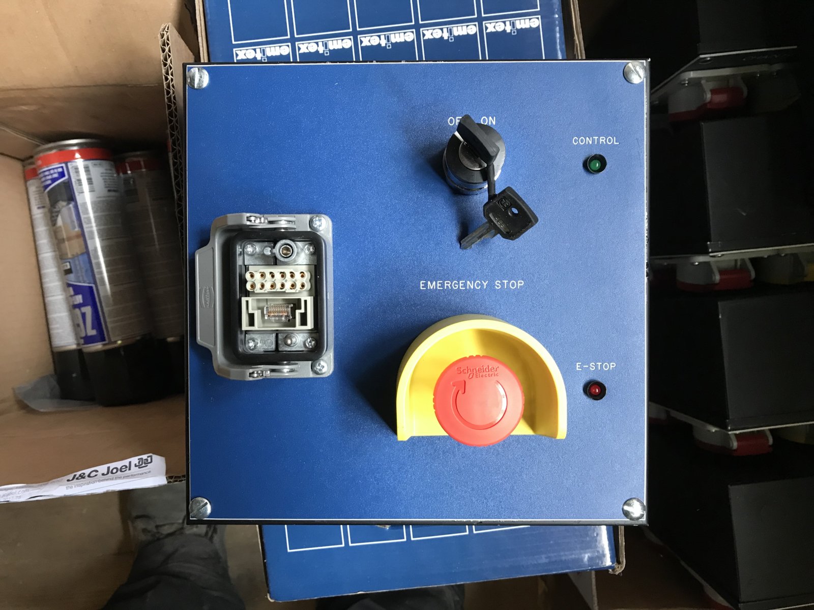

The entire installation is controlled via a touchscreen which can be plugged in to various outlets around the stage area.
Picture 7 told me what it was and the Flints box in picture 8 confirmed my suspicions
SWEET.
