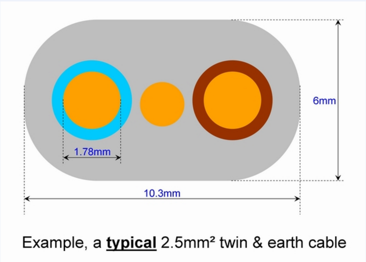

2 questions.
Can I use the existing (6mm²) wiring (changing the fuse at the consumer unit to 13A) to supply the built in pump of a power shower? If yes, is this notifiable or is it akin to replacing one electric shower with another?

My colleague thinks this is OK to DIY, but I'm certain this requires part P (whereas simply replacing like for like does not).
Part P (in fact all of the Building Regulations) applies to any work whatsoever on fixed electrical cables or fixed electrical equipment located on the consumer’s side of the electricity supply meter which operate at low or extra-low voltage and are—
