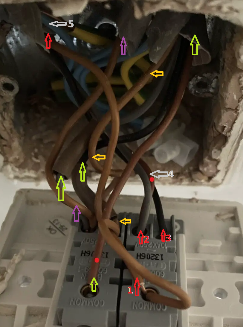

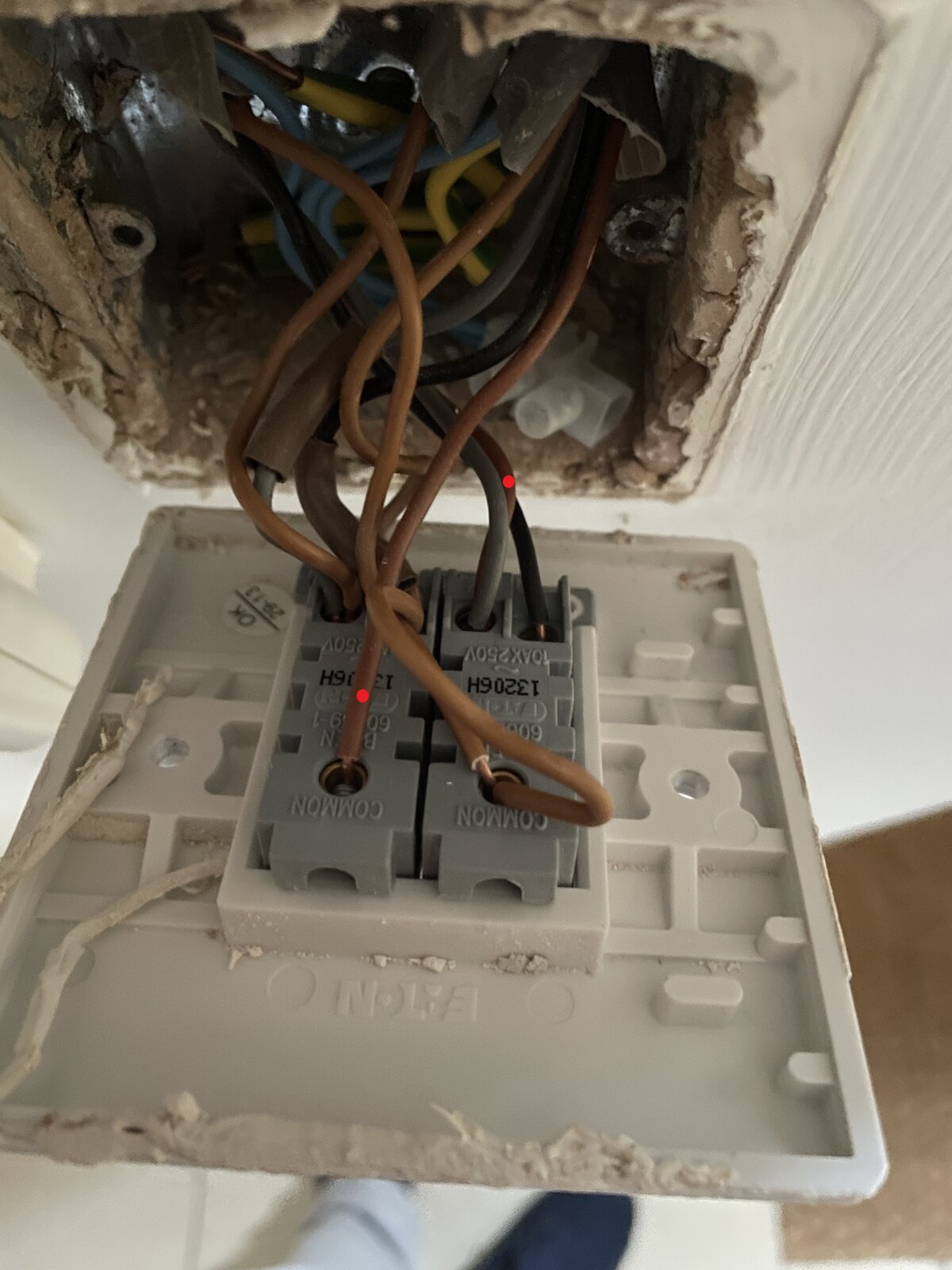

I have a two gang two way switch, where only one switch has ever worked.
The switch on the left controls a light in the hallway, this light is also controlled by another switch elsewhere in the hall.
The switch on the right should control an outside light - it's not worked since I've moved in to the house though. I'd like to fix it now.
I've taken the faceplate off to have a look at what the issue was - I was hoping for a loose connection - but am confused by what I'm seeing. I was expecting to see a bridge between common and common, but instead there's one between common and L1. I've also noted I have two shades of brown wire (is that even a thing? It feels like it really shouldn't be a thing!) and on the left, the darker brown goes to common, and on the right it goes to L2 - marked with a red dot on the photo. Does this look okay or is there something visibly off? Thanks.

I think I show where each colour forms a cable
Green being a 3C&E to the other switch of a 2 way system
Yellow being the Live supply to the switch
Purple being a T&E switched live to the halllight that works
To that point it seems to be appropriate. Then it gets a bit tricky to see the cable sheaths and where these go in the top left corner so points to a blue wire:
Red being a 3C&E to the other switch of a 2 way system
Grey being the a T&E switched live to the outside light that doesn't work .
I see several scenarios, so I'll require more information:
Can you confirm my coloured arrows do indicate wires froming a cable, particularly Red and Grey, I've numbered them to help you correct me
What cable do you have at the outside light? T&E (brown/blue) or 3C&E (brown/black/grey)
