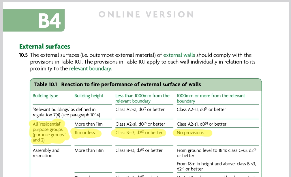

As I understand it any cladding on a building (less than 11m high) but within 1m of a boundary should achieve a Class B-s3, d2(2) or better, that's not it's fire containment from within but it's ability to resist fire on the outside. Sure, perhaps some common sense/leeway could be applied, the boundary looks pretty innocent however there's nothing ironic about it, your designer should have thought about this long ago, it's them who should be feeling the toe of your kick not BC.

As far as I understand it, if it's over 1m from the boundary then no fire resistance is required.

I think the building inspector has raised the issue under regulation B3 fire resistance of the structure. Because the building is timber framed with timber cladding the external walls effectively form one large unprotected area, rather like having a massive window in an elevation close to the boundary. That is why the inspector is asking for 60 minutes fire resistance.
Regulation B4 just deals with surface spread of flame which as you pointed out is only really an issue if you are closer than 1m to the boundary.
