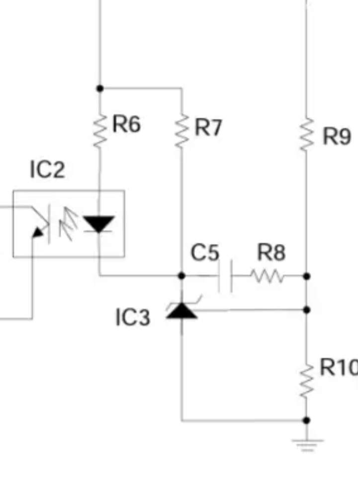

Yes, but it could also drain through these two resistors (R9 and 10 on the schematic), if the LED were to fail.

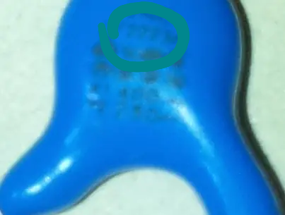

Impossible to identify this capacitor. It measures 1.45-1.48nF depending on probe polarity. So, I have to assume it's correct? The lossy image format used by this site losses some details from the original.
The markings are:
top: JNC
Bottom: 750
Above bottom: 400 or 40C
That's the 'Class Y' capacitor.
It is used to limit RF interference.
It is designed to fail open circuit, ensuring isolation between the mains and ELV output, if it were to fail.
1.5nF is about right, a much larger value could cause a dangerous leakage current from the mains, bypassing the isolation.
The highlighted number will give you the intended value.

Out of curiosity, what controls the output voltage? Is there a single component that does it? I need a 21v power supply and got the 24v one because it was cheaper. I didn't think at low amperage of 200mA, a few volts difference is a big deal.
One solution I am thinking of is to output the DC to a discrete PWM controller. The PWM then feeds the end load. By reducing the PWM duty cycle, I will have a lower resulting voltage. This also lowers the load on the power supply.
I't done by feedback, using the opto-isolator. The brighter the opto, the higher the voltage on the output, so over a preset brightness level, the input is reduced. Find the potential divider network, adjust the values of those components, and you will adjust the voltage output.
The 20amp and bigger, extremely well built 50v, SMPSU's ex-BT telecomms, used to be very easy to change to 13.8v output, by simply changing a resistor value.
R9 and R10 are the potential divider,
(The tiny resistors on the bottom I highlighted earlier)
providing the reference for the shunt regulator IC3.
The 'error voltage' is modulated back through the opto-isolator to Pin 5 (feedback) of ME8115.
