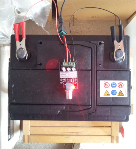

The china PWM motor controller arrived, and I put it to use immediately. I set it up to use with the high power adaptor. The results are very encouraging. The controller has a duty rate of 5%-100%, meaning power is output from the controller 5% to 100% of the time variable by a manual dial. It is not known at what frequency the output pulses. The controller turns my adaptor into a pulse charger, pulsing 21V, 1A, at an unknown frequency. I set the duty rate at the minimum and could not hear any electrolyte bubbling. Effectively I am charging at 21V with no perceivable gassing. This is going to be good.
If the PWM is not supplied from the mains, it will draws 45mA from the battery. This is a feature I wasn't expecting but actually wanted. I believe having a nett power draw phase during the charging process is critical for battery revival. This feature will be used with a timer switch. This feature is not currently being used.
The charging was going great, then during the process something triggered the PWM controller to ignore the manual dial and go full throttle. I could tell from the draw on the mains. This resulted in the battery bubbling. The trigger might have been time or heat. The controller looks bugged, and it's not hard to imagine they never planned for anyone to use it for long durations. I was definitely on the right track and will order a new controller of different make. I will get a 0%-100% duty rate controller. Even at 5% duty rate, the bugged controller was pulling 9W from the mains, which was higher than I like. I will repurpose the controller for controlling PC fans, which will be under constant passive observation during use.
Last night the battery was at 551cca and everything was ticking along very nicely. Today, it was back to 500cca and bubbling. Bubble is bad, very bad.
For luck, I have put some thermal conductive silicone under the controller's heat sink and giving it one more go.
The PWM controller is definitely broken in some way. It would enter full throttle at random moments. But all is not lost. It works with the low power adaptor fine and makes it work better. The battery CCA may have hit the wall. I will give it a couple of more days to see if it's really done. In the past the battery had around 600 CCA. It's not a big deal if this can't be reattained. It is also possible the high power adaptor may have some effects on it once I have a new controller.

I took out the less valuable and previously charged battery for experimentation with the PWM controllers. After plenty of electrolyte bubbling and head scratching, the solution was discovered to finely tune the charging process.

Battery state after a few days of non-productive experimental play:
13.36V while connected to charger, draw from mains 1.2W, feed to battery 18V 4mA pulses at 22.5kHz of minimal duty rate
13.29V stand alone
6.57 m-Ohm internal resistance
69% (correction) wear life
395 CCA, Spec: 435 CCA, type 075
Finally, an unexpected breakthrough. Since I started playing with this battery, it had never went beyond 395 CCA. Now it has, proving the value of PWM controllers, and high voltage. It is now possible for me to select the amperage the battery receives. The precision I have is +/- 5mA. The bubbling caused by the high voltage is an issue. This could be countered with rest or nett-draw intervals during the charging process. I speculate the bubbled up gases would recombine into the electrolyte during these intervals. The intervals are not currently used.
