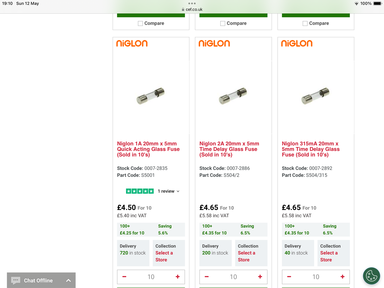

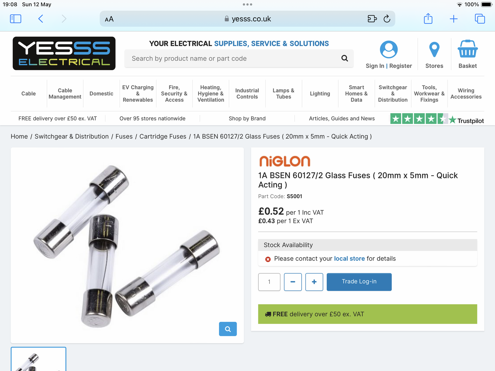

Thanks Sparkymarka, the fuse is a bit 'foggy' but the inner wire looks intact, I probably need to test it, are they special fuses or would a wholesaler like CEF stock them?
You need to search by …..glass fuse … as below
