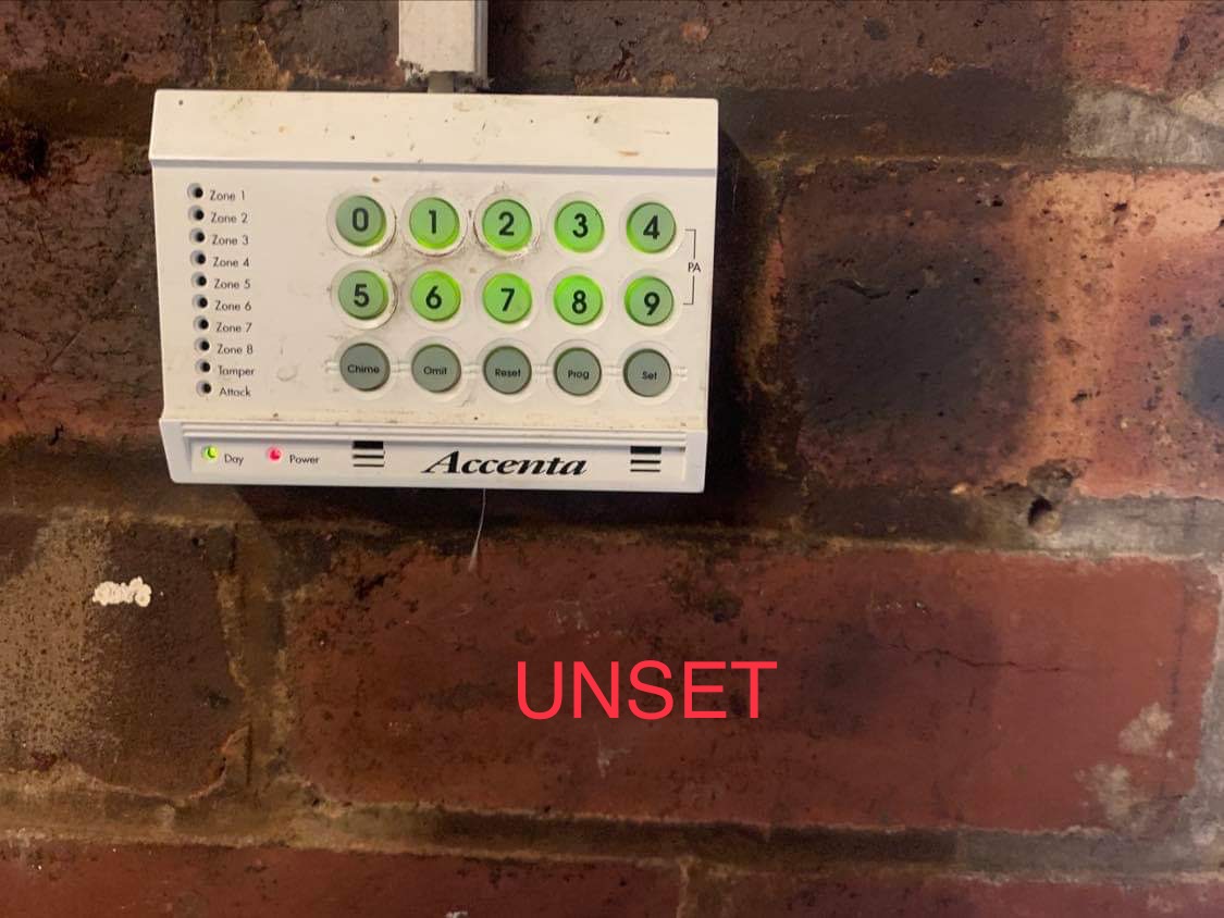

Hi thanks for the reply,
ive took photos below and a description too:-
When not set just “power” and “day” are solid lit.

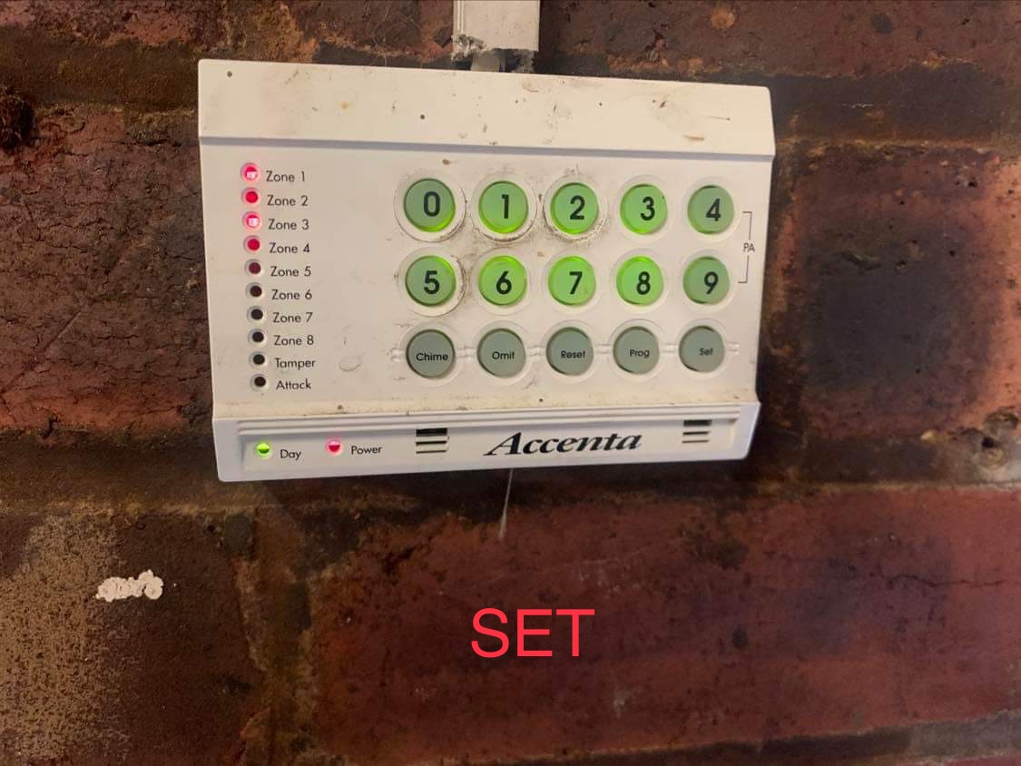

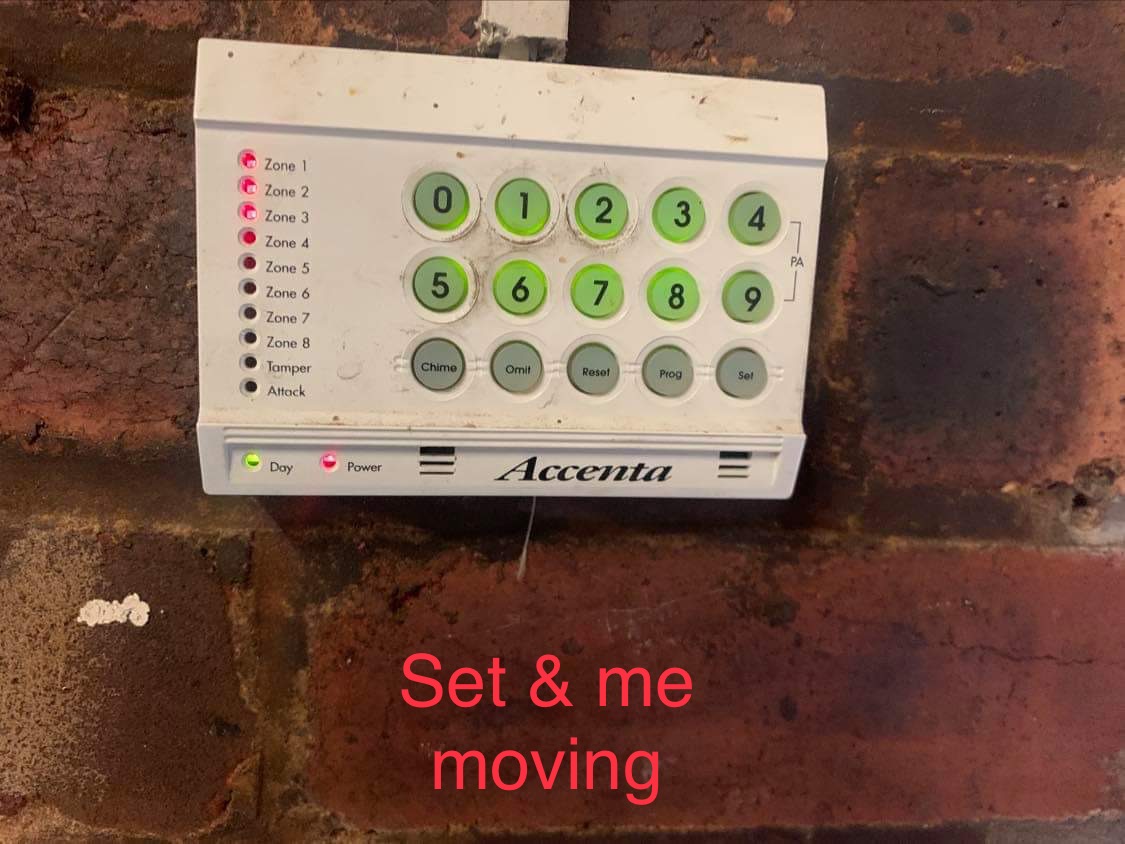

when I enter the code, zone 1 and 3 go solid red. And zone 2 comes on when I move (theres a pir pointing at the panel so assume that’s zone 2 catching me)
images below
It would appear 1 and 3 are PIR’s in other rooms.
They both do appear to be functional in that when I walk past them the red light on the PIR is coming on for a few secs.
What is the easiest way to solve this?
could it be that they’re broken? They’re all wired btw, no wireless ones as far as I can see.
p
Are you sure they are not door contacts ? Has it had new doors fitted on the property ?
You could be right. But as I said above with zone 2 I can make that light come on and off on the panel by triggering the pir by it.
When I do that for the other 2 pirs (which I assume to be 1 and 3) no lights come on the panel.
But yes there is one door contact I can see. Which does look a little worse for wear. But can only see one. No idea if active.
no new doors as far as I can see
FYI - you were right. Couldn't figure it out myself so had an alarm person out in the end.
It had multiple PIR's and door contacts all wired to the same zone because reasons. It was in the end a faulty door sensor (zone 1) and something that in the end we couldn't find on zone 3 haha. But all the PIRS and contacts are now working and the alarm sets correctly.
Thanks for all your help - you made it so the engineer only had to charge us for a couple hrs call out. Could've been much more expensive going in blind!
