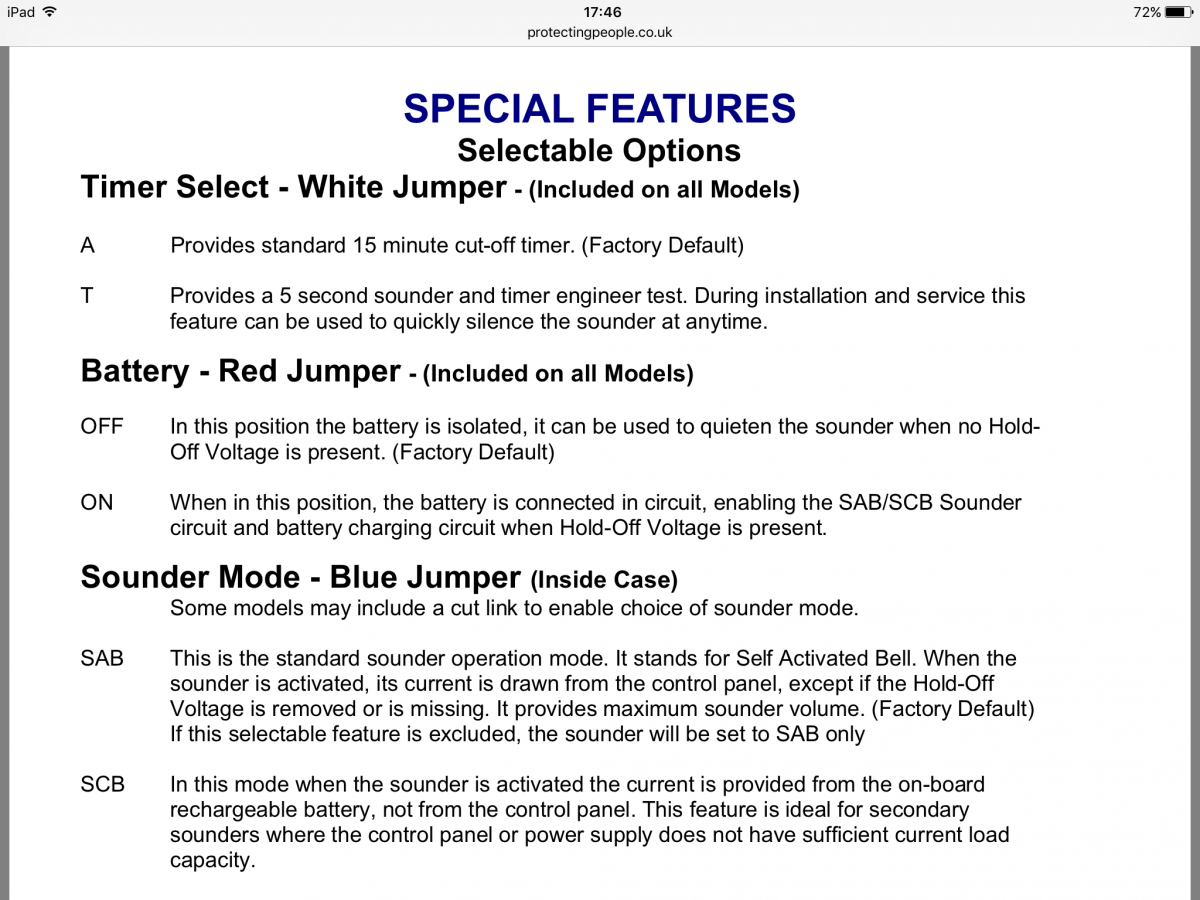

I left battery on and turned mains off then touched blue wire as advised and the bellbox rang once only and then stopped.
When i did the same again i.e. touching the wire it rang once only then nothing. So at least a connection from the B wire to the box is semi working.
Maybe the signal box is worth a look now?
Ta Ben.
Would check the test timer sounded like 5 secs
