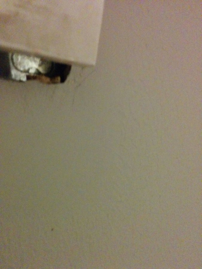

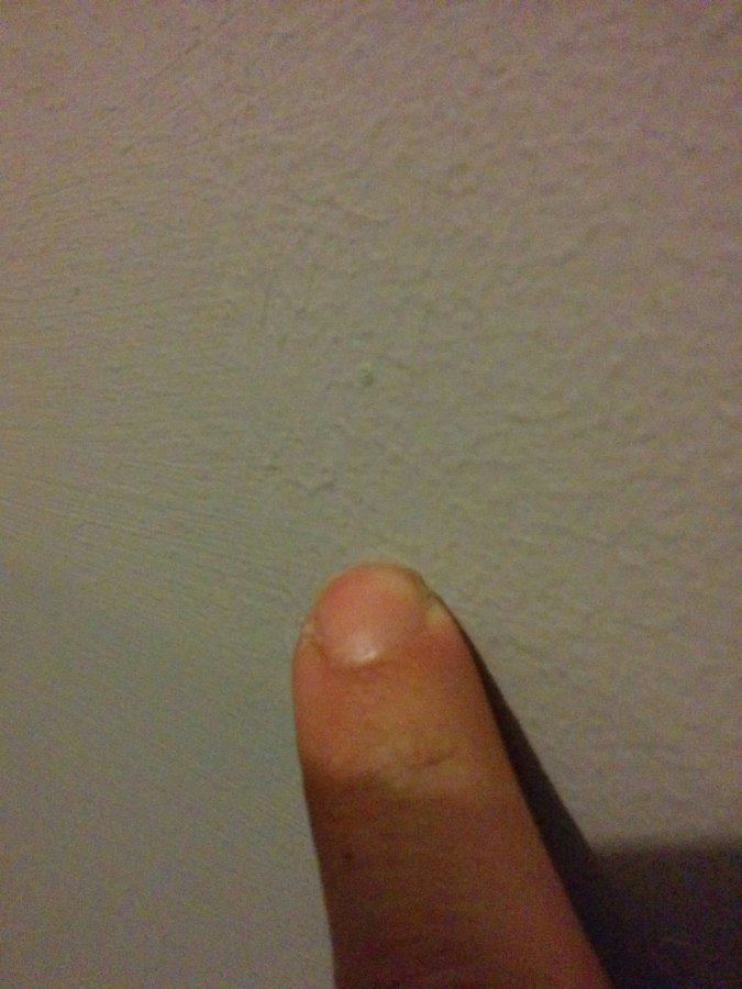

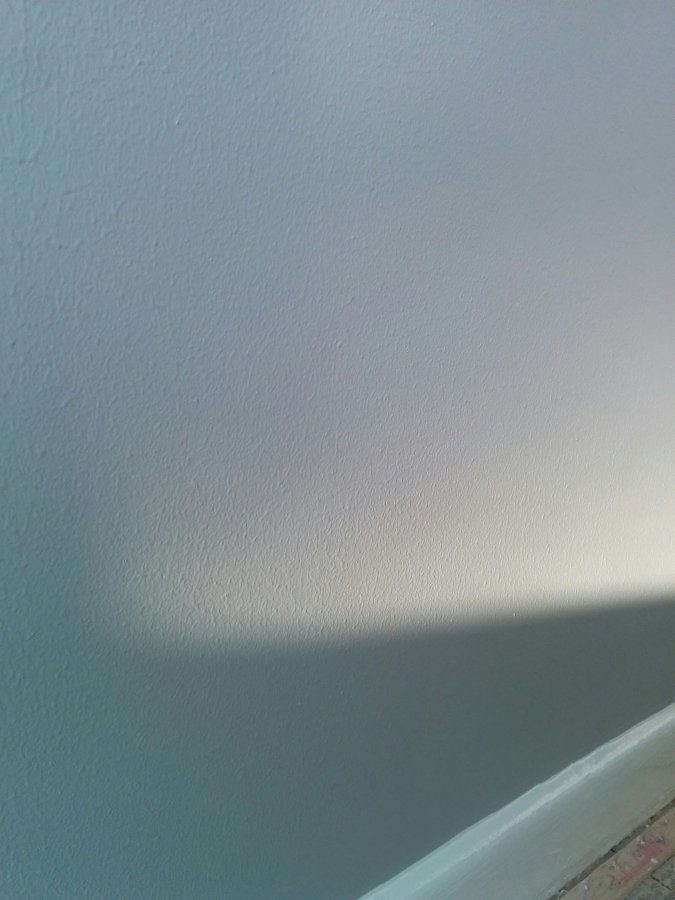

hi everyone. i have commissioned a professional painter and i am wondering if his work is of acceptable quality. i think theres too much paint stipple on a brand new plaster?
what do you think?
also shouldnt the skirting be better sanded?
i took a couple of pics to show but not sure how clear they are.. ill take some more tomorrow with better light

For new plaster, that roller stipple is unacceptable, even if it had been done by a DIYer. The paint has been applied too thickly, with probably too thick a pile sleeve. Medium sleeves are fine to use on smooth surfaces, such as plaster, but it must be spread evenly and 'layed off' to achieve a good finish.
Is the stipple everywhere or just in a few random spots? Sometimes you can overlook the odd patch if there are a lot of odd little areas to be roll, and the paint will dry before you have chance to level off. A pro should sand it back and re-paint, if that happens.
As for the skirting, it appears that there has been a poor existing finish that hasn't been de-nibbed and was just painted over. If the painter did sand the skirting smooth, he has not cleaned up all the dust and has picked it up on his brush. To me, it looks like a combination of both. Either way, the finish is poor and, if I had left that kind of finish on a job, I would expect a complaint. Those gripper rods are horrible when sanding but an experienced decorator knows the tricks to avoid shredding their fingertips, so that's no excuse not to do it properly.

The plastering in the last photo looks pretty rough, is it representative of the rest of the plastering? Is it possible that the decorator spent so long preparing the walls that he cut corners elsewhere?
I don't understand why the first photo shows both stipple and brush marks.

Thanks for the response. I paid day rate 110 live in stafford
The plaster was perfect so no imperfections on plaster. it shows brush marks as he brushed between the socket and skirting board as area was small. so he cut it with the brush
Thanks for your input. skirting was indeed due to a mixture of old and new, is it the painter responsibility to sand it? and by how much? to take it all the way back to remove lumps but keep wood dents?
i bought an electric sander to see how much i can clean it.is it a good idea?

The degree of prep to be undertaken is a tough call. Removing lumps requires sanding, dents must be filled and then sanded and if you want a decent finish you will need to use 2 pack filler which takes longer to sand, and from time to time, whilst sanding it, the surrounding paint overheats and blisters.
I know my clients, and vary the level of prep (and price) accordingly. When dealing with a new client it is less straight forward. I am concious that I am potentially competing with other decorators. I don't want to price myself out of a job BUT there are minimum levels I am willing to work to. I would have only left your job in that state if you had expressly told me not to do any prep.
Regarding your electric sander. The paint is probably still pretty soft. Hand sanding might be better.
Gripper rods are evil. Either rip them up and get new ones fitted later or put thin strips of carpet over them whilst you sand the upper parts of the skirting.

The last two photos look like an Artex Finish ??

This Photo looks like Artex Stipple Finish to me !!!

It looks like the coats have been applied very thickly, possibly before the previous coat had dried sufficiently.
I often use a longer nap roller than is recommended but I don't overload it and roll through. If I am concerned about stipple/build up, I run the DA over it with 180 grit (or add floetrol to the emulsion)
