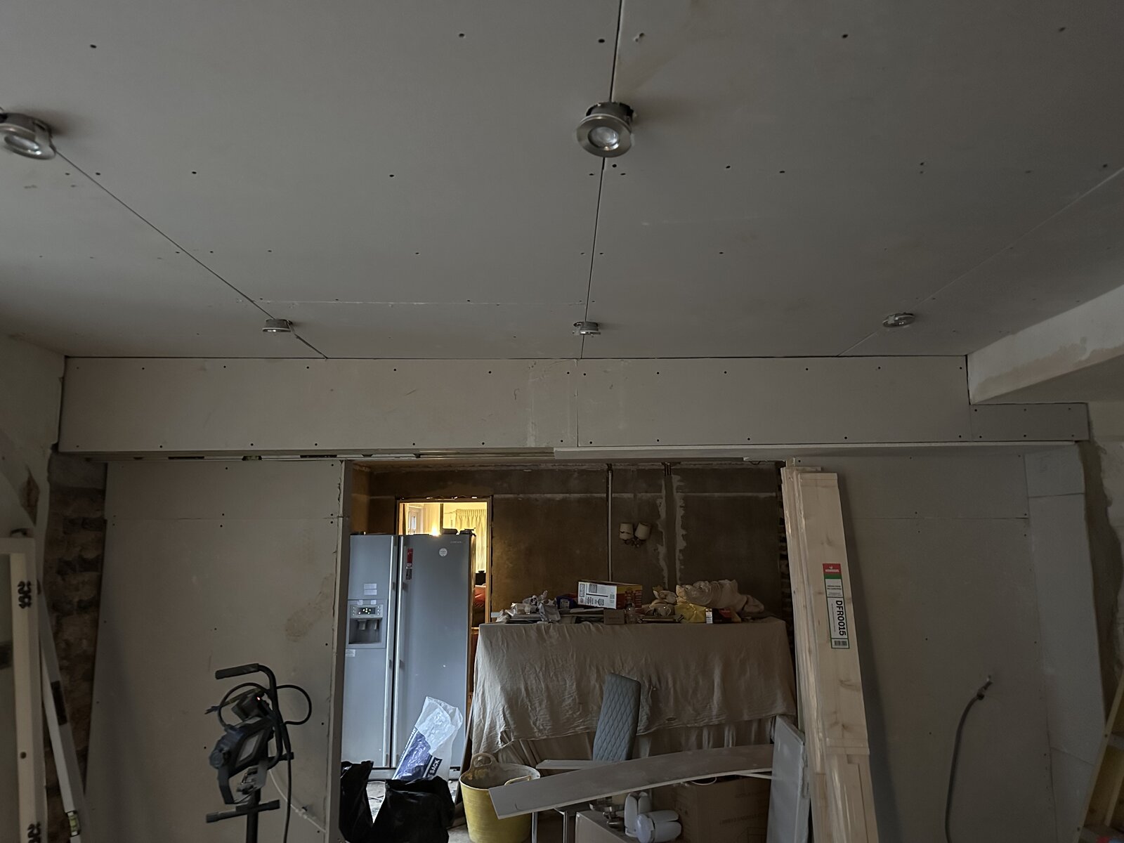

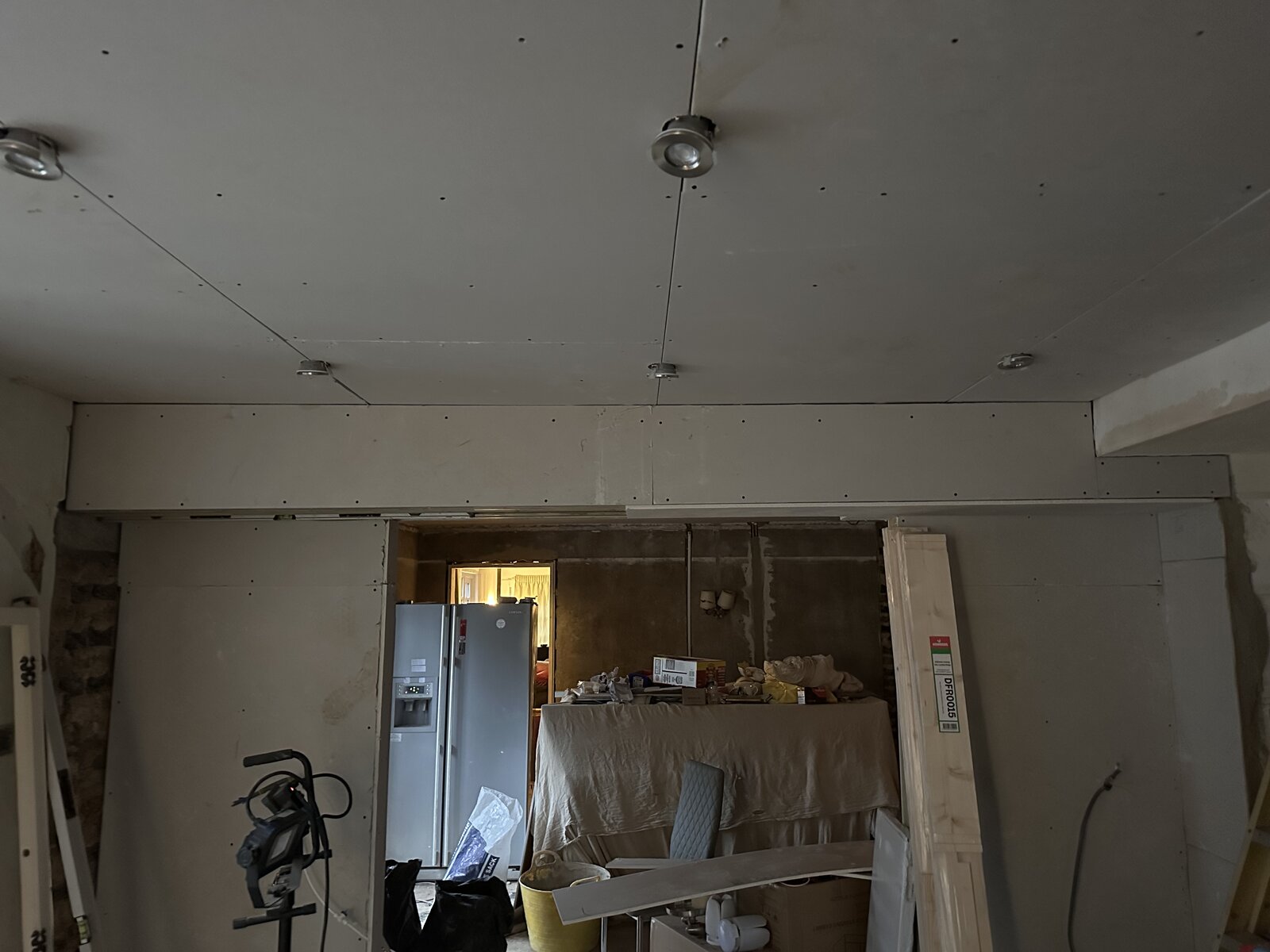

Hey all!
I am currently having a builder remove a load bearing wall and fitting an RSJ in place. However the RSJ they have put in is not level. Measuring from floor to RSJ, it is off by 5cm from left to right for a span of 3.5m.
Is this acceptable? They have also not fixed this as part of the plasterboarding so now we have a wonky beam going through the ceiling.
Please can you advise.
Thank you all in advance!

So is it already plasterboarded over? Are all the props taken down?
Floor and ceiling is level, we stuck a 6ft spirit level on it. And yes, already plasterboarded over and props taken down.
Sticking a 6ft spirit level on the plasterboard RSJ however is not level.
I can accept that the RSJ is off a bit due to issues with knocking out old brick work but I would expect them to pack out the plasterboard right?
They have arranged for plasters to come Monday so if this is an issue, we would have to raise this today with them so just wanted to know if 5cm is acceptable in the building world. I hope not as it does look noticeable
If it looks wrong, it is wrong.
They need to re-board it.

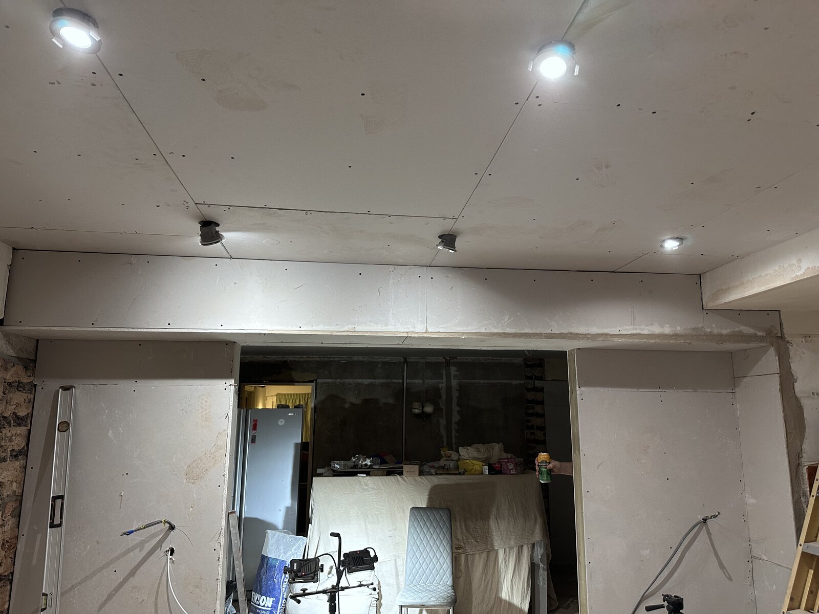

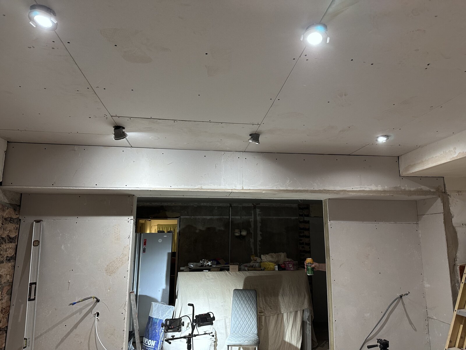

Thanks all! Glad I’m not overreacting! Spoke to the builder and they’re coming back today to fix it.

The builders came back today and fixed the wonkiness by packing out the stud before plasterboarding. This is what it looks like before and after!
