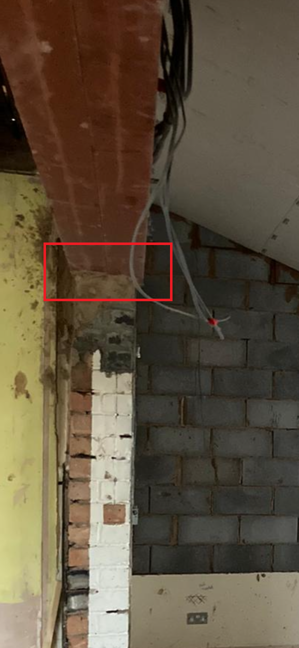

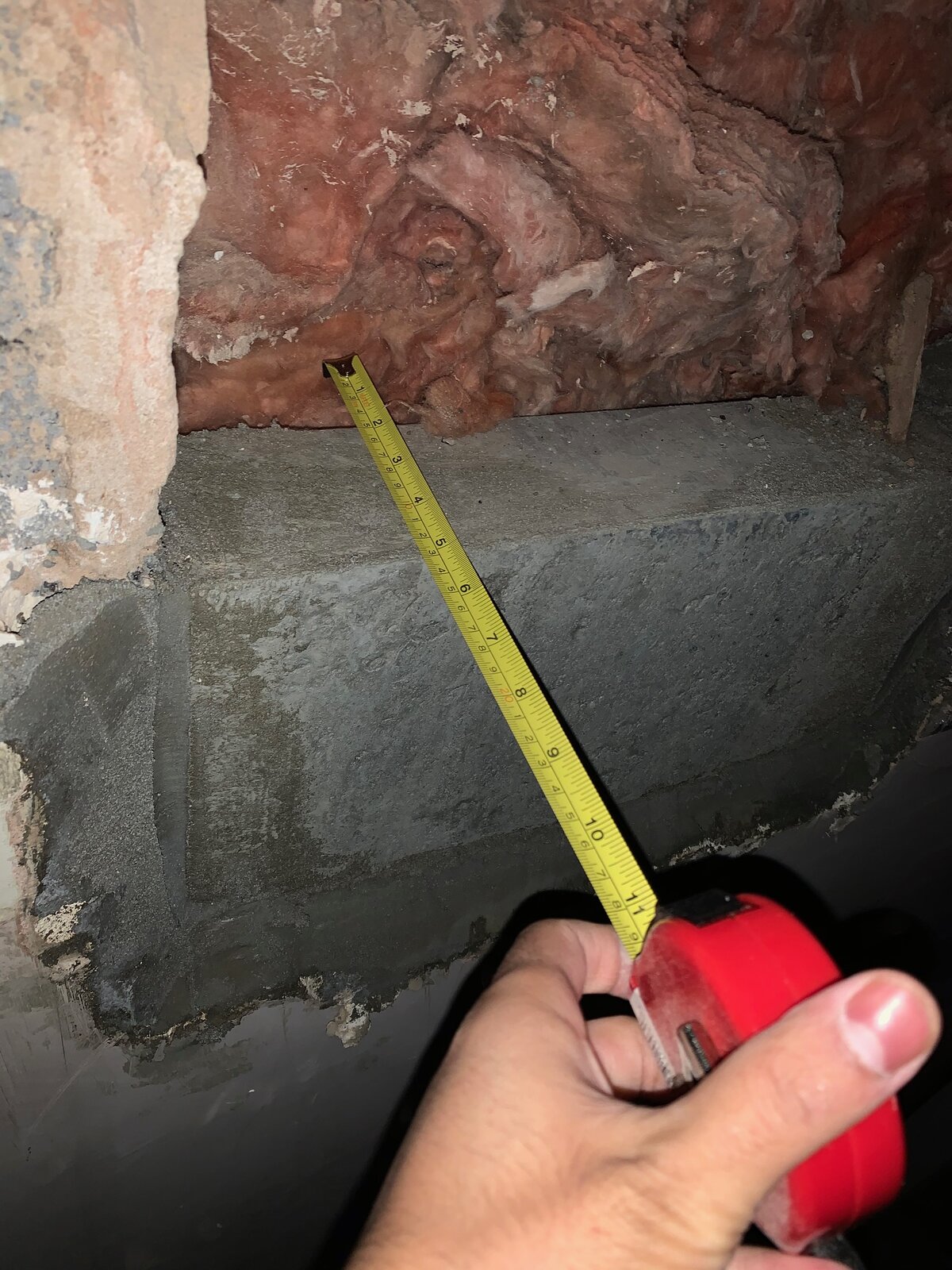

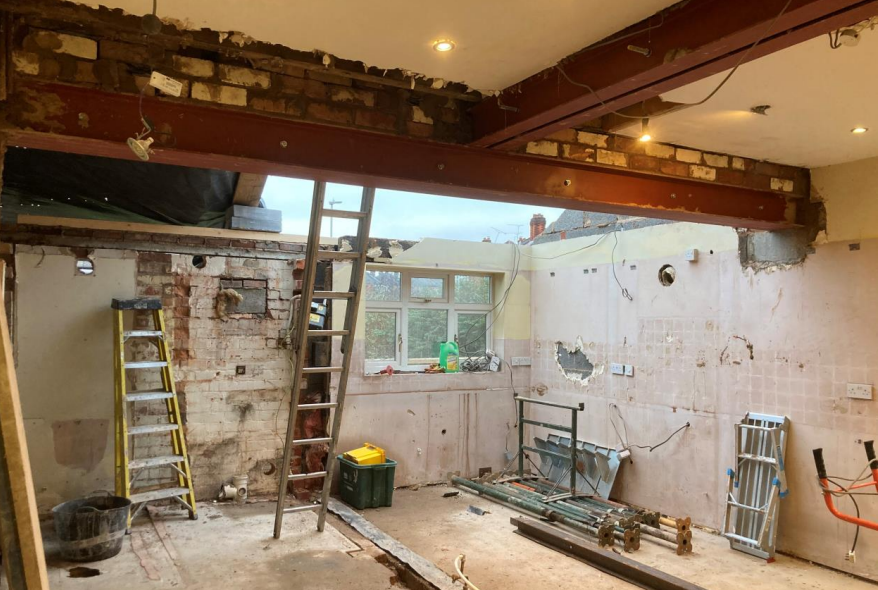

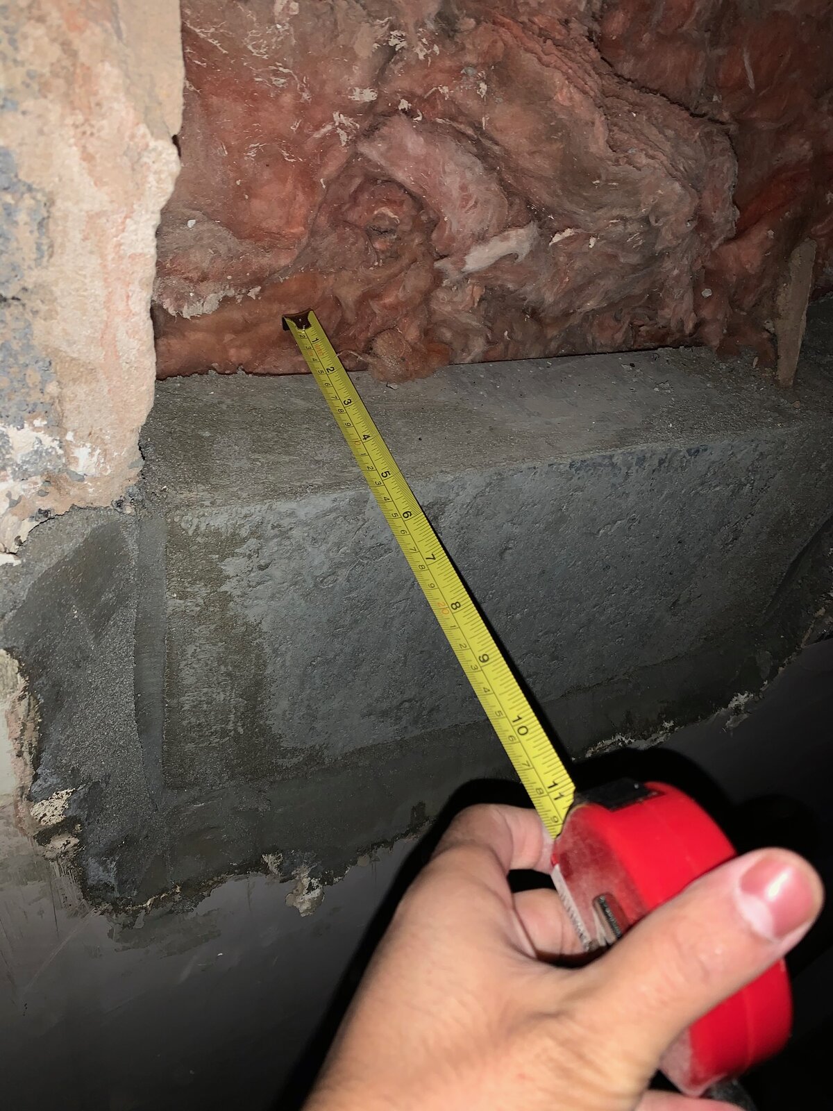

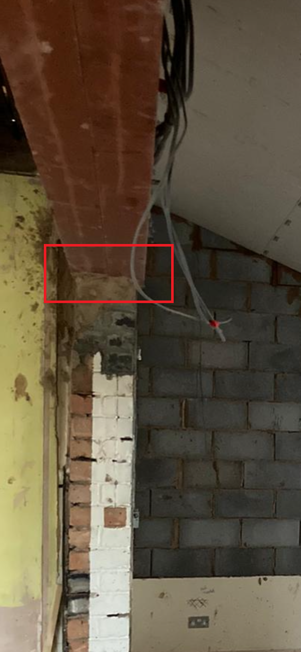

Guys,
I have a builder in doing some work for me. He put up an RSJ where there was previously a load bearing wall. Can you comment on the photos? I'm not 100% confident in what's been done.
New RSJ spans 5 metres and also supports smaller pre-existing RSJ.
Areas of concern,
- Pad stone 80mm thick
- RSJ overhanging the engineering brick
I asked for building control pre-installation but builder only started process once RSJ installation/plastering on walls completed.
Any advice appreciated.

Hi Woody,
It doesn't. The builder has told me not to worry as he's clarified the way the steel has been installed with the engineer.
Originally the column is specified to be 340x340.
The builder also said he's informed BC of the way it has been installed. But that they will only come out to check the work once plastered. I'm dubious of this as why would they need to see it fully plastered, that way they cannot check the steel installation.
Get the engineer to provide you with written updated design details (which need to be approved first by the inspector), if what the builder is saying is correct. Don't let it be covered up before this is clarified
All that the building inspector will do is approve the engineer's design, and then check that the installation is as per the engineers details

As above, you need written confirmation from the structural engineer that this variation is acceptable. Bit of a red flag builder saying BCO will inspect when it's plastered- building control aren't interested in surface finishes, they are interested in structural details (which are tricky to see hidden behind plasterboard). Every single steel/lintel install I've been involved with, BCO wanted to see the lintel and bearings etc. before it was covered.

Thanks for all the advice. Loud alarms bells have been ringing for some time.
I checked with SE and they have confirmed no revised calcs have been issued. Obviously builder was trying to fob me off.
BC is being done by a private company, expect it's someone he is familiar with. He also mentioned if I contact them he will leave me to it as no point 2 people managing the application.
Decided to bite the bullet and get someone proper in to correct the work. I did call the original builder but he's not interested as he thinks I'm paranoid. To be honest I wouldn't want him near my house anyway.
