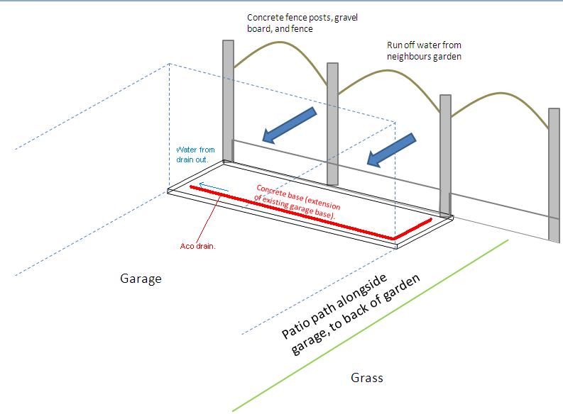

Hi
I recently found we get a hell of a lot of water run off from the two gardens at the back of our garden - which are about a foot higher than our garden. The main problem comes from a particular section, at the back of my garage, which incidently has an extended concrete base at the back.
What I intend to do is install a storm drain channel (aco drain), but not not sure of its placement i.e. closer to the garage, closer to my fence, straight line or an 'L' shape?
Once I get the water problem sorted I intend to make a lean to at the back of the garage covering the extended base where I can store things.
I have attached a drawing.
Any advice on placement, tips etc would be appreciated.
At risk of stating the obvious, place your channel drain at the point where water collects first......a very gentle fall is needed for the drain to go into a water course also, which could determine its position.
