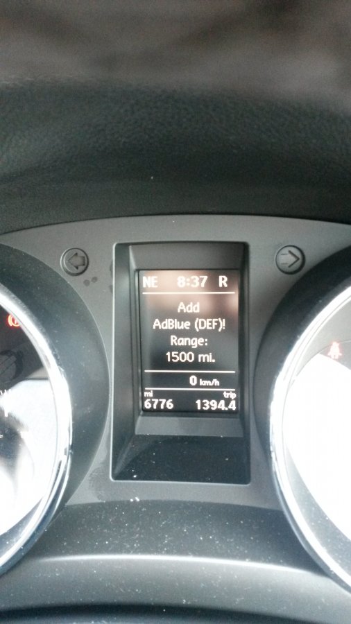

Yes a sporting driving style will drink up adblue its in relation to amount of diesel consumed,if your adblue filler is in a convenient position then a funnel will be ok.
Also have a new yeti and the filler is recessed under the boot floor and to prevent spillage (its corrosive :idea:) i use the shop supplied bottles with the 2 seal anti drip spout.
A dashboard warning will appear to warn when adblue is getting low.
Around town driving also consumes the Adblue with relish - there's no escaping it, and the exhaust temperature has to be above a certain level before it is injected. I can't see how diesels will continue without it, personally - hopefully it will prevent the Diesel engines demise! Goodness knows what Euro 7 has in store for us :eek:

We've got Euro 6b to get through first, before we worry about Euro 7! The biggest chainge is going to come in the next 2 years though. The "Real Driving Emissions" test (where they have to go out on a real road and be able to reproduce (give-or-take a "conformity factor") their "lab" emissions test results), will MASSIVELY increase AdBlue consumption! I think most VAG cars are sized to try and make AdBlue last between services (so about 18,000 miles) but I never got more than about 16,000 out of any of my Sharans before they started asking for some more. The Sharan has a 17 litre tank. I think most cars are in the 15-20 litre range. Industry insiders seem to be suggesting to me that consumption will more or less double in the next few years. However, hopefully petrol stations will start installing AdBlue pumps in the next few years, so you don't have to mess about with bottles and funnels.
...unless the manufacturer has put the filler neck in a stupid, inaccessible place like on the Sharan....
And some cars, (my Missus ex-Mazda 3) had the tank hidden away and could alegedly only be topped up at a garage because the ECU also needed to be told the talk was now re-filled. It's all hidden away and doesn't seem to be user servicable, shame.
