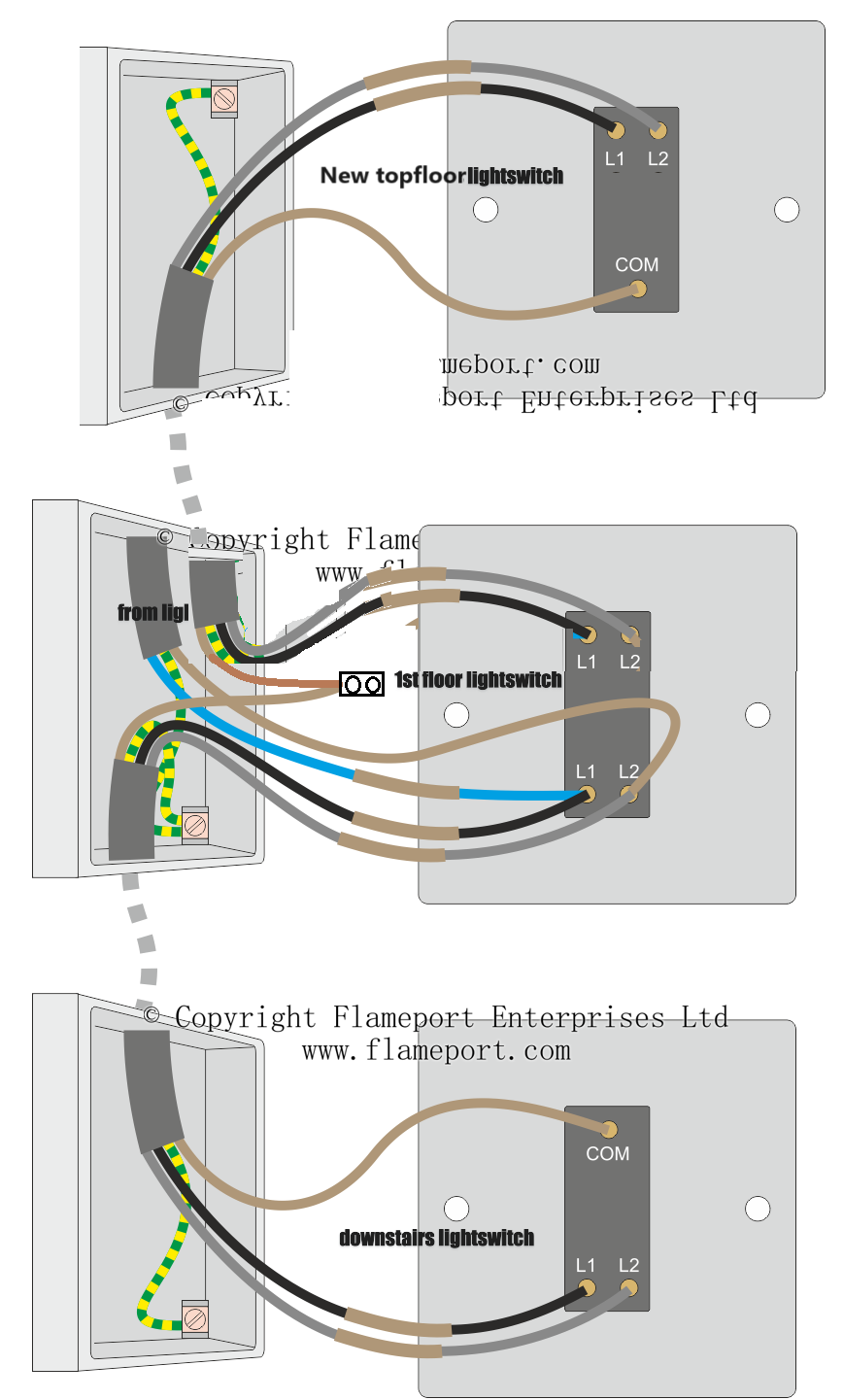

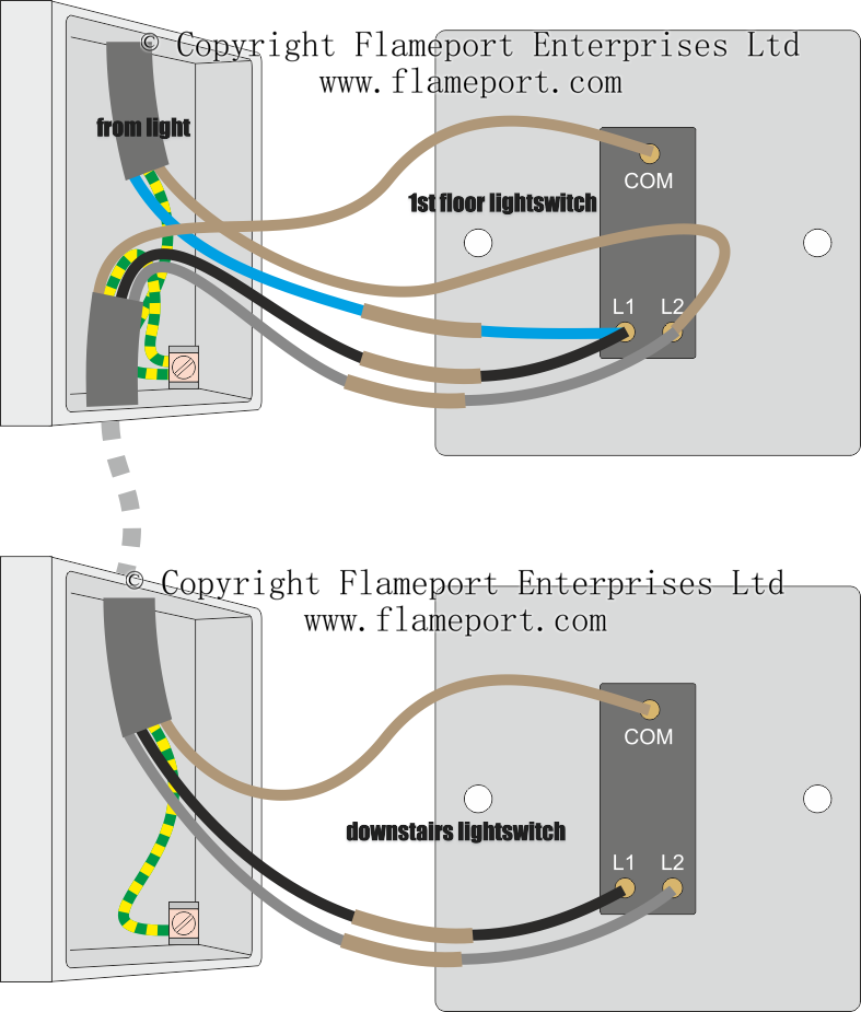

Hi all, currently in the middle of a loft conversion.
I would like to control the switch on the floor below (1sr floor) from the loft.
This switch has the switched live from the light fitting and a 3 core and earth to floor below (ground floor) for 2 way switching.
Can i replace the switch on the 1st floor with an intermediate switch even though it has the connection to the light fitting?
The current wiring is identical to the wiring in the attached picture.

Yes, run a 3 core and earth from the first floor switch to the new switch
Feed joined onto brown to first common, strappers as normal then the brown back from the 2nd common joined to the switch wire, make sense? :unsure: :confused:
I'll draw it out if I get chance
Very very simple to change the existing upstairs switch with an intermediate, add a connector block, 3core and earth cable to the additional location and 2 way switch. Eccuse the mess and my apologies to flameport for altering your drawing:View attachment 385203

Don't be confused I think we're saying the same thing.
I thought (but not long or hard) I'd done the same as you hence the reason I edited my reply to yours:unsure:
No I was saying take the switched live and live out of the intermediate and connector block it with the connector blocked brown, but your way is better.
Thanks everyone for your responses, the diagram is very useful, many thanks.
