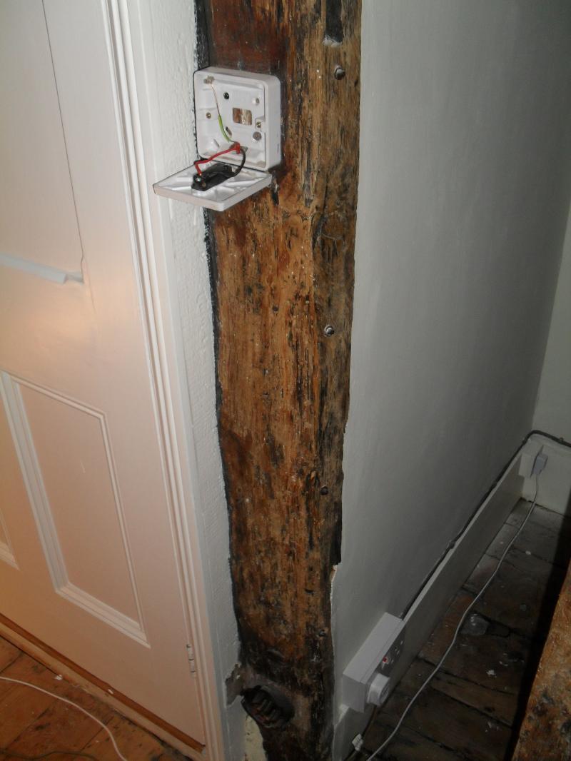

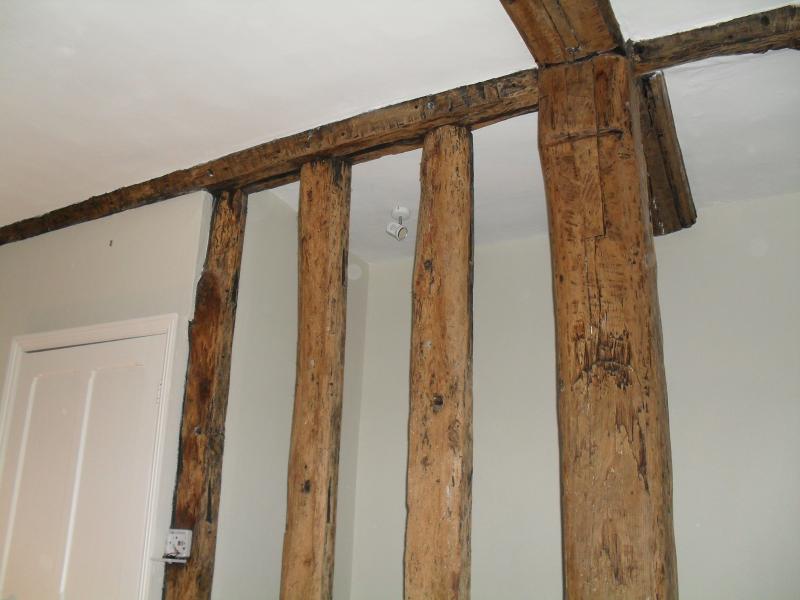

Firstly below shows the area of the room. You will see the existing switch on the left which lights the single spotlight you can see on the ceiling behind the beams:
This picture also shows the extra junction box below the switch:

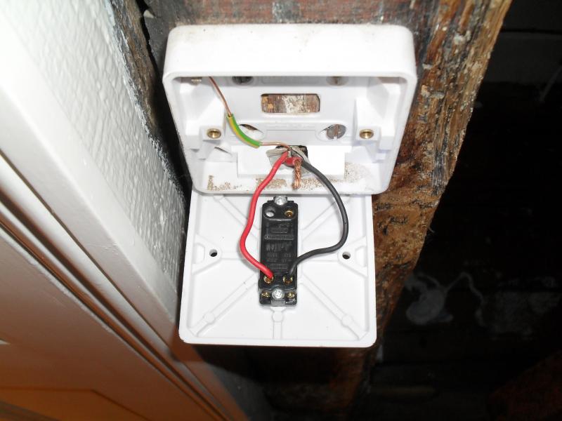

Here is how the switch is currently wired (the loose wire you see in the image was connected to the top right terminal but I had to remove for picture as quite short):
Here is a better view of markings on back:

The new lights will be 12v wire lights (Paulmann Salt Wire) which will be on this side of the beams but with the transformer tucked behind the far right beam on my first picture.

By the look of the switch plate you have a live looped in to the switch, which would/could mean that the neutral is looped within the ceiling void as you require both these conductors plus the earth you will need to to a little more investigation. Firstly I would check the existing light fitting and see if there are two black neutral conductors at the fitting.
If there is only one neutral, then the chances are that you have junction boxes in the ceiling void, unless this the last light of that circuit, so further investigation at a second fitting would give us more conclusive evidence.
But you would require to take a neutral to the new fitting from either the light or the junction box if accessible. The live can be linked across from the one at the switch plate to a second gang, then for a two way function you would require a 3 core and earth (strapper) to be terminated between the second gang of switch(for new light) to the location of the second switch to offer the two way function.

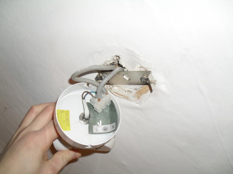

I checked the existing light fitting and only find two grey wires going to the light as below:
I haven't yet been able to check the ceiling void for a further neutral / junction box.
Would I be able to take the neutral then from one of these grey wires (other than live)? i.e. without finding further cables in the ceiling.

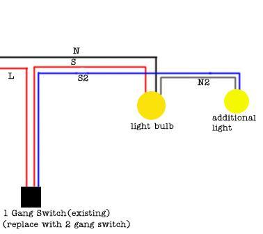

So am I right in saying that the new light should be wired like this:

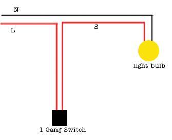

from this?:
Iggifer's picture looked far more complicated than this. Obviously I am not taking into account the earth.
Not sure on where I pick up the live from in the existing switch being 2 way.
Also what kind of wire would I then require? presumably I technically just need a single core with earth to take live and earth from the switch to the new light and then a single core from the old light to new light for the neutral? I also have a feeling that the new light just needs live and neutral to the transformer without earth so then I could just use a single core all round (although imagine it would be good practice to have earth wired anyway for possible light changes in the future?)
Apologies for all the questions - still alot I am trying to learn in all aspects of DIY since recently got my first house.
Many thanks
from this?:
That would do the job.
It's likely that one of the reds is permanently live at this switch.
The best way to find out which, would be by testing for voltage on a two way function I would expect L1 to be perm live but you need to verify this.

It looks like you don't have a cpc to that spotlight. It's Class I and needs an earth connection.
If you're changing it, does the new fitting require a cpc?
Good point. Yes I am changing the existing light with a new fitting which does require a CPC. As there is earth in the light switch, am I to think this is from the supply and that at worst (if I can't find an earth in the ceiling voide) then I can just run an earth off of the existing earth in the switch to the old fitting?
No, you can't just assume that because it looks like an earth wire (or cpc - circuit protective conductor, to give it its proper name) it actually is one.
Before you rely on it as a potential life-saver it should be tested.

Going back to getting the live from the existing switch, where should I take this from? Black isnt always live (depending on second the other switch in the circuit)
You have a permanent live there - use a (proper 2-pole) voltage detector to identify it.
