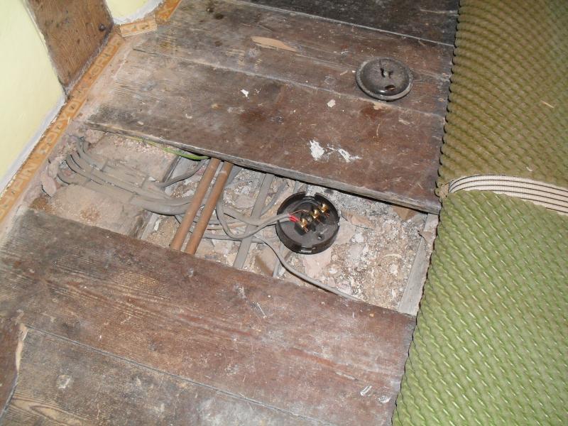

Managed to find a junction box when lifting the floorboards as below:

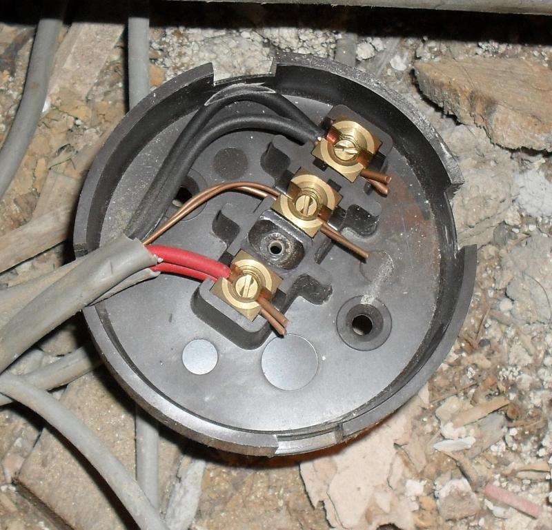

Closer pic of wires:
The red appears to we permanent live, not sure about black and looks like there is earth.
The two thinner wires at the bottom of the picture go to the old light fitting but neither are coming from this junction box- one heads in the direction of the switch and the other possibly going to fuse box (fuse box is in adjacent room below)
Is it likely that this junction box is for the lighting? If it is then I can take the earth presumably. Is there any way I could also use the live?

I'm struggling to understand what's going on - you have a switch with a permanent live already there, you want to make it a 2 gang, and therefore will need to have a permanent live going to each gang, but you don't want to use the existing one for both gangs, you want to pick a new one up from a junction box and run 2 to the switch?
Also, as I said, you should not just assume that the earths are continuous.

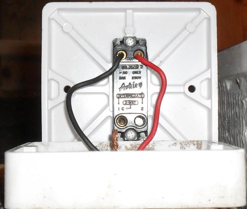

Going back to the orginal switch (remembering it is 2 way with second switch in hallway. Also remembering I do not want the new additional light to be 2 way) below is how it was wired:
The black is initially live and 2 reds not live. When the second switch is pressed, the black is no longer live but instead the top right red is live. The other red is never live. What should I be using as permanent live to loop over to the second gang in the switch??

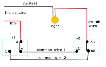

Ok I am going to make some assumptions. I think the original 2 way lights are wired as followed:
I am going to assume that the switch in my lounge (from where I am trying to add an additional light on a seperate switch) is S2 in the diagram and S1 is the other switch in my hall meaning I don't technically have a permanent live in for the new light.
Is there a way I can still wire this using what I have already there? Or am I going to have to find another source of power? What are my options?
You shouldn't wire things up on the basis of assumptions, but it seems highly likely (apart from the cable between the 2 switches being red & black).
Nothing "technical" about it - you don't have one.
No.
You need to find a permanent live from the lighting circuit.
Options include replacing the twin & earth between the switches with 3C+E to take a permanent live to S2, taking the live from the main loop, or just taking the loop to the new light and running a conventional drop cable to the new switch.
I'm not convinced that any of the JBs you've shown are on the lighting circuit.

Cables on the left of the picture go to the fusebox itself so I would think there must be a permanent live there somewhere for the lighting circuit. I am going to see if I can find one. There is a perm live within the junction box under the floorboards however I think this is for the sockets (on a different fuse). At very worst (Want to avoid) I presume I could use this with a fused spur. I have already put the 2c+E in to the switch so don't want to change this but will have one wire free anyway as neutral is coming from the ceiling void seperately from the original light. I will therefore use the free wire to take the perm live down to the switch. Can you see any issues with this?
Was just going to say that those wires in the JB look a bit big for the lighting circuit.
I have 3 cables under floorboards which could potentially be lighting from fusebox - two 1.5mm cables and one 1mm. Is there a way I can know without having to guess / cut in to them?? they all come from fuesbox and head in same direction where I cannot follow.
