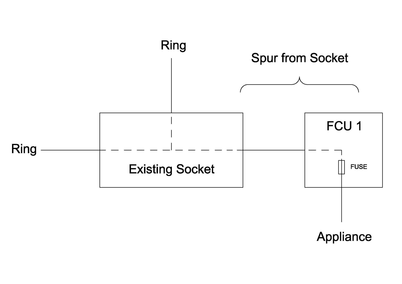

I will have one last go at explaining. Sorry if my English isn't understandable, which is a bit worrying as my main employment these days is as a technical author. :whistle:
Anyway, this is what the op has now. One spur from a socket on a ring [in the absence of other info assumed to be from a 32A MCB as is usual]

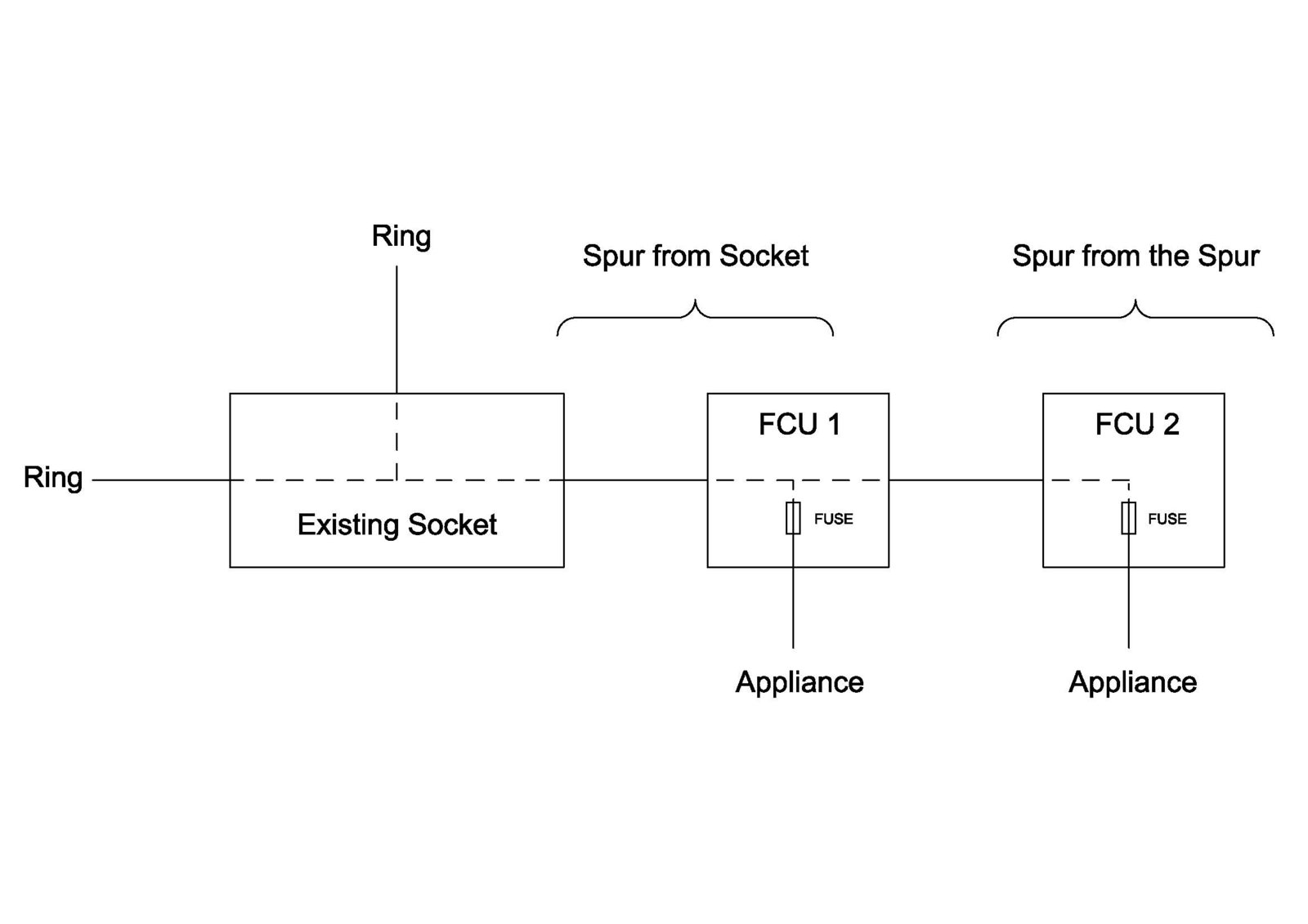

But he can't add another second spur to the existing spur.
I think we all agreed on that in the first place!:LOL: The only part we were correcting was to state that you can indeed spur twice off the same socket on the ring.
Hopefully the OP has finished his project by now(y)
1) He might be able to, depending on spur cable size and installation method.
2) He wasn't asking about doing that:
I've got a double socket near the back door. I've already added a fused spur to it to feed and outdoor socket. Can I add another to it to run an outside light?
He wants to add a 2nd spur to the double socket near the back door.

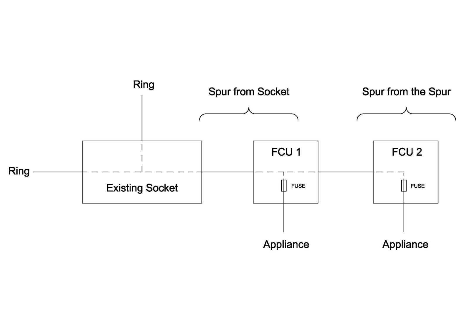

To put a spanner in the works, I think everyone would agree with that because they just do, BUT
even if there were 13A fuses in both of the FCUs, that would be no different than a double socket - assuming the first bit of cable complies, which it probably would because some people believe it must be 2.5mm² connected to the ring.
.... BUT ... even if there were 13A fuses in both of the FCUs, that would be no different than a double socket - assuming the first bit of cable complies, which it probably would because some people believe it must be 2.5mm² connected to the ring.
Indeed - but, of course, the same is true of two single sockets (no different from two FCUs).
Kind Regards, John
Yes, but the regulations don't say you can only have one FCU - as there aren't double ones.
True - but, as you know, nor do the regulations (as opposed to 'informative guidance') say that one can only have one single socket.
