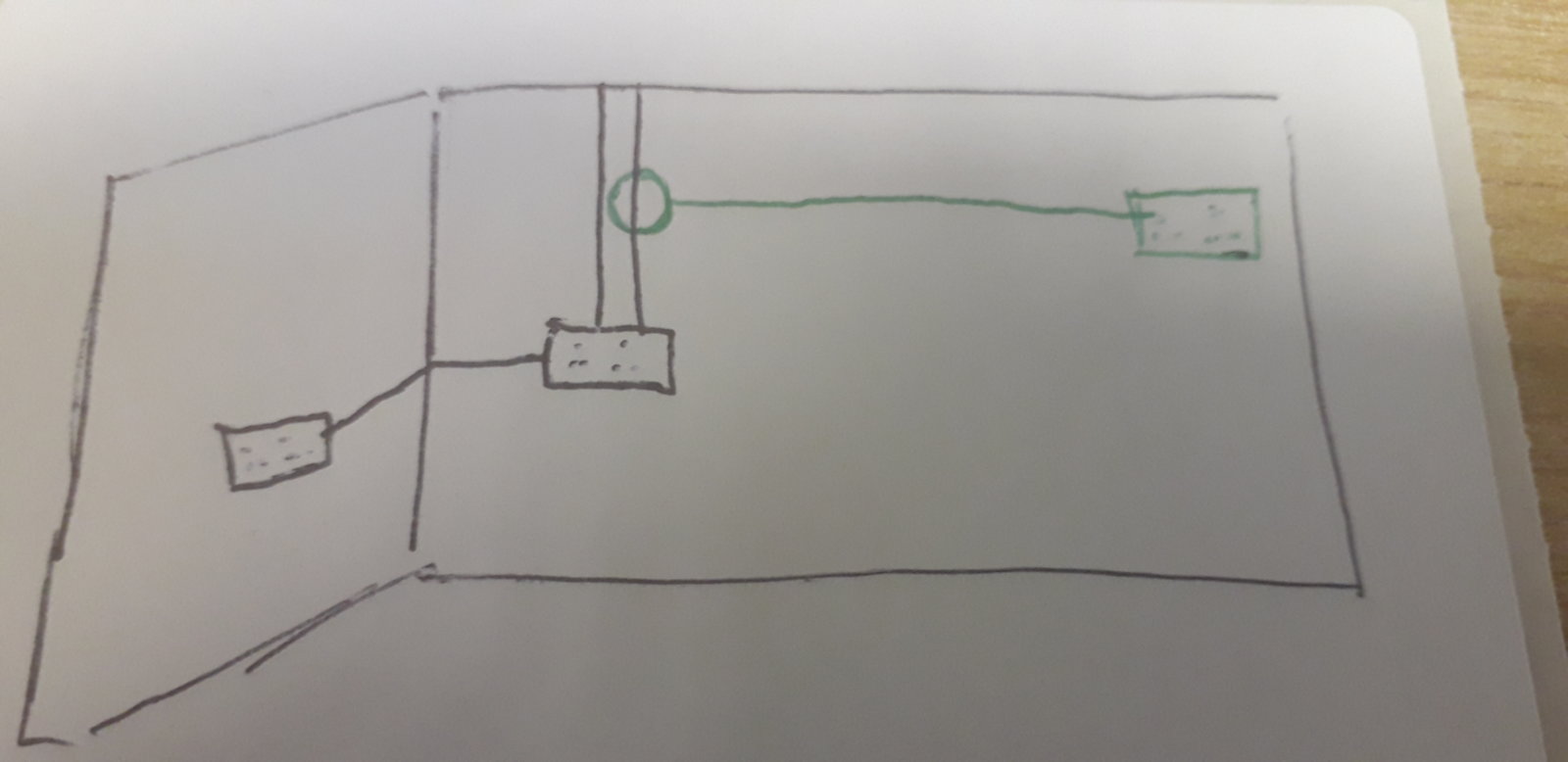

I have a double socket on a ring that already has a double socket spurred off it in my garage (to the left of ring). All cables surface mounted on to the block wall.
I would like to add a fused switched spur (to the right) that feeds another socket for some plug in low wattage lighting LEDs.
1. Is this allowed as i would be fusing down to 5a? ie two spurs from same socket, new one fused?
2. If not, can i just add another double socket directly above the original ring socket and thus extend the ring slightly, then spur from that?. Then each double socket on the ring could have one spur each?

There is no rule saying you can't have two spurs from the same point. But you may have a problem getting four cables into one socket.
Wouldn't it be better to take a single spur from the socket on the ring to an accessible junction box. From that junction you would have a feed to the existing socket and a new feed to the fused connection.
It means having an extra item on the wall but would make dealing with all the cables much easier and save the awful practice of an overcrowded back box.

The socket that is in the garage already, run another 2.5mm² cable from there to the socket which already feeds it in the house. This should be easy, seeing as it's clipped to the block. Connect inside the house socket so that the ring is maintained, Wago 221 are very good for this. Then you can do as you wish and fit an FCU as a spur from the garage socket, or even put the FCU on the ring also(better/easier as you'll only have two wires per terminal, not three anywhere).

A picture speaks a thousand words. What i currently have is in black, what im now thinking the best way to do this is in green (the circle would be a 30a junction box).
Thoughts?
What i was originally going to do is take the green from the ring socket to a fused switch then the new socket, but the junction box seems better?
Aaaaahhhhh, I see. I didn't think the ring was already in the garage, just a single cable from the house. Anyway...
You can do that, yes. That joint must remain accessible, i.e. you can't go plasterboarding the garage in future and the joint gets covered.
I thought you wanted an FCU to act as a switch for the LED lights? If so, it's better to re-route one leg of the ring, as far as it will reach...
(new cables in green)
...and keep it on the ring also. Depends where you want the switch really. Avoiding unnecessary joints should be a priority IMHO. Or just put the FCU where you were going to have the 30A junction box.
