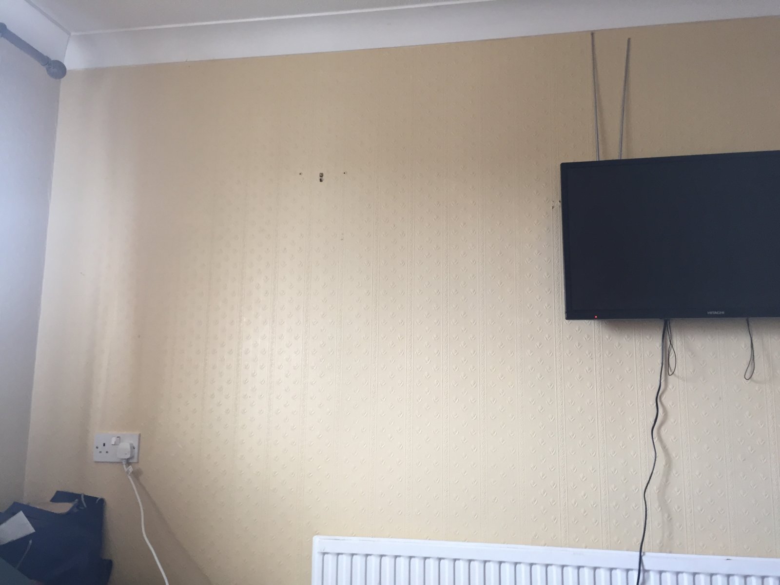

Just put 32” TV on wall. The mains wire isn’t long enough to reach nearest socket, and would look ugly anyway. Temporary fix is connection via adaptor (photos below)
Would you recommend extending from the socket shown, junction box from cable, surface conduit etc.
(The wall is egg box plasterboard. TV is secured by six Gripit fixings. Will also fit radiator cover to mitigate heat problems)
Thanks for your time.

I agree, picture v misleading. Bottom of TV is 1.4m from ground. RU able to offer anything re socket issue?
Have a sparks fit a proper socket behind the TV with the cable buried. Use a double socket for future needs. What are those cables above? Aerial feeds, HDMI perhaps. These need burying as well.
Well, if you don't mind surface trunking, that will do.
Other than that, you will have to bury the cable, with all that that entails - correct routes (vertical or horizontal from accessories etc.)
Can you come down from upstairs?
Much less distance and even a short straight vertical bit of surface conduit won't look TOO bad.

That’s what you get with Wimpey 1981 vintage Yes, TV aerial(definitely TV, but v old) Should have explained that this is a bedroom, so no upstairs etc. The only other socket in this bedroom is low down in the opposite corner. Is the cable likely to connect the two sockets via the wall or under floorboards? Also, if I go with ugly surface conduit, would you direct that horizontally and then vertically to position new socket nearer to TV?
Thanks again.
No, that doesn't have to be horizontal/verical but it will look even worse running in a straight line between socket and tv.
