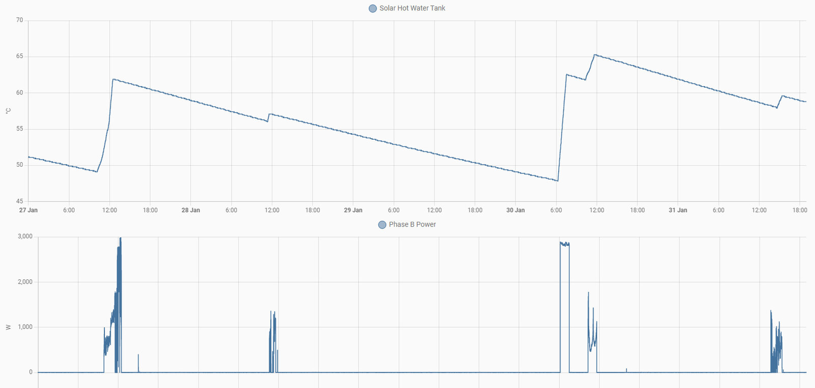

Yep, always interested! I was wondering if it might be worthwhile to add an extra NTC, with a two-way switch, to select the default NTC, or a second one at a higher level - 1/3, 2/3 up from the bottom. I just wasn't sure how well stratification worked with the heating coil at the bottom.

Just an update Harry. I installed the pump a couple of days ago. The pump is installed between the outlet and cold water inlet. I installed a double check valve prior to the pump and one on the cold water feed prior to where the pump tees into the cold water feed if you get my drift [If not I will try to explain better]. The pipe immediately after the the pump gets mad hot when the pump is activated but cools off after a foot. The system pressure is about 3.5bar and I'm not sure as to the "actual" flowrate of the destratification pump under these conditions. I expected a more rapid flow of water but it does work when I check the boiler readout where the sensor is at a similar level to the cold water inlet and the outlet Sonoff sensor. What I have noticed is that the 1 hour I have set the DHW to heat up the 300L cylinder is not enough to heat it up to anywhere near 60C from a 40C baseline. I will make adjustments as required as I do not want legionella in the system.
