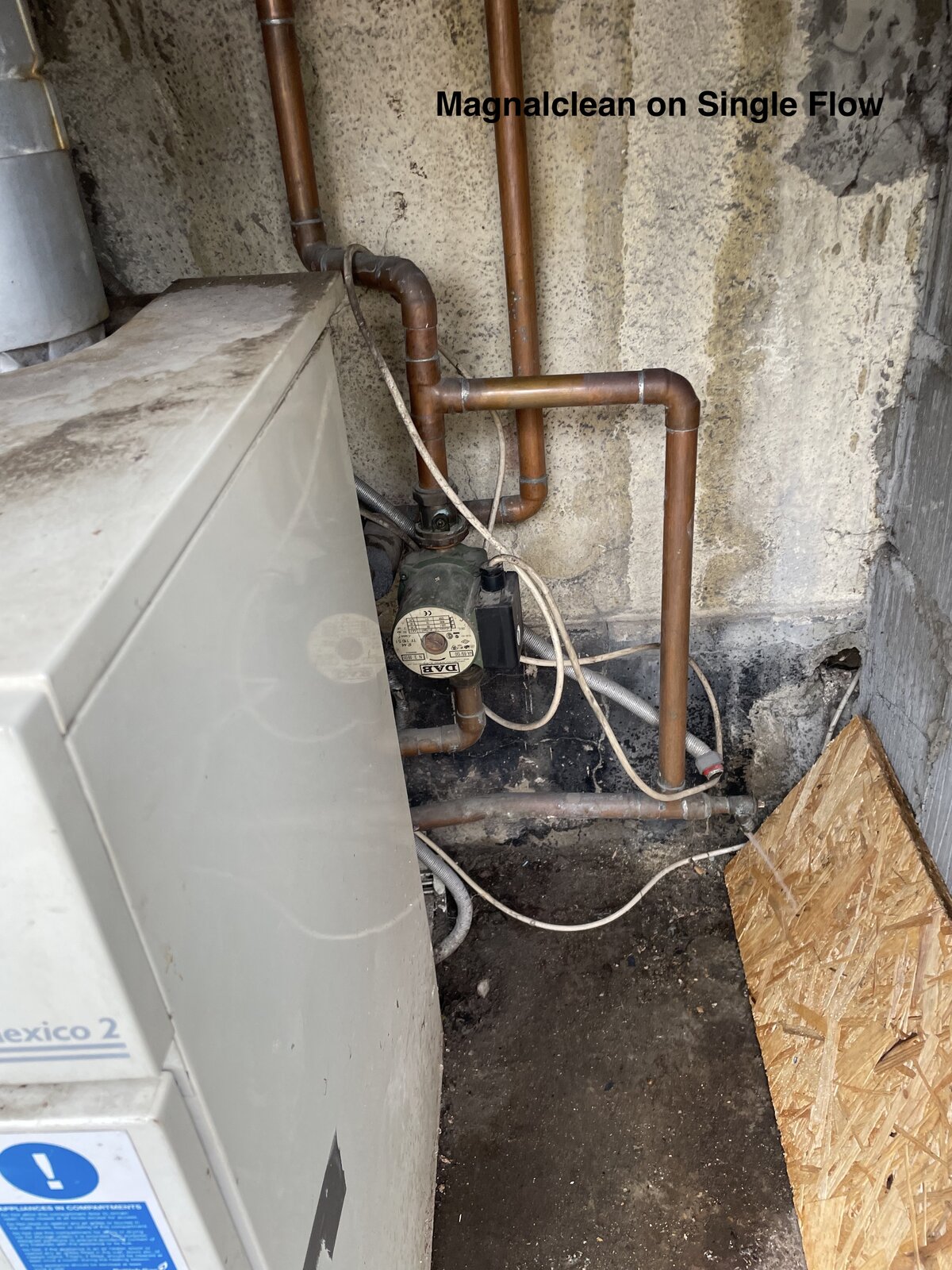

Trying to get some wisdom from the forum elders here as I am doing bits and pieces around the house
I have an old boiler which I cannot afford to replace - It has one pipe from flow up behind some chimney and then two pipes return which are joined just before the green pump
With my June salary I will spend £140 to buy a new pump but for now I have bought a 28mm Magnaclean filter - I can only put it on the flow pipe from my thoughts - If anyone can suggest a better place on the return (which is where it should be) that would be very useful to know
If I put it on the return against the wall this will only cover part of the circut - What would you do - Magnaclean on single flow pipe or on part of the return

Re-pipe it so that the return join is further away from the pump so that you fit the filter in.
They are supposedly fitted to the return to protect the boiler, but no filter catches everything first pass, so especially with an older boiler, it really won't matter on the flow.
If push comes to a shove, I would instal the filter on the radiator return pipe

The system is filthy - Its an old floor standing boiler on one inch steel pipework and I cannot afford to replace the boiler at the moment - It is open vent
There are some circulation issues but each time I drain it for maintenance the water is black and brown
I thought sticking a magcleaner was the cheapest mainteance job I can do to prolong the life of the boiler - Am i mistaken ?

new pump if there's circulation issues, good clean/drain and flush until it runs clean then properly inhibited. A mag filter at this stage may not add any benefit but if you have one then no reason not to fit it I guess.
As suggested, if you have no where else then the downward leg of the return pipework - which at a guess may be the rads with the other lower leg being the HW Cylinder?
Is it a crazy idea to move the pump to the flow and the put the filter at the return.

It could give you a massive headache!
It would alter the hydraulic balance!
