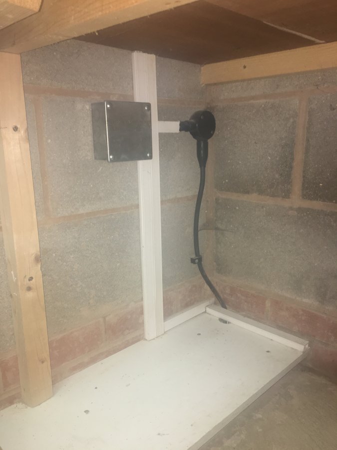

As a starting point I've attached a picture of the point where the power enters the garage.

Can you tell us the size of the MCB suppling the garage 16a or 20a ?
The lighting will be fed via a switch fuse with a 3a fuse fitted.
The alarm should have a back-up battery fitted to prevent it activating when the power is cut.

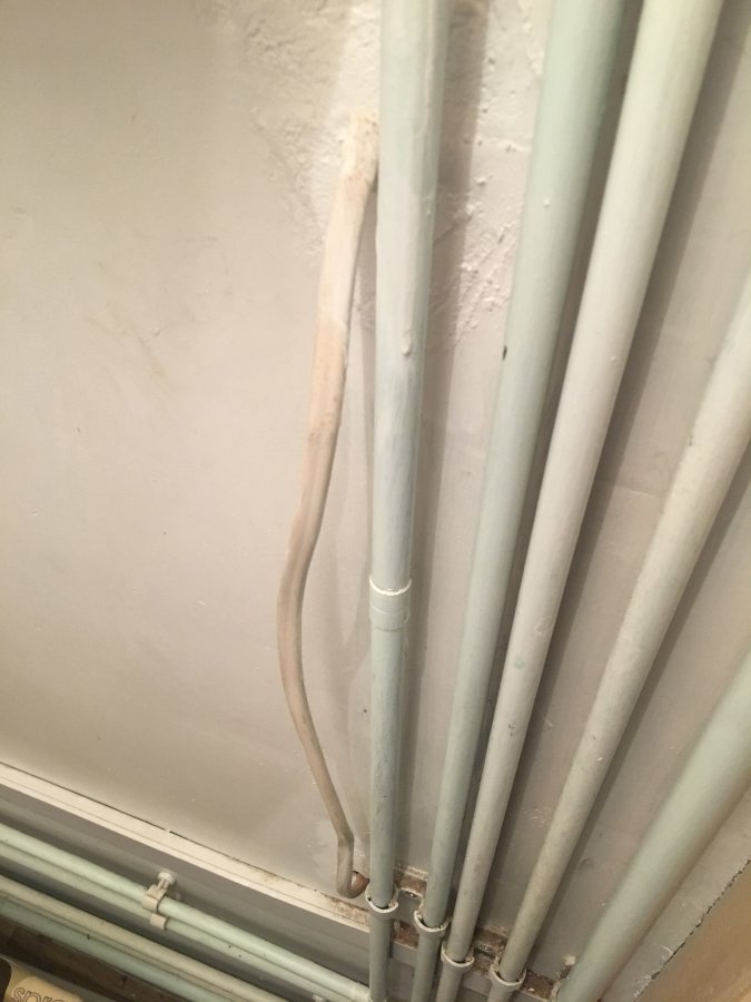

On answering the 16a/20a question, I've just spotted a bit of wiring that someone has done that I would categorise as "non-compliant".

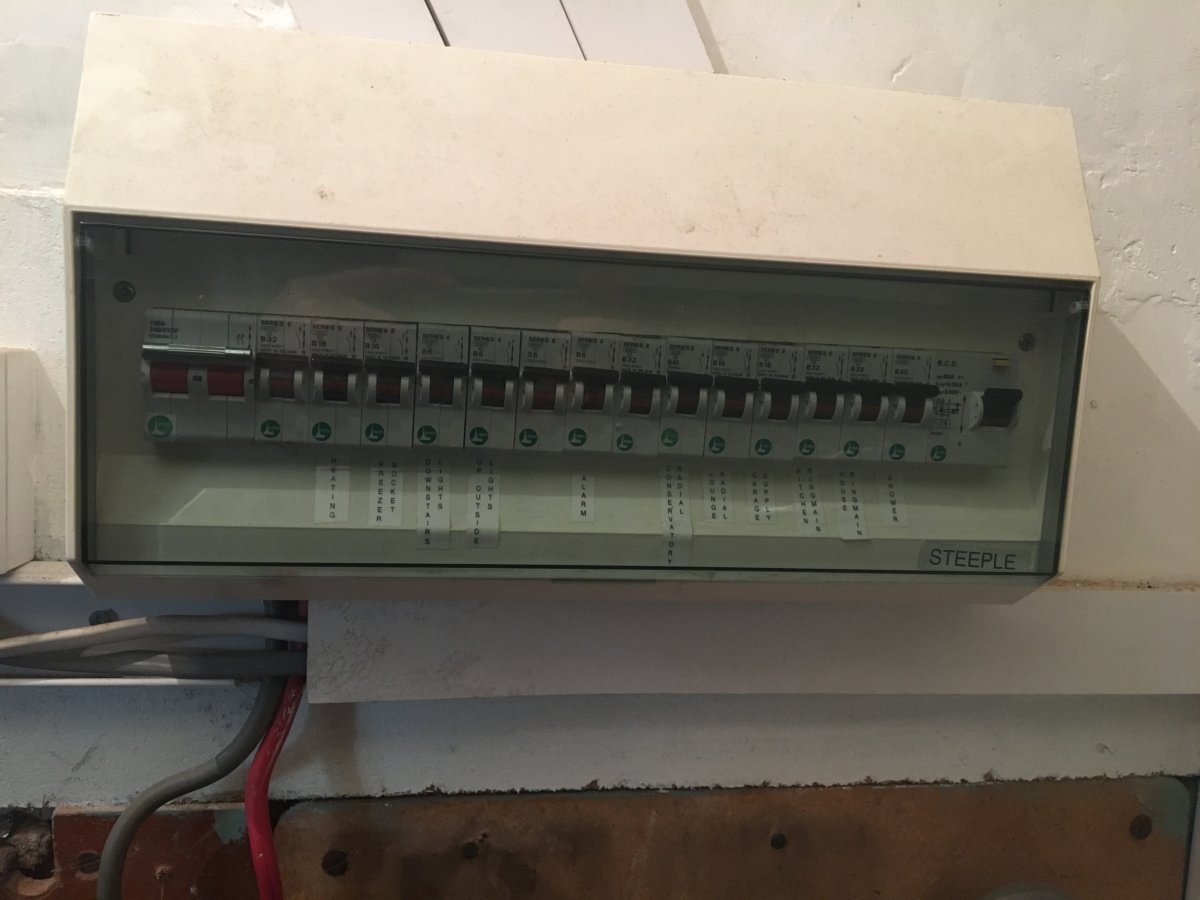

Hi,
3 pictures attached...
1. The consumer unit - the socket that the freezer plugs into has a sticker on it stating that it has RCD - I guess this is the fuse tagged Freezer Socket. I actually have the fridge plugged into it. Ever the rebel.
2. Cabling I spotted yesterday. I guess there must have been a plug socket where the wire appears at the bottom of the picture, that has been rerouted up and through the wall into the kitchen, becoming a double plug that powers the microwave. I'm going to put some conduit over that at least to the interim, stop the toddler pulling it out and shocking Mummy while she loads the washing machine.

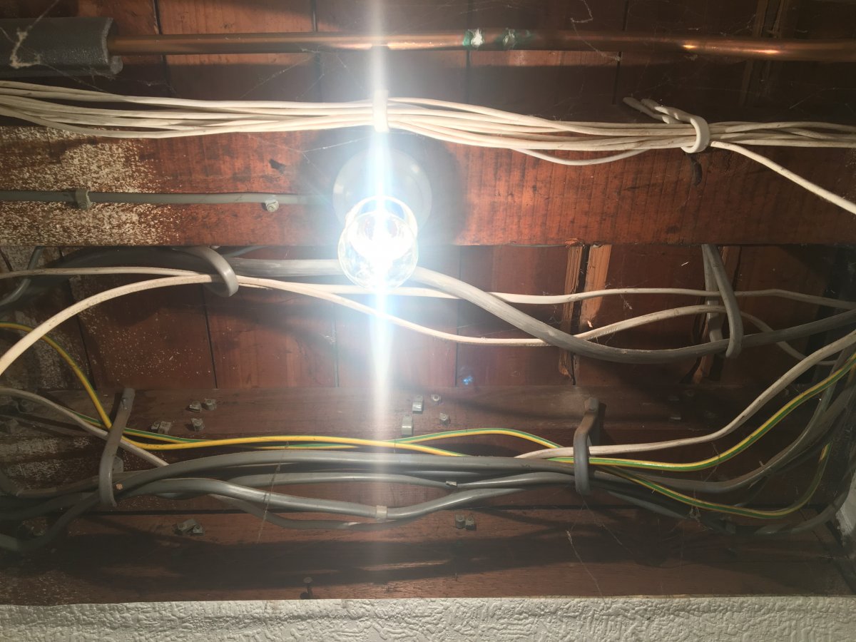

3. Some overhead cabling.

Still does not answer the basic question. Where does the feed to the garage come from?
Is it from one of the MCBs in your picture (none is marked "garage") or does it come from the back of a socket, or fed froma separate FCU somewhere?
Note that not all of the circuits in your house are RCD protected. Probably the MCBs on the right hand side are, and the others are not. Would need to see inside the CU to confirm.
4th one from the right is marked "garage supply" - as far as I know, this is the source.
I suspect that only the freezer is RCD protected at the moment, as someone has gone to the bother of labeling that socket where no others are labeled.
