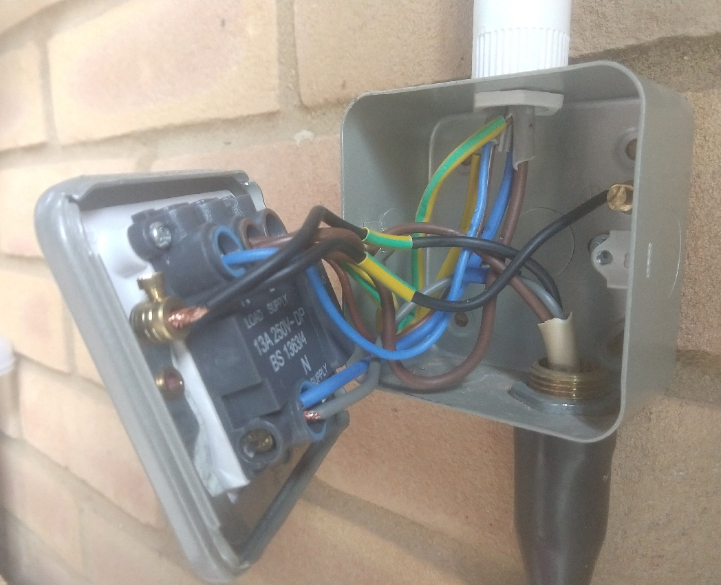

Here's the fused switch that controls the lights.
ae235
That's all there is. The armoured cable is fed in from the bottom and a single trunking comes out of the top. That trunking has two wires: one that feeds the sockets and the other feeds the light bulb.
I want to add a separate fused spur for the outside security light so should I replace this box, or just spur off the sockets cable where it exits the trunking and trails along the side of the joist?
The objective here is neatness, and to make it more intuitive that there is a switch for the internal lights and a fused spur for the outside security light.
Neatness takes second place to safety and correctness.
Do not ‘spur’ from the sockets cable.
Leave the fused switch in place. It limits the current for the lights. You need to wire from the LOAD side of the fused switch to the new lights. Add another (unfused ) switch, if you want to control them separately.
OK, here's a picture of what it looks like now (as installed when new build)
Is there adequate room to run an extra cable into this? And should I tidy up the grey neutral, which is showing some copper?
