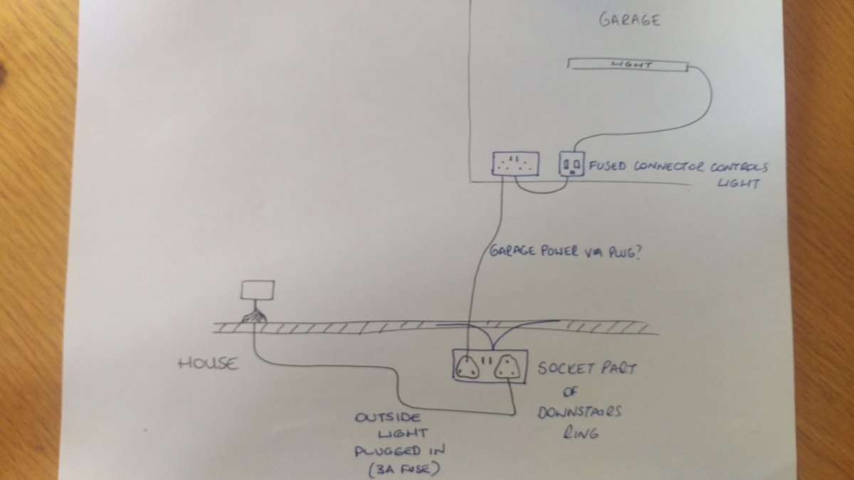

The image below is a layout of the electrics which power the outside lights and garage.
They are both basically plugged into the ground floor ring. With the exception that that garage light is controlled by the switch on a fused spur which is connected to the garage double socket.
Can this be improved using a method which is non notifiable? Or does it need improving?
I was thinking of something like adding a fused connector switch off the socket in the house and then another socket off that to control the garage and outside lighting?
They are both basically plugged into the ground floor ring. With the exception that that garage light is controlled by the switch on a fused spur which is connected to the garage double socket. Can this be improved using a method which is non notifiable?
You would be talking about additions/modifications to the existing (ring) circuit, so that would not be notifiable.
It would certainly be 'neater' to have hard-wiring rather than the plugs/sockets - but if the 13A is adequate for your garage (socket+lights) then there's nothing actually wrong with it. Is the ring circuit protected by an RCD?
As above, it would probably be better/neater to get rid of the plugs/sockets completely, and just use fused connection units. Some people would not like taking two FCUs from the same socket (and it might be difficult getting four conductors into the terminals) - but, if your outside light is modest in power, you might run that, as well as the garage, off a single 13A FCU from the socket (with a separate switch for the outside light).

What protection does the external cable to the garage have and how is it routed?
Is there RCD protection anywhere on the circuit?
We don't know from the description exactly how the existing wiring was done. It may be T&E buried directly, passed through the wall and crammed into a 13A plug, which I've seen done many times. It may be flex threaded through a piece of buried garden hose or some similar abomination. Some more details and/or photos of the existing wiring would help to give an idea as to whether what's there could just be improved upon or whether it should be ripped out and a fresh start made.
