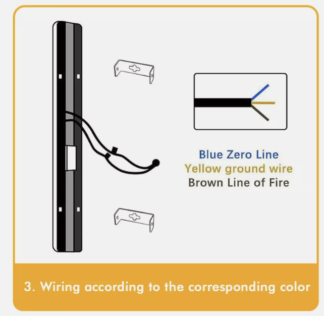

I am building a seating area with a roof at the bottom of my garden.
I plan to install 10 long vertical lights on the wall in that area.
But I would like to switch them on from the house, possibly via Wifi or a remote control.
These lights do not come with that capability.
Is there anything I can buy and connect that will allow me to turn the lights on/off from the house?
Apparently, the lights only come with a basic wire. See attachment.

I would need to run cables from every light switch to this controller (not the switch).
You would run the mains cable from the house to the controller.
If controller is at one enbd ofthe lights then you would (typically) have one wire from the controller to the first light.
And then one wire from the first light to the second light.
And so on to the last light.
BUT....
That light you are showing looks worringly bad (eg 'Brown line of fire' I presume means 'Live'). And I am wondering if it is outside rated?
How are you joining the cables that are outside to ensure no water ingression?
Are you considering means to reduce chnages of electruction (cable type, RCD on consumer unit (fuse box) etc?
