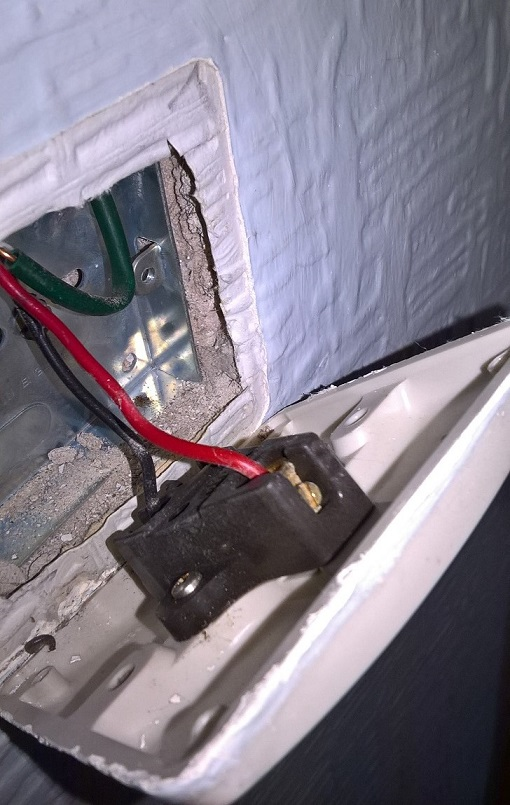

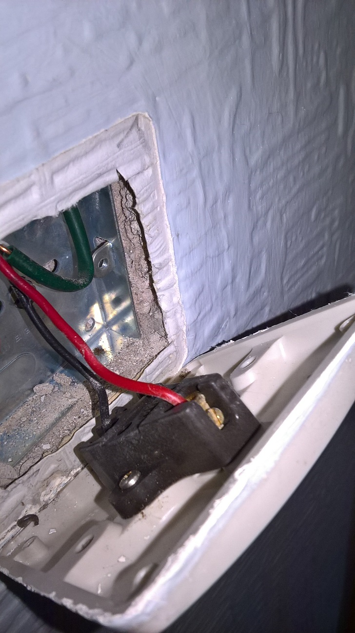

I knew you'd want pictures! Right, here is a pic of the light switch (we turned the leccy off first of course):
We can't get up on a ladder today to check the ceiling light but based on this I'd say we have "loop in" ceiling rose wiring, would that be right?
And... would the black cable shown here, be switched live rather than neutral?
We’d need to see the wiring at the Rose. It may be loop in there, but there is another option that was used in older houses. That used a big junction box, hidden somewhere. You may need access up there.
And yes, the black is switched live.

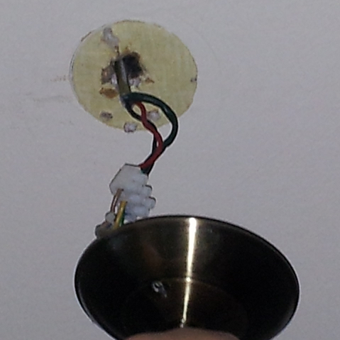

Apologies for taking so long to get back on this thread, loft access above the room in question has proved more difficult than expected so my husband hasn't been able to get up there.
We have managed to get a photo of the wiring at the light fitting itself:
Does this help clarify things? :confused:
1 grey cable coming out of the ceiling ?
There is either a small junction box in the ceiling, or the octopus design. (large central junction)
No, I would make a guess at a joint box having been used, rather than a loop in system - judging by the red, black and the dark green earth sleaving plus the older style switch. If there is no loop in at the ceiling rose, then you need to track down the location of that joint box.
