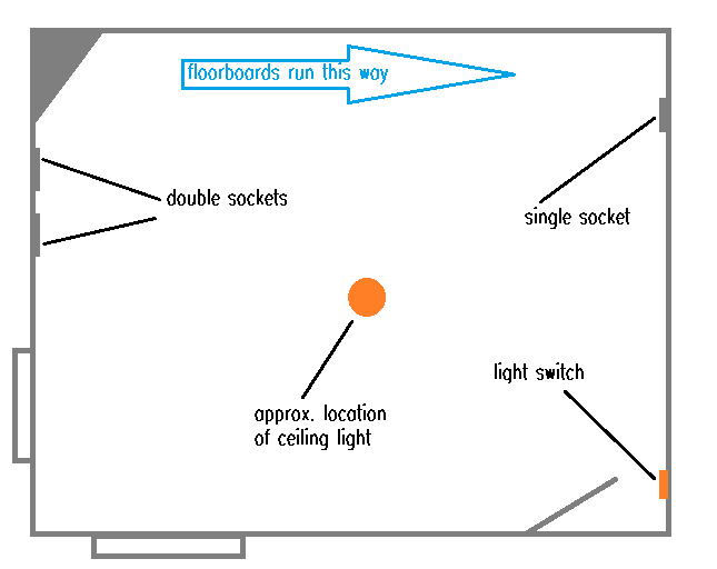

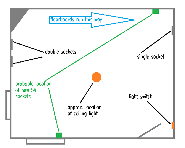

Sorry, forgot to address that from your last post. The idea would be to have one (new) switch (beside the existing switch) operating all the 5A sockets, leaving the existing switch to operate the ceiling light. We haven't decided exactly where the new sockets would go but there would likely be two of them, at opposite (pretty much) sides of the room.
Here's a quick diagram 'looking down' onto the room, if it helps (showing off my MS Paint skills :D):
Yup, gotcha. (I love trips to Screwfix for things like this).
I'd prefer to do the join behind the fuse if possible.

Your issue with running 5A sockets from the lighting wiring is that you will need to take wiring to the first 5A socket in the chain the following
1. A switched live
2. A neutral
3. An earth
To do this you would need a cable from the light switch (to provide 1 and 3)
And
A separate cable from the existing light to provide 2 (and 3).
Your lighting arrangement involves a junction box hidden somewhere, this doesn’t make easy additions of extra switches or lights.
