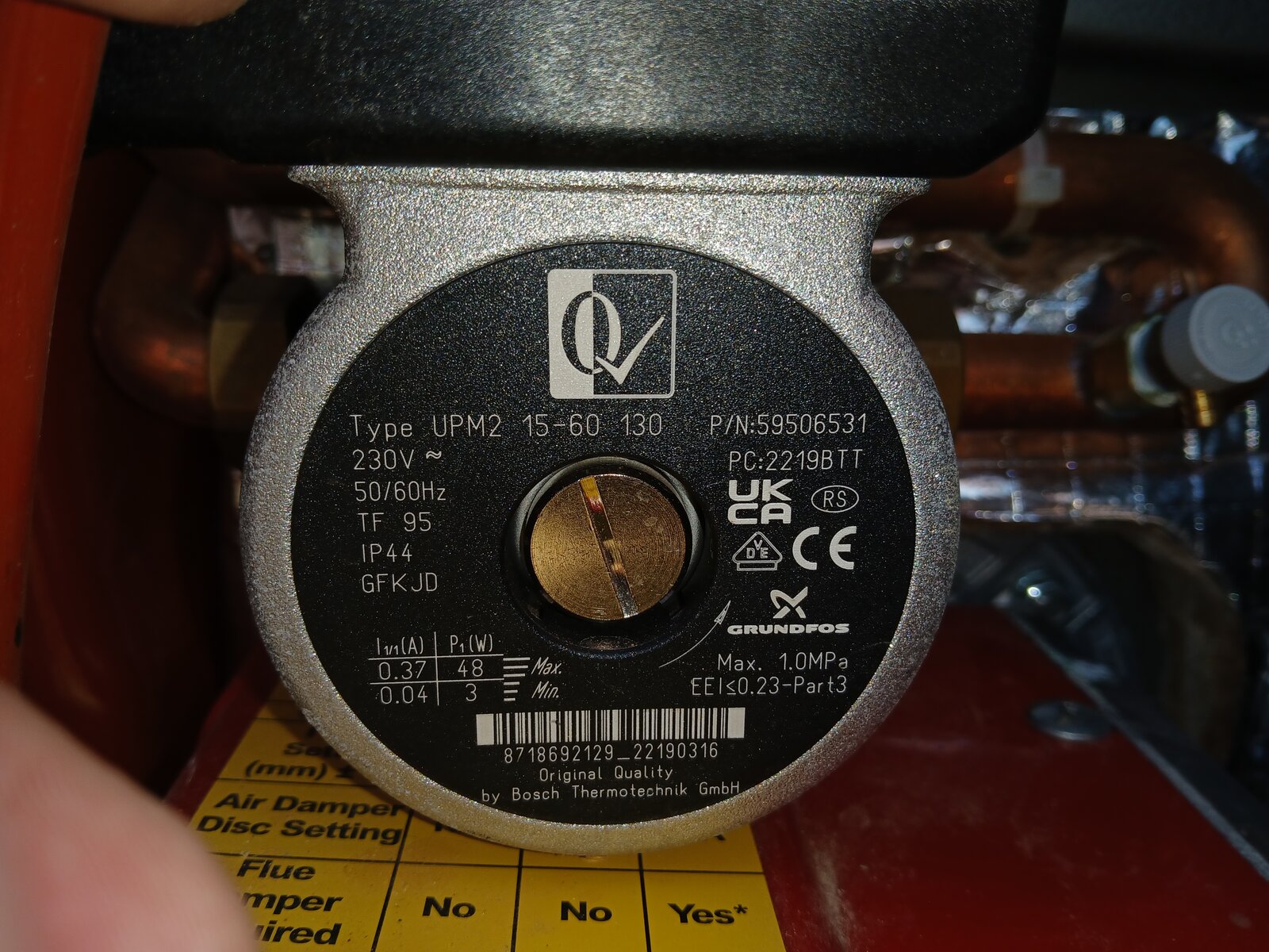

What is the make and exact model number of the existing pump?. Is the pipework 1mm copper?
Thank you for your response, please see image of current pump in boiler.
I assume you mean 15mm copper? I would have thought so but cannot confirm what is in walls or under floors.
Yes, meant 15mm copper which has a ID of 13.6mm as against 12.0mm for " plastic," so more than likely copper otherwise your 6M existing pump would only circulate ~ 10LPM.
A LLH (low loss header) can be very beneficial with a gas fired boiler as its heat exchanger loss alone can be up to 3.5/4M at 15 to 20LPM, leaving only ~ 2 to 2.5M for system circulation but a oil fired boiler's heat exchanger loss is tiny so a LLH is of little or no great benefit from that point of view, IMO. Not sure about a booster pump or its location but if you were to replace the UPM2 6M pump, ~ 5.5M @ 16LPM with a UPS2 8M pump then, because it will pump up to 54LPM at 8M, the flow rate should increase by ~ 21%, this may be sufficient?. A 6M booster pump, on the other hand should increase the flow rate by ~ 40%, theoretically.

I've read that all right re pumps fighting each other but not sure why they should as there must/should be some equilibrium final head point, the UPS3 isn't a bad choice IMO but do seem to suffer from more than their fair share of premature failures.

I had a look at the pump curves, the UPM3 (on its own) might be circulating ~ 16.7LPM at 5.6M, if a UPS3 is installed as the second pump then I reckon that the flowrate might increase to ~ 22LPM with a UPM2 head of 4.62M & a UPS3 head of 5.62M, total, 10.22M, even if a UPS2 8M pump is installed as the second pump then a flowrate of ~ 25LPM with a UPM2 head of 4.39M & a UPS2 head of 8.0M, total 12.39M, apparently not a lot to be gained by installing a 8M pump but if a LLH has to be installed for whatever reason then the UPS3 is useless.
