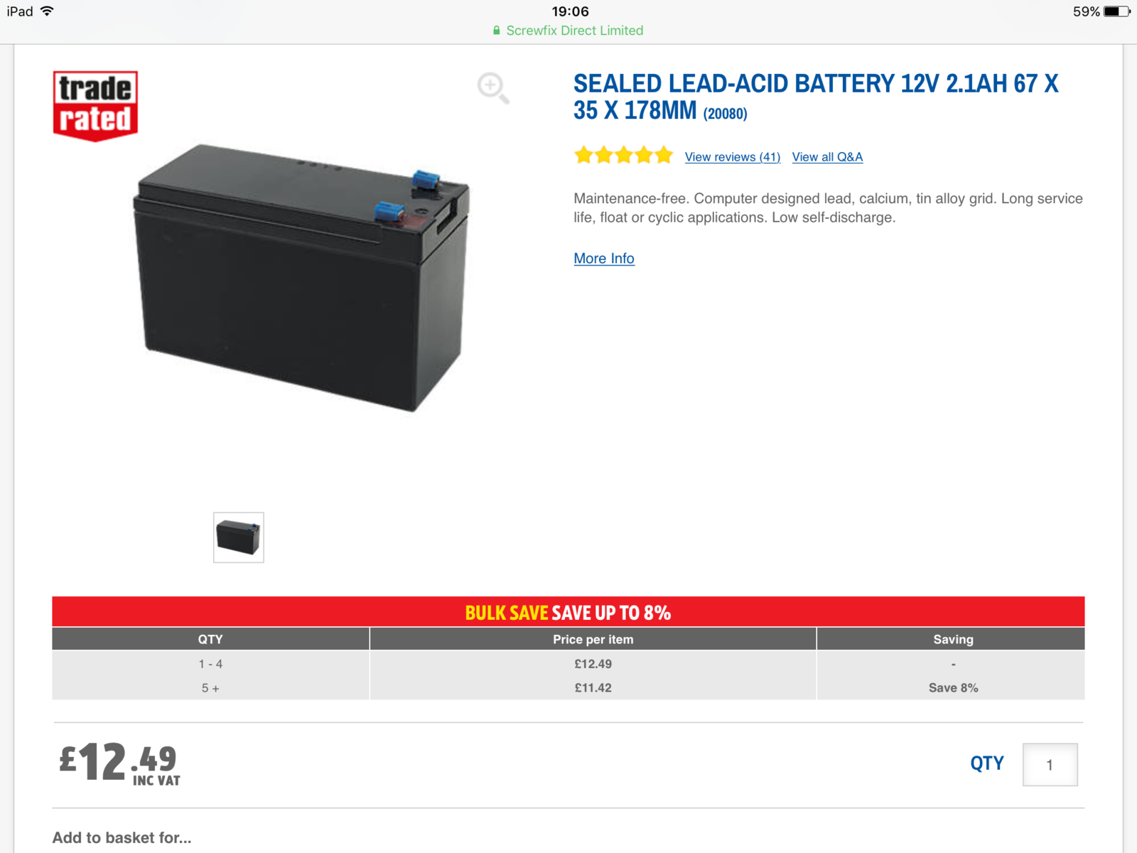

I presume I can buy one and install it without making any wiring changes from what you can see in the pic?
I just laughed as soon as I opened it, God knows why they never fitted a battery.
I will have a look for one and get it fitted. Is it just, mains power off, connect the two cables to the battery terminals and power back on and good to go?
IMG_1629.PNG This battery ( if you need one quick ) otherwise a yuasa or powersonic
Don't go on the picture ....the physical size is correct
Thanks mate, I will look to order a powersonic or yuasa online the same size as that screwfix one.
