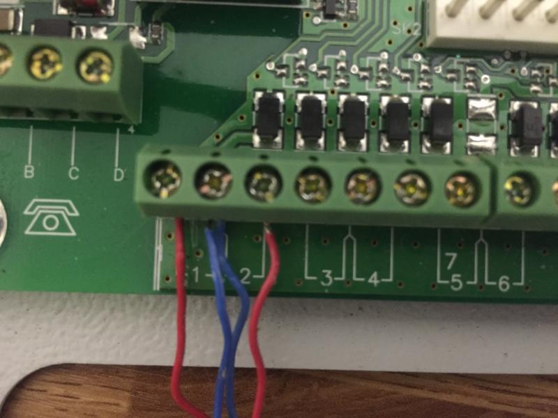

Hi Guys, I have the above alarm and wanted to know if you could help let me know how to wire in the magnet contacts to the board?
I have the magnets, they have 3 wires out of each
Red = Switch
Blue = tamper
Black = common
which wires go to what?
i have just two magnets to play with for now
What magnets are they ? Either buy pre resistored 1k 1k contacts or twist two 1k resistors together one leg under the contact screw with your wire, the twisted pair under the other contact screw , and the the other leg with your other wire under any of the brass on contact screws, the other end of the cable wires into zone 1

so black is not used?
Don't look like it , get a multimeter across red and blue , it will be 2k open 1k closed with magnet at side of contact
Why did you buy grade 3 contacts ? As the 16+ won't support them
i didnt know what to buy lol, i seen galaxy so i had those
ok so just using red and blue, i have 2 magnets so 4 wires
but there are only 3 holes, does that mean the blue share a hole?
you can see what i mean on my 1st pic
2 zones 1 common so yes , most panels use this to save space ,don't matter what the colours are .

ok had a play, and yes looks like that part is now working
I wired the two magnets in like this
which is now using slots 1 and 2 which appears to be correct
