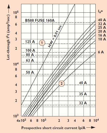

You probably need to look in the documentation for graphs (or tables) of I²t for various fault currents, such as this one (rather confusing!) for Wylex MCBs ...

You don't. You get the I²t value for the device you are using.
Quite so.
In most circumstances, I²t is a single value, representing the amount of energy that can pass when a fault occurs.
Although many people seem to call I²t "let-through energy", as I'm sure you understand, it is not a measurement of (or have the dimensions of) any sort of energy - which would be I²Rt. Some just call it "let-through", which is probably less confusing (less wrong!)_.
Indeed, assuming the current is constant during the fault, the energy delivered to any given item in the fault path is I²Rt
but r varies between different items in the fault path. Also in the case of cables we care more about the energy per unit length than the actual energy. If a cable is the same size, but twice as long it takes twice as much energy to destroy and has twice the resistance.
For fuses this all works out nicely, the goal is to ensure the fuse element is destroyed before the cable is destroyed and both are energy-driven phenomena. So the fuse maker can specify a single "i²t" value which will be maintained over a wide range of fault currents.
For MCBs, it's less nice, it takes time for the breaker contacts to open. So the let energy tends to increase with the fault current.
You don't.
Do not consider it as separate things, or what the units of it may or may not be.
