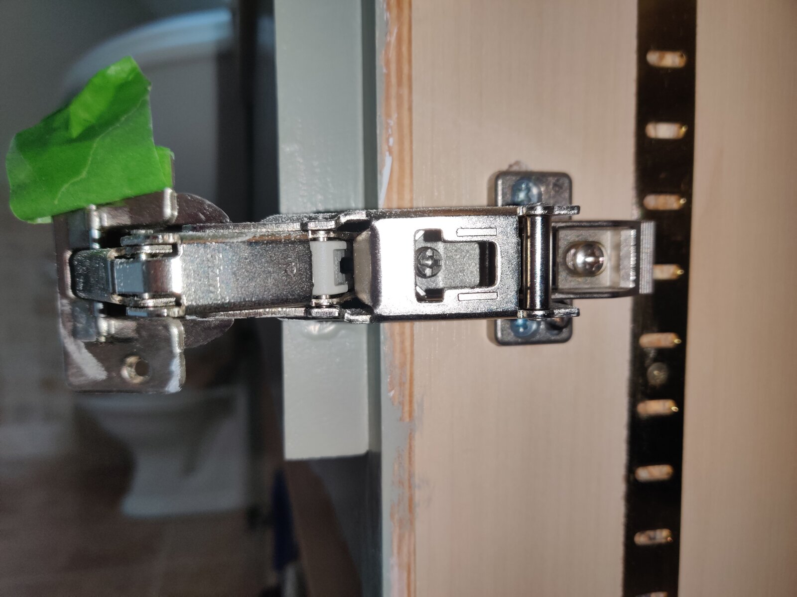

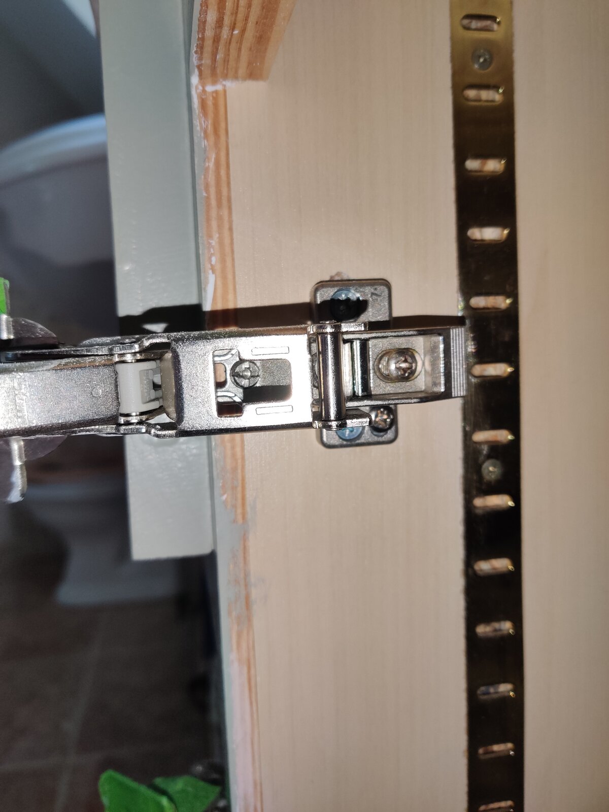

I have some 'Blum' type hinges into chipboard type cabinets, so the screws became unstable and have been reseated in 'bicarbonate of soda and superglue' cement (my new favourite hack!). I have repainted the doors and need to now rehang them. Can anyone direct me to a good explanation of the three adjustment screws show here, and what impact they will have on the movement/ positioning of the doors?
Thanks for any advice.

Bottom screw adjusts vertical movement ( up/down) screw above that horizontal movement (in/out) screw to left allow toe/ heeling of door (twisting)
