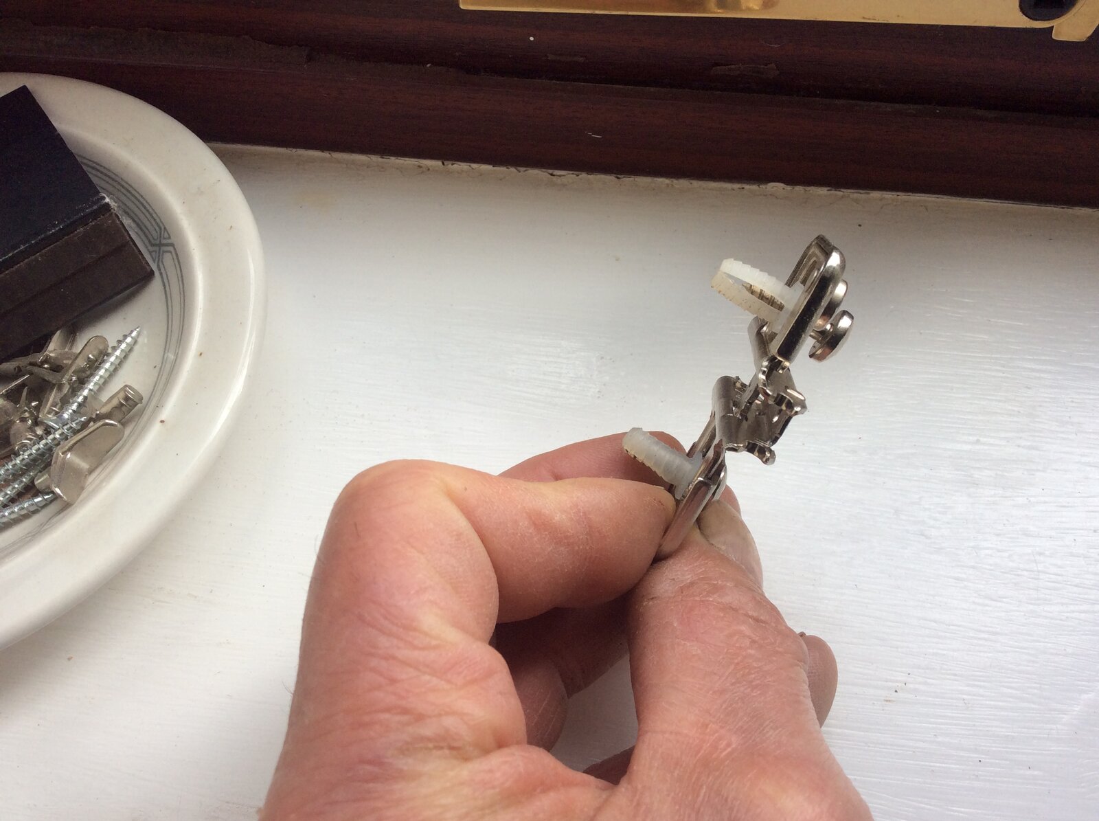

I once had some blum hinges that didn't use euro screws, instead theres a plastic plug that inserts into the wood and a self tapper screws into that
This is a blum, I knew I had some:)
