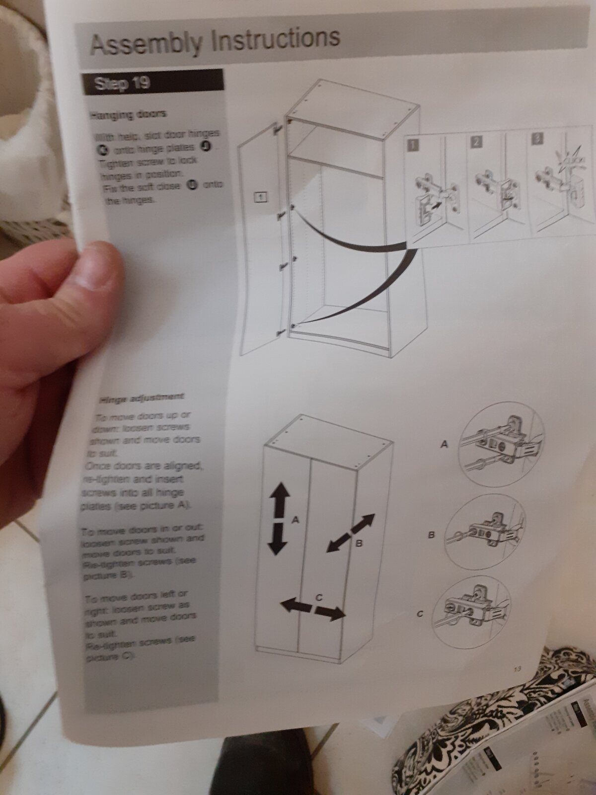

Regarding adjusting door with Euro hinge is it- 1) height (so top of door is level with top of frame 2) left or right position 3) something else? In that order?
(A) Up - down: Loosen only the two screws on the top hinge, pull the door up or push down as required. Retighten. Loosen thevsane to screws on the bottom hinge. Adjust the hinge. Retighten. Repeat as required.
(B) In - out: Adjust as required to get an even gap between the back of the door and the carcass. The door should open and close without binding against the carcass
(C) Left - right: Adjust to get the doors so that the tops of the doors line through (if there are multiple carcasses in a row, e.g kitchen cabinets, double wardrobe doors etc), or to get the top edge of the door to align to the top of the carcass. Re-adjust, as needed, to make the vertical door gapping (I.e the gapping between doors on multi door installations) the same. In kitchens and wardrobes I aim for a 3mm gap to start with and adjust further from there, as needs be

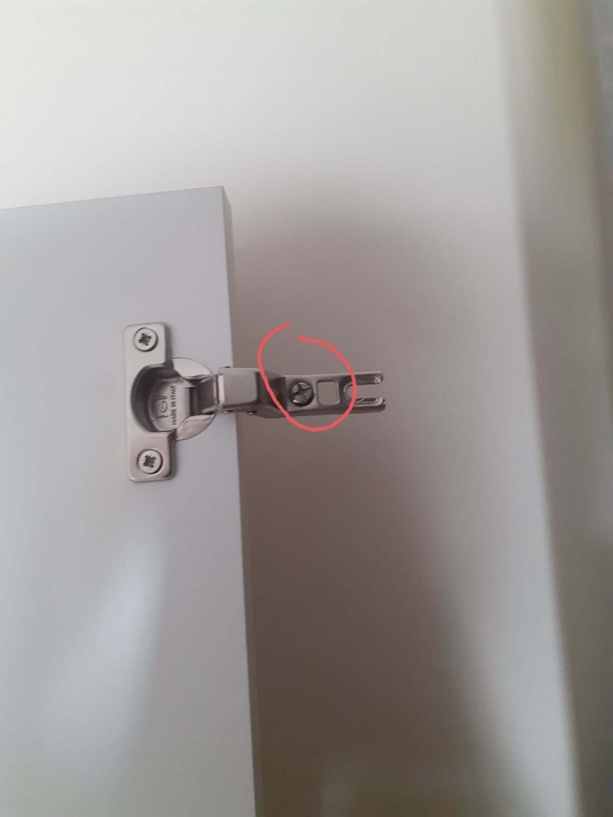

Is it important to screw this screw in as far as possible first before hooking/pushing it in place on the carcass?
No it will make fitting more difficult.
Surely, if it's not hooked in the door will be held too far out? Once in then unscrew. I came to this conclusion as it was hooking in when not screwed out much
