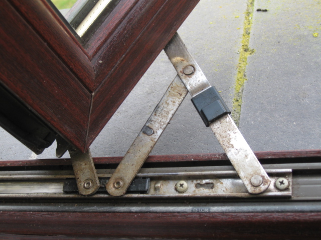

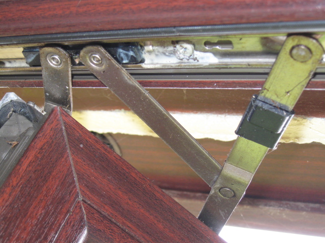

W have John Carr doors in windows in wood-appearance upvc. They are approx 7 years old.
Adjusting the dors is relatively obvious via the hinges but I cannot find any way of adjusting the windows. I need to pull the opening window section in tighter to the frame to stop a draught.
Is there someting I'm not seeing please?

Can't see any obvious wear in the "scissor" type hinges top and bottom
If it helps at all this is a bathroom window measuring about 1000 high 550 wide. It is hinged to and bottom on the right (lookin from inside).
The gap is on the left hand top corner. Not huge but enough to cause a draught when the wind is in the right quarter.
its impossable to see the wear on the scissor hinges,they just seem to stop functioning correctly,mine has done it twice in a few years in the same corner,new friction hinges cured it each time,we have to pull the window at an angle cos of where the bath is and i attribute this to the problem.no other windows in the house have the same problem.
when the hinge is worn the top corner doesnt locate in the frame properly when you close it leaving a slight gap for a draught on our window.

I would have said 8 times out of 10 assuming the draft is just on the hinge side of the window then a good dollop of Vasaline in the corner tabs of the hinges, Then open and close the window about 10 times will usually solve the problem.
After 10 years yours might be a bit too worn out for that trick now.
Actually if they are those really big odd hinges they might not event have the corner tabs? A pic would help jog my memory
Thanx for all the interest
Hope these suffice
Ricky
Nothing special about them, They are just standard friction hinges.
Try my trick with the Vasaline lube (give the hinges a good clean first).
If they are too far gone for that post back and someone can talk you through ordering and fitting new ones
