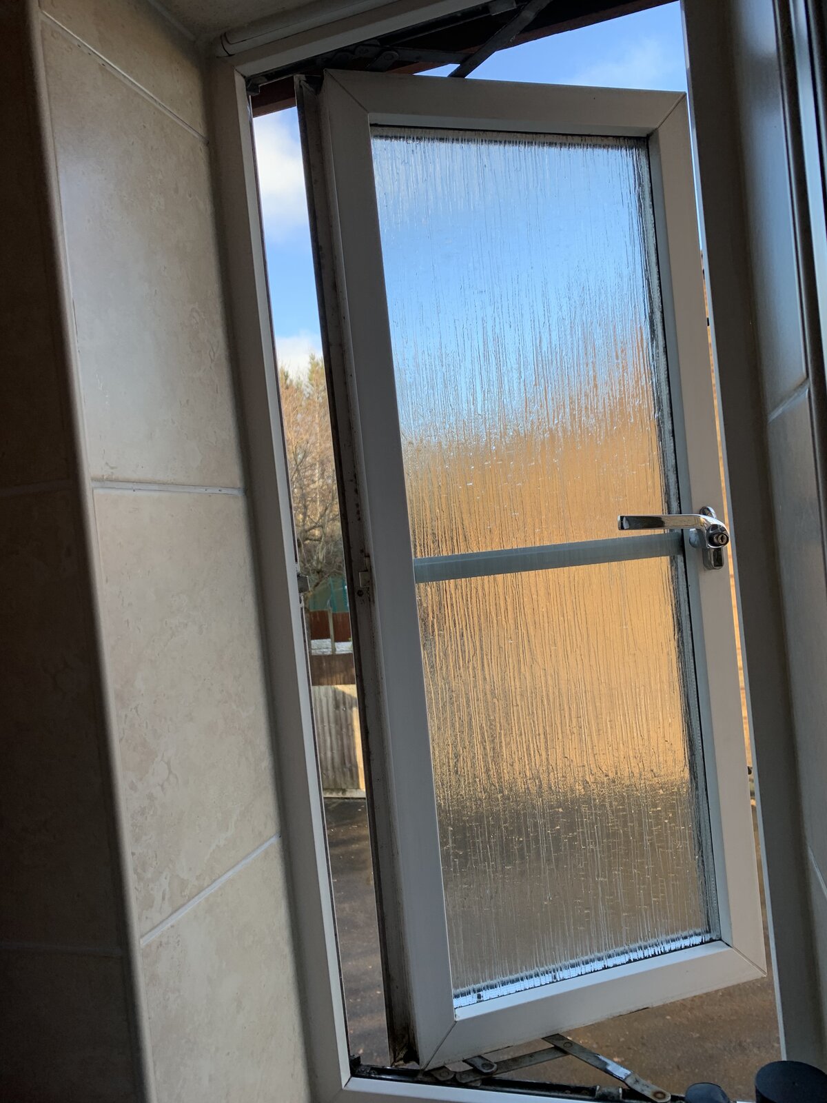

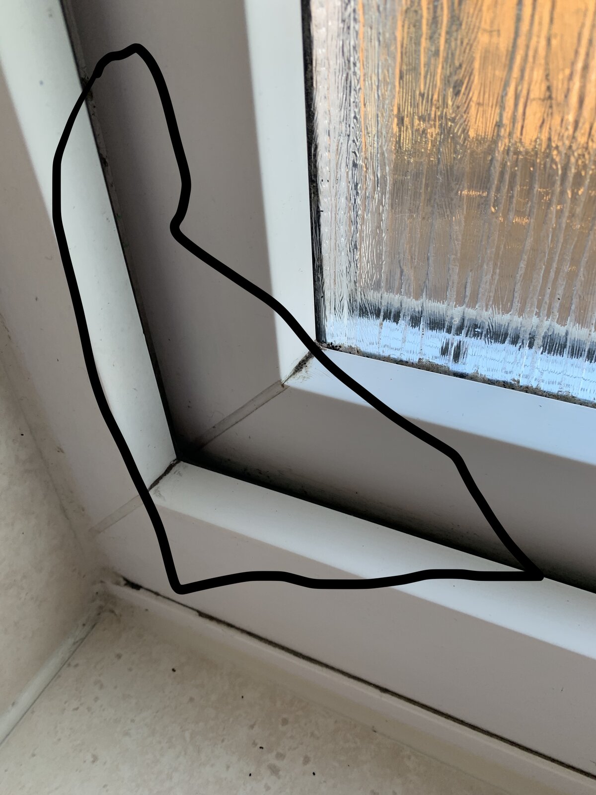

Hi, sons window has a 5mm gap in the corner of the window frame , can I adjust the window to close the gap. pictures attached, thanks and Merry Christmas.

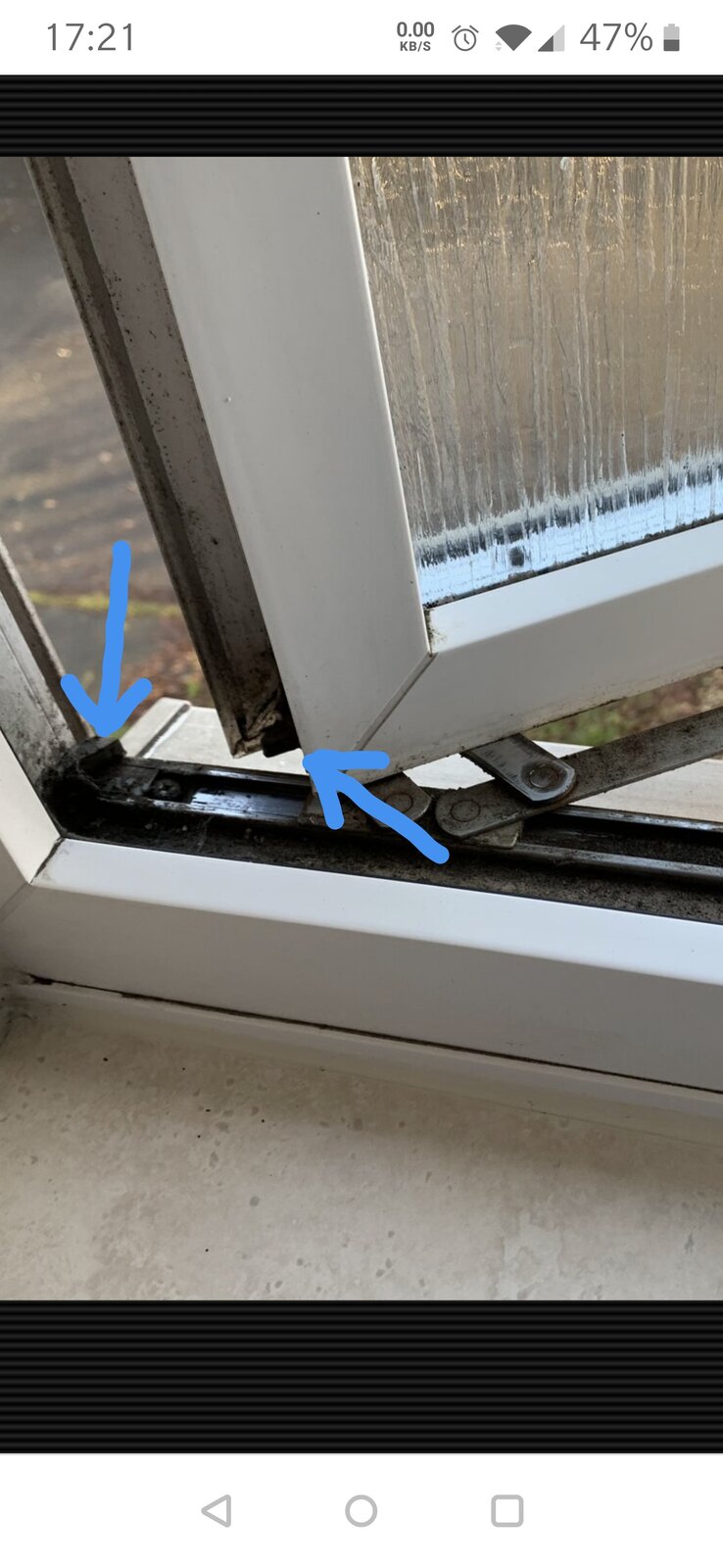

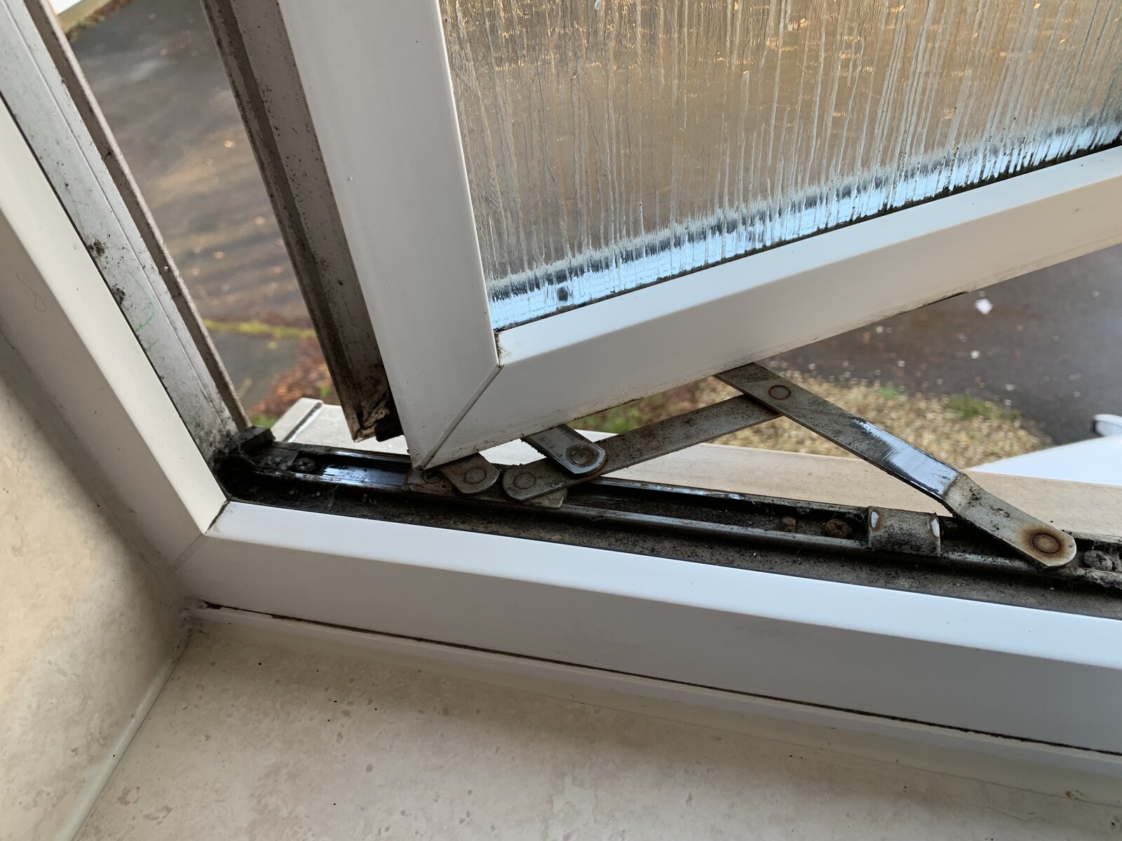

Worn hinge unfortunately, see pic, the point should locate on the cup when closed and keeps the hinge side tight on the gasket, as it wears the point sometimes rides on the outside of the cup and leaves this gap
3 window hinges changed and windows now seal correctly thanks to Crank39 and your tube :)
Hi,
Can I ask how you were able to find the right hinge for your window and where you got them from please?
We got ours from Screwfix about £6 each , just measured the length and matched them, some of the screwholes in different places but no issues
