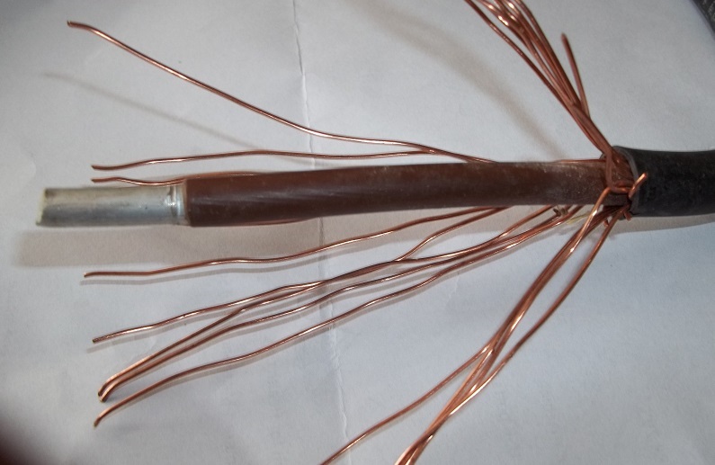

I thought the use of swa cable was to prevent this sort of thing.
Service cables are not always SWA
This is an off-cut from the new service cable to my cottage laid in 2011 , it crosses under a driveway, it is in a duct.
Copper Neutral, Aluminium Live.
and no armouring.
