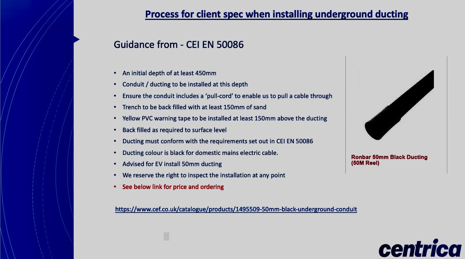

It can be buried straight into the Ground though requires Warning tape above it. You could put them into a Duct if you wished. 16 inches or more would be a good depth
https://www.tlc-direct.co.uk/Main_Index/Necessities_Index/Electric_Cable_Below_Tape/index.html
Can I just run an SWA along the back of the house and have the builder bury it? Or do I need to put it in some form of conduit etc?
If it (or, come to that, the present cable) is simply 'buried under the extension' by your builder, without being in any duct, if it ever needed to be replaced in the future your extension would presumably have to be 'semi-destroyed' to do that, wouldn't it?

If it were me, I would either pay the builder to dig a new trench that you bury trunking in (or he can do it all) or if the labourer was up for it, get him to do it in his own time.
Thanks for the responses. Much appreciated. I'll have a look at ducting - I didn't even think of that. I'm sure the builder wouldn't mind putting it in some ducting and then laying the tape above it as he fills it in.
I'll also look into whether it can get added to the drawings or something to mark out where it is?
